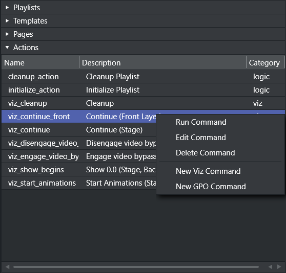

To define secondary event actions
Click Actions
Predefined commands are displayed:
Right-click one of the actions and select New Viz Command or New GPO Command
In the dialog box enter:
Description is the descriptive term that is seen in the Actions list, as well as any drop-down list in the Rules and GPI settings panels.
Command is the actual command line sent.
Name is a pre-generated name based on type selected (for example
viz_newcommand) that need to be verified as unique and may be changed into something more descriptive. Name is the value used for scheduling (as “page name”’).
Click OK.
