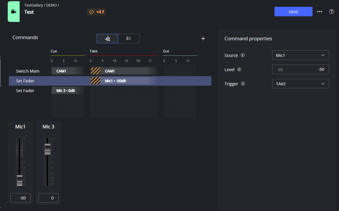

Set Fader
The Set Fader command is used to adjust the audio level of a specific source at a defined point in the template timeline.
Command properties
  • Source: The audio input to be controlled (e.g., Mic1, Mic2, etc.) as configured on the Viz Mosart server in AV Automation in the menu
    Devices > A/V Setup > Audio Config.
  • Level: The target audio level in decibels (dB). The fader scale runs from +10 dB at the top down to -90 dB at the bottom, where the level reads as minus infinity. A newly added Set Fader command starts at 0 dB.
  • Trigger: Defines when the fader level should be applied: on CUE or TAKE.
Info: The Mix Delay setting (defined at the template level) applies to the Set Fader command only if the command is executed on TAKE.
