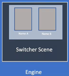

With Viz Mosart in Engine Switcher mode, you can create an IP-based workflow which eliminates hardware studio switcher/mixers. In this mode:
  • Viz Engine performs the function of a switcher/mixer, switching IP inputs and all rendering of DVE effects (box effects, butterflies, picture in picture, etc.) and full screen/overlay graphics.
  • Engine Switcher works under exclusive control of Viz Mosart, but is not an integrated single unit. In Engine Switcher mode, Viz Engine and Viz Mosart run in their own environments.
    Viz Mosart templates can then control a broad scope of traditional and unique switcher features.
  • On the Viz Engine side, the solution uses Viz Engine DVE based-superchannels for live, graphics and clip playback, instead of texture based sources.

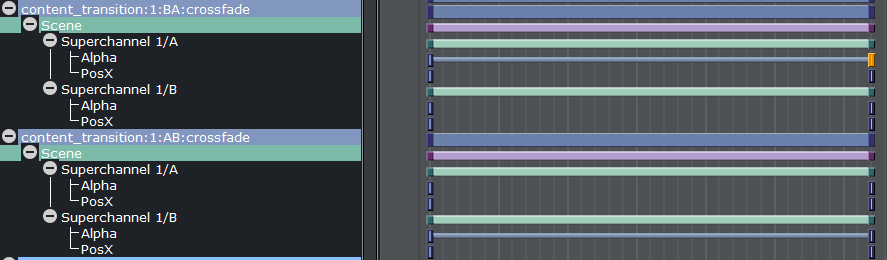

    Superchannels can automatically swap sources in an A/B mode with animated transitions, providing further flexibility and gains in overall performance.

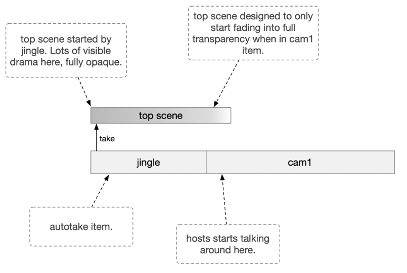

  • Top Scene support
    • A top scene is a scene loaded on to the Viz Engine front layer, on top of the current switcher scene. This type of scene is typically used for opener or closer animations for a show.
      Top scenes are called by adding a top scene attribute to the Viz Mosart template
    • Load (cue) and play a top scene on the Viz Engine front layer.
    • Cue a scene on-air (using a Viz Mosart break template).
    • Take a top scene on air.

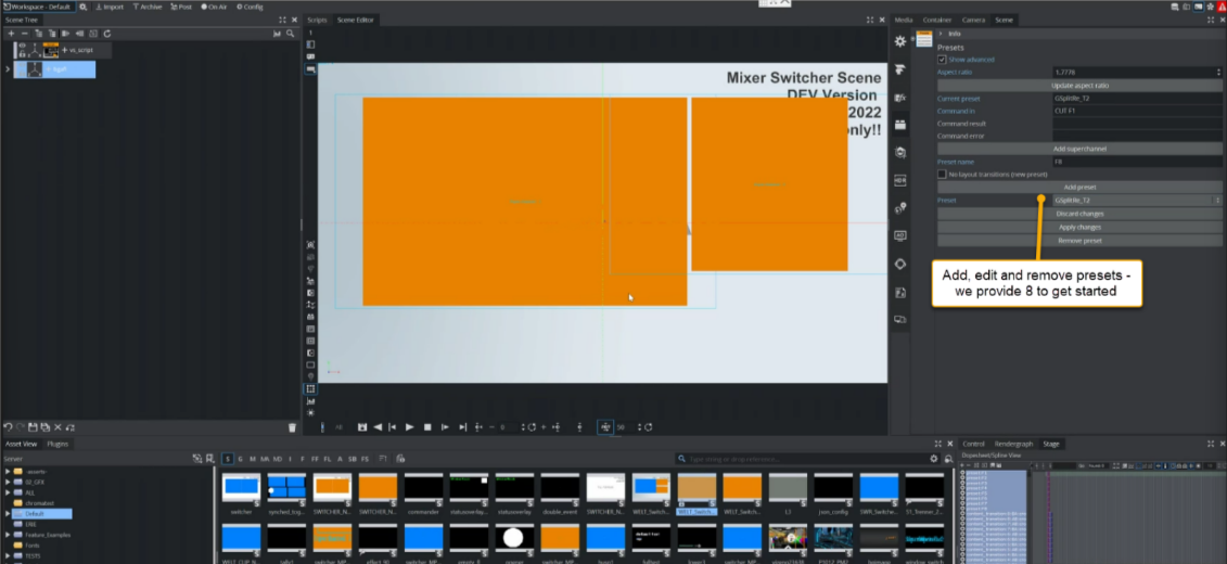

  • Preset support

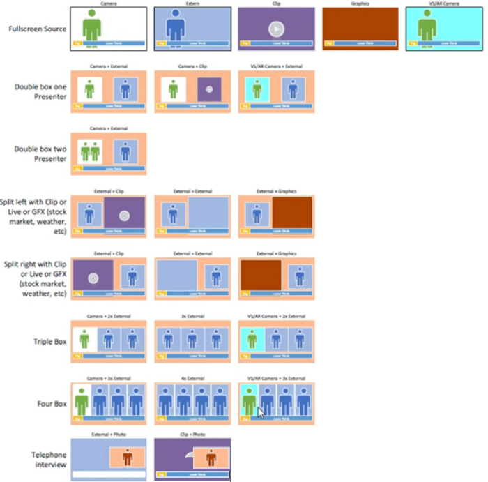

    • The layouts for BOX effects (split screens, picture-in-picture, etc.) are stored within the scene in a Presets plugin. A preset contains the transformation, alpha and cropping attributes for each Viz Engine superchannel and its sub-channels.
    • Set a preset in preview by specifying the preset name and optionally providing content for the preset labels from a Viz Mosart template or from the NRCS.
    • Cue a preset on air.
    • Take a preset on air, either by hard cut or transition. This transition can be specified in either a Viz Mosart template or from the NRCS.
    • Trigger the preset style using a keyboard shortcut.
    • Go to the previous preset style using a keyboard shortcut.

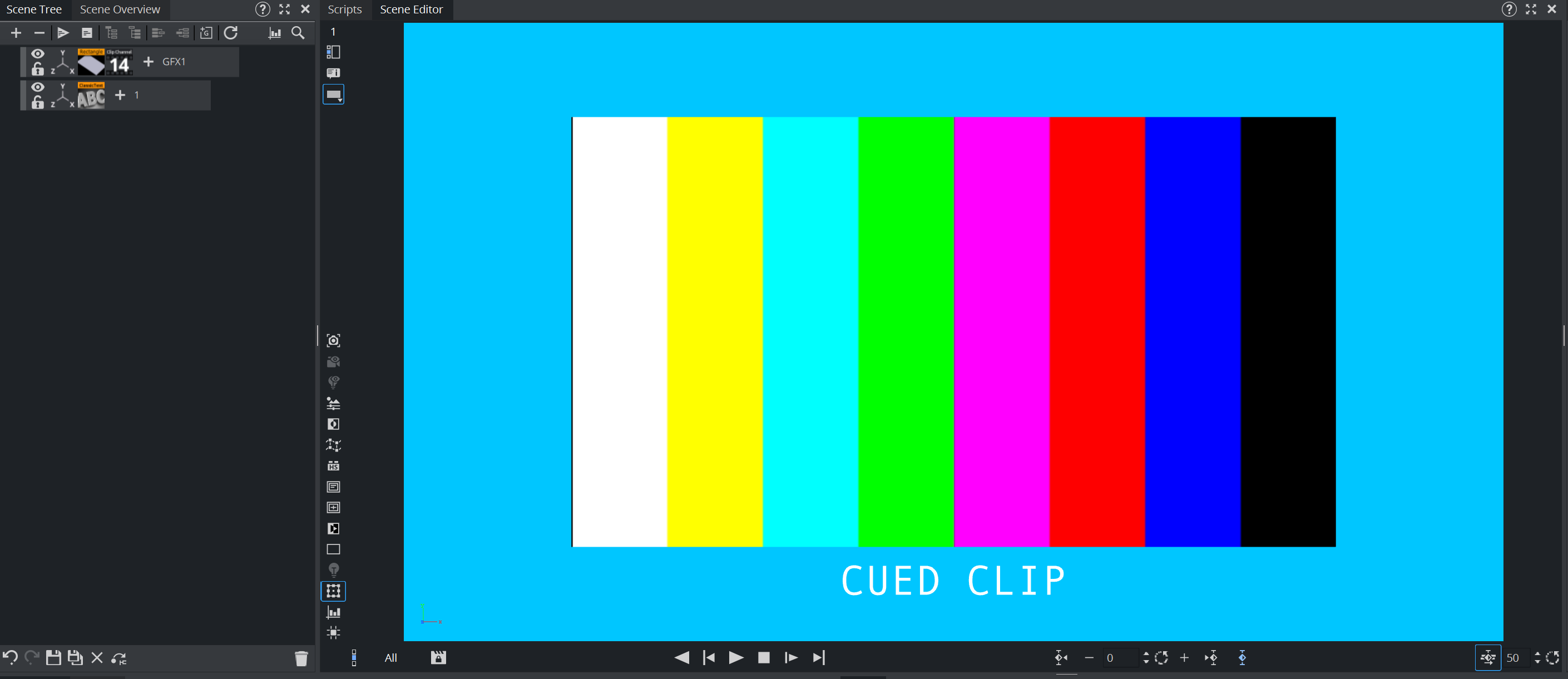

  • Clip support
    • Cue a clip in preview.
    • Cue a clip on air (using a Viz Mosart break template).
    • Play a clip.
    • Scrubbing.
    • Pause (where camera and adlibs are back-to-back).
    • Up to 4 clips can be cued. Using a 2x ripple, this enables an A to B transition for the single box.

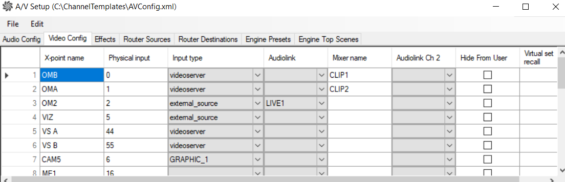

Defining Sources
  • Source ID from 1 - N.
  • CLIP X-points from 1-6 are mandatory and used for internal switching.
  • GFX X-points are mandatory for graphics.
Tip: The X-point name can either be
  • the source ID as defined on the Switcher side
    or
  • a Viz Mosart user-friendly name.
    In this case, then source ID (as defined on the Switcher side) should be entered in the Mixer name column.
By configuring these crosspoints on the video server ports in AV Automation or referring to them in Viz Mosart templates, these definitions enable standard Viz Mosart clip execution.

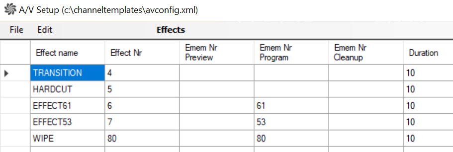

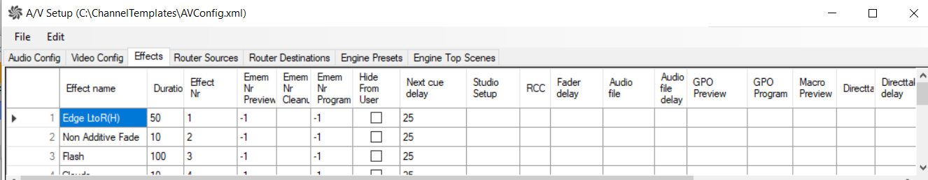

Effects
  • Effects need a unique Emem Nr for calling a specific effect scene.
  • Scenes are always prefixed with the string effect_x in the designated Graphic Hub effect Scene folder.
    x represents the Emen Nr defined in the configuration.
  • Effect IDs must not be higher than 80, since numbers 80+ are reserved for transition effects within superchannels.

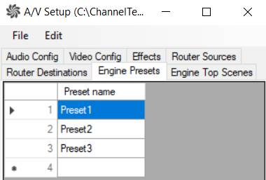

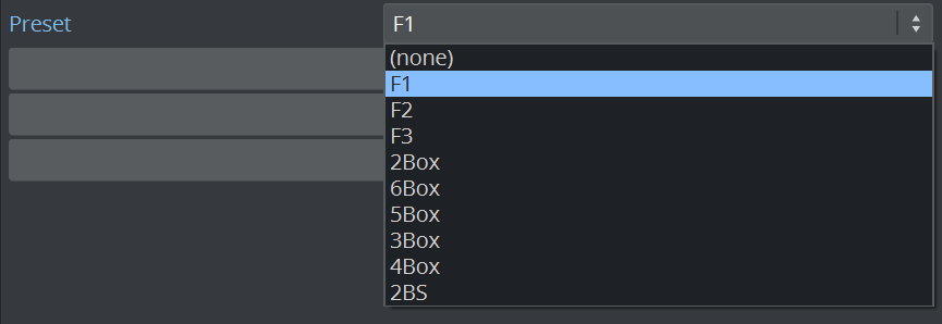

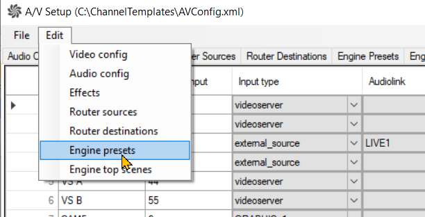

Presets
Tip: The concept Presets, is introduced below.

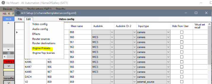

  • In Viz Mosart, you see the preset names in the A/V Setup (AvConfig.xml) file.
  • Preset names correspond directly to the presets defined in the switcher scene:
  • A Preset plugin, as it appears in a switcher scene:
Note: F1, F2 etc. are the default full screen options for each superchannel. F1 is mandatory.

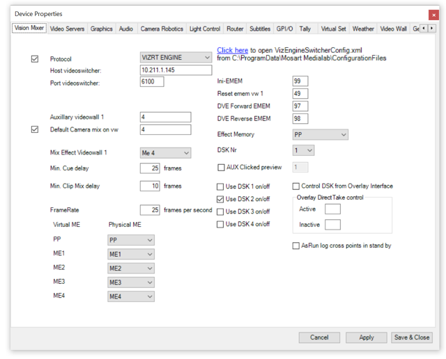

  1.  Navigate to AV Automation > Devices > Properties > Vision Mixer tab.
  2. From the Protocol drop-down menu, select VIZRT ENGINE.
  3. In addition to the default values, enter the following:
    1. Host videoswitcher: Location of the Viz Engine.
    2. Port videoswitcher: default 6100.
    3. Tick the box to the left of Protocol. This indicates that you want to control the vision switcher (mixer).
  4. Click Save & Close.
  5. From the Mosart Installation folder > Mosart Server > Configuration Files copy VizEngineSwitcherConfig.xml file into your Mosart working folder (C:\channeltemplates or C:\ProgramData\Mosart Medialab\ConfigurationFiles) and configure:
    1. ControlScenePat: The path to the Switcher scene located in the Viz Engine.
    2. NumberOfKeyBuses: The number of superchannels defined in the Viz Engine.

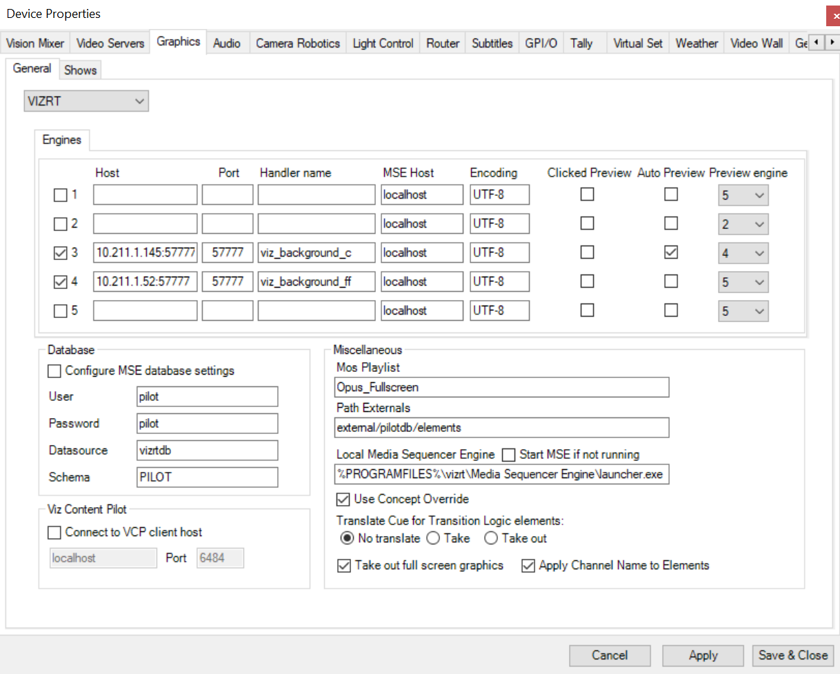

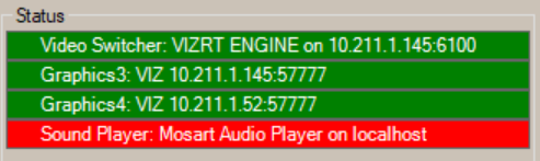

Graphics
  1. Select the Graphics tab.
  2. In the field Host, add the Viz Engine entry for PGM.
    Note: A second Viz Engine, running on separate hardware, can be added for optional PRV.
    • Enable the checkbox Auto Preview option and link it to the PGM engine. See Setup Second Engine.
  3. Add the designated superchannel port for each Viz Engine (default is 57777).
  4. Tick the Auto Preview box for the PGM Viz Engine.
  5. From the dropdown box under the Preview engine column, assign the identity of the PRV Viz Engine to it.
  6. Follow the other guiding values as illustrated above, then click Save & Close.
These show up in AV Automation:

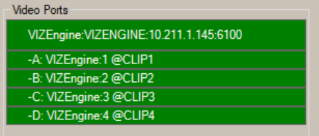

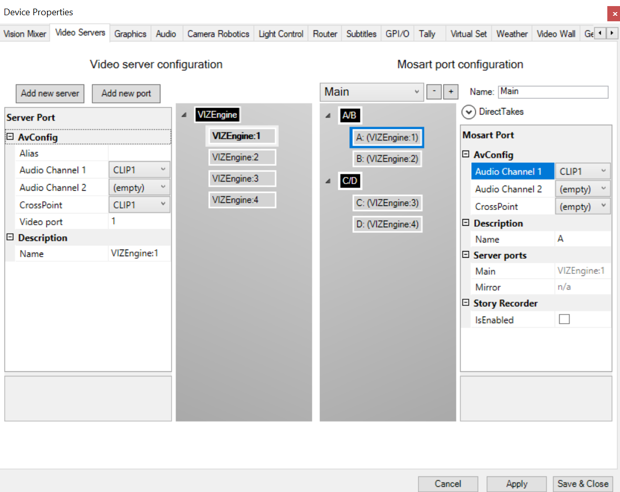

Video Server and Port Configurations
  • Select the Video Servers tab and add four server ports to create two clip server pairs:
    • A/B
    • C/D

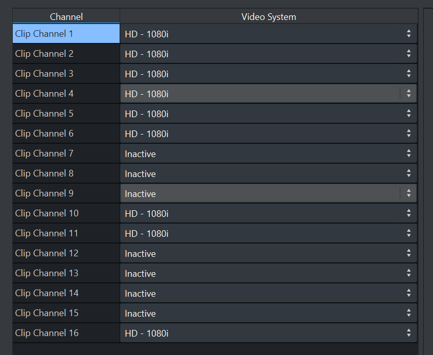

  1. Navigate to the configuration section Communication.
  2. Select Super Channel Port and set it to an available Port (for example, 57777)
  3. Clip channels: Activate the following clip channels:
  • Clip channels 1-4 and 10-11 are for full screen and box clip playback.
  • Clip channels 5-6 are optional for videowall integration playback (not included in default setup).
  • Clip channel 16 is for clips loaded in top scenes.

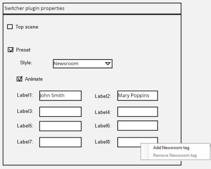

Introduction to Presets, Top scenes and Effects
Viz Engine Switcher operations depend on distinct criteria, controlled from a Viz Mosart template. All settings are made during template design, as described in the section Template Editor.
Three concepts for Engine Switcher operations are:
Presets
Info: The term preset originates from scene design in the Viz Engine. The composition of the scene is defined by x,y positions of a collection of 'windows' (two in the illustration below) in a Viz Engine superchannel. These definitions describe:

Each composition, saved on the Viz Engine, is called a preset.
Note: Superchannel 1 is considered the main superchannel for full screen program switches. The preset F1 is mandatory for this workflow and must not be altered.
Viz Mosart includes a sample Switcher scene with eight presets.
  • Use Viz Artist to edit any preset.
    For more details, refer to the Viz Artist User Guide.
  • In Viz Mosart, you select the Preset name from the list of preset names that have been configured in A/V Setup (AvConfig.xml) file.
  • Transition style
    The transition style (hard-cut or animation), and several label values can be specified.
    For example, in a DVE template (where Switcher plugin for the device is available), you can select the layout and look of the DVE effect by specifying a preset style (Style), the preset transition and the DVE window labels (Label1 - Label8), as required:
    You can also provide static values directly on the template. Additionally, newsroom tags can be configured to enable control from the NRCS.

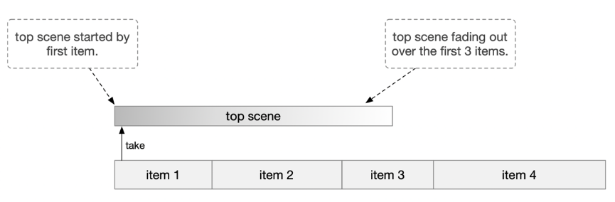

Top Scenes
A typical use of top scenes is as an opener. For example, the top scene is played to introduce the Eight O’clock News show with many visual effects that fade to the following camera scene, when the news host takes over.

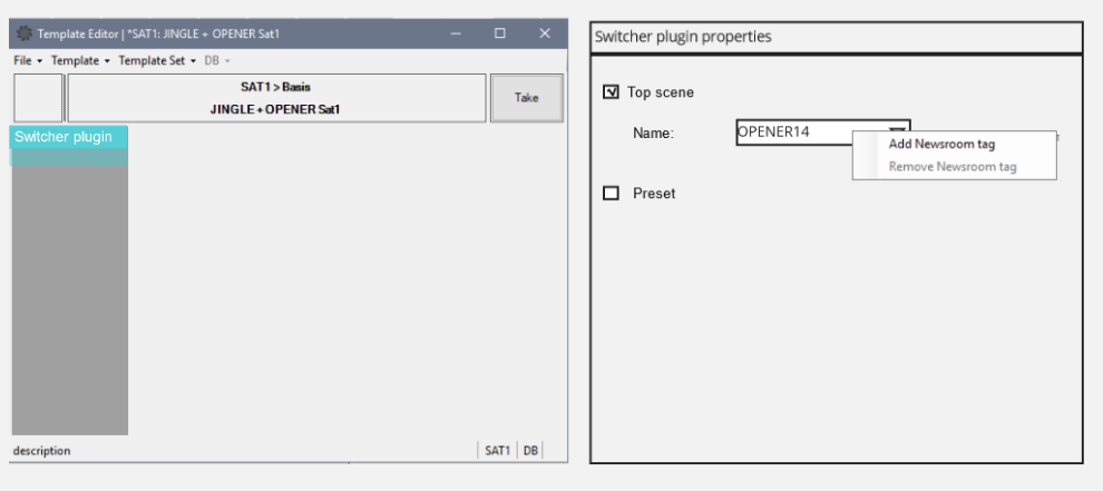

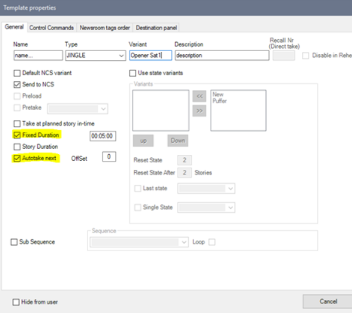

To Create a template to play a top scene
  1. Select an appropriate template, for example Graphic or Jingle, corresponding to your Engine Switcher-controlled operation.
  2. Enable Switcher plugin for the device.
  3. From the Switcher plugin properties menu, specify a top scene name:
    1. None (Top scene unchecked)
    2. Check Top scene and select from the drop-down list of top scenes (configured in the A/V Setup).
Time-related configurations
There are two time-related aspects for top scenes (similar to handling clips):
  1. The time it takes for the scene to load. This is controlled automatically by Viz Mosart when cueing the story item.
  2. The time it takes for the scene to run. This is controlled with the template configurations Fixed Duration and Autotake next.
  • Top scenes are started from within a story item and if long enough, continue to play even when the item ends.
  • Top scenes ignore story items boundaries. The take out of a story item must match the animation length of the top scene.
  • Top scenes can be played on top of anything else.

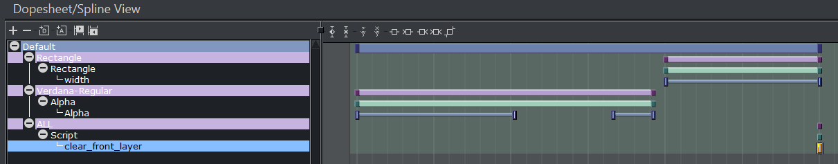

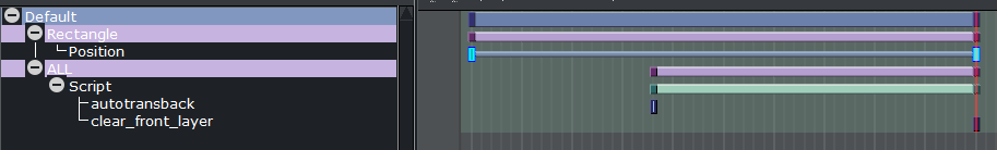

In this case a clear_front_layer button is added to the animation in the Stage

Example Effect
  1. The scene is fully transparent at the beginning of its animation.
  2. At Take, an animation starts to show content, animating to fully cover the scene underneath it (switcher).
  3. After a predefined time, the animation reaches the autotransback script routine, which triggers the switch in the Switcher Scene.
  4. The animation fades out, being fully transparent again.
Script
Two routines, one for triggering the take (auto_trans) and one for its removal when the animation ends:
sub OnInitParameters()
    RegisterPushButton("autotransback", "Auto trans back", 1)
    RegisterPushButton("clear_front_layer", "Effect Close", 2)
end sub
sub OnExecAction(buttonId As Integer)
    if buttonid = 1 then autotransback()
    if buttonid = 2 then clear_front_layer()
end sub
sub autotransback()
    dim commandStr as string = "RENDERER*MAIN_LAYER" & "*SCRIPT INVOKE auto_trans"
  println 5, "--------------- TOP SCENE TRANS FROM FL SCENE ----------------"
    System.SendRemoteCommand("localhost", 6100, commandStr, 0)
end sub
sub clear_front_layer()
    dim commandStr as string = "RENDERER*MAIN_LAYER*SCRIPT INVOKE clear_front_layer"
    println 5, "--------------- TOP SCENE OUT ----------------"
end sub

Preset Plugin
The Preset plugin creates a default content transition for a crossfade. Additional transitions for changing content within superchannels are created manually using Viz Artist.
Default Preset plugin crossfades
  • A custom content transition is saved to a special director name, called by the Switcher from Viz Mosart.
    This director can contain the required transition animation.
  • Typically, a content transition director contains the keyframes related to the superchannels sub-channels A and B.
  • Content transitions are created in both directions. A separate director is used for a transition between A to B, and B to A.

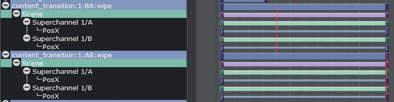

To define a director
  • A director has the following naming format:
    content_transition:<ID>:<direction>:<transition_name> where
    • ID: Superchannel ID
    • direction: AB or BA
    • transition_name: Name the transition that will be called in the UI (for example wipe).
Custom Effects
  • Custom effects scenes are manually added to the Engine Switcher's configuration file.
Note: Custom effects IDs start at 80.
To create an Effect
  1. In Viz Mosart Mosart AV Automation:
  2. In the Viz Engine Engine Switcher Configuration file, C:\ProgramData\vizrt\VizEngine\switcher_config.cfg
    #custom content transition effects
    <content_transitions>80:wipe,81:rotate,82:twist</content_transitions>

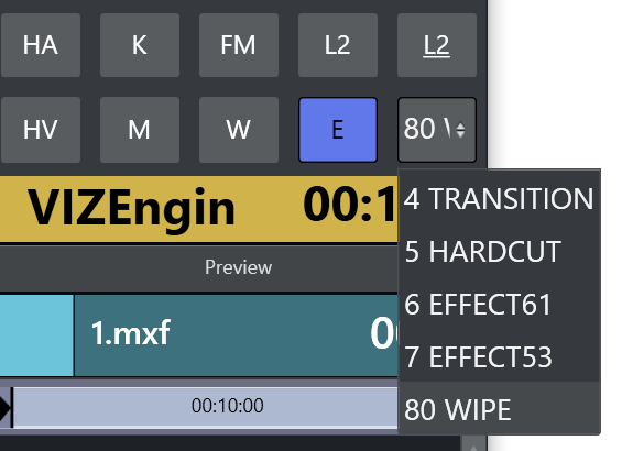

  3. The effect is now available for selection in Viz Mosart:
Example - Effect 80 - Wipe:
A typical wipe is set up by animating the subchannel's X position from left to right, then having the other subchannel follow.
Values:
(1) Direction AB (content_transition:1:AB:wipe):
  • Assuming sub-channel 1/A is visible and should fade out to the right
  • Keyframes for Pos X are set to
    • Superchannel 1/A:
    • Start : 0.0
    • End : 100.0
  • Sub-channel 1/B starts on left to 1/A and animates onto the screen
    • Superchannel 1/B:
    • Start : -100.0
    • End : 0.0
(2) Direction BA (content_transition:1:BA:wipe):
The roles are now switched, this means 1/B starts on the screen, animates to the right and 1/A now appears from the left.
    • Superchannel 1/A:
    • Start : -100.0
    • End : 0.0
    • Superchannel 1/B:
    • Start : 0.0
    • End : 100.0

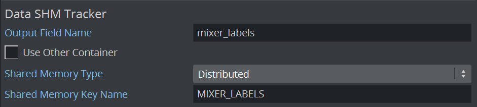

The default map name is MIXER_LABELS. This can be changed within the Engine Switcher Configuration File.
In this example you use a Vizrt Datapool plugin to access the content of the shared memory and deliver its content to a specified text container.
  • An SHMTracker plugin reads the memory content.
  • The content is forwarded to any other Datapool plugin within the scene.
  • Here, ataText receives the memory content from SHMTracker and parses the values into a readable format
  • The content is pasted into the geometries Text plugin.

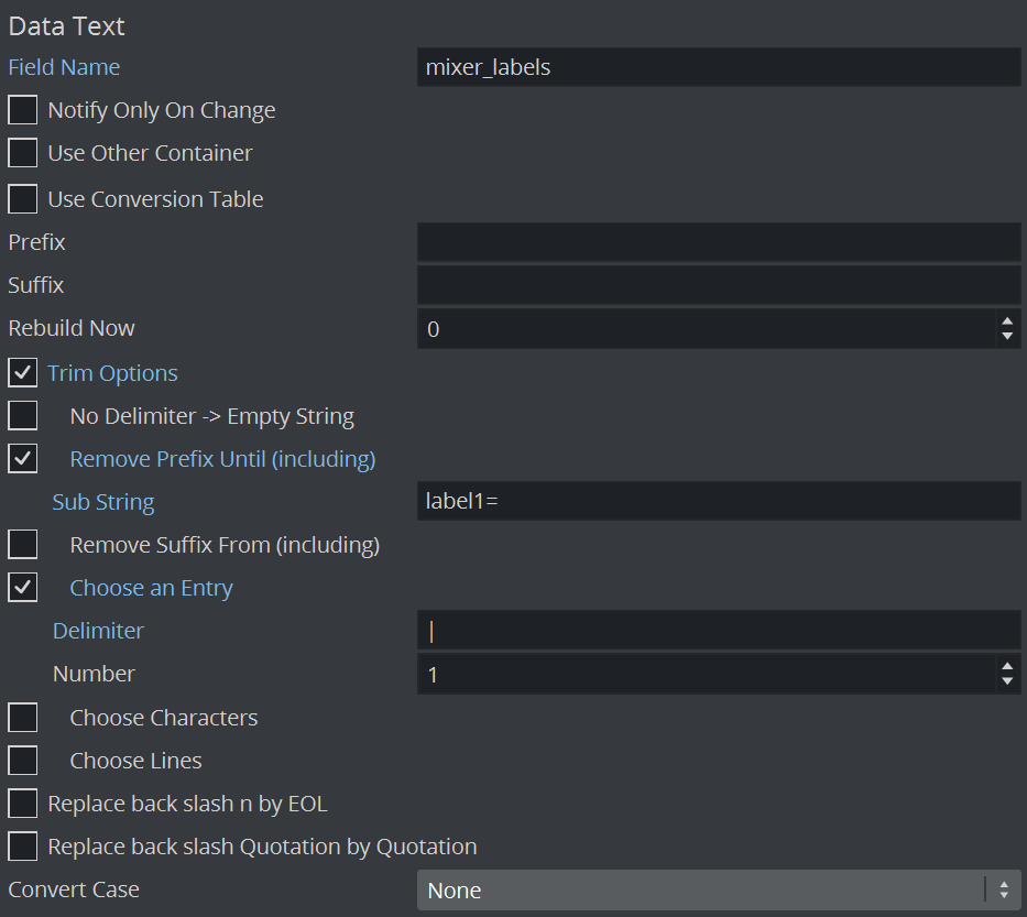

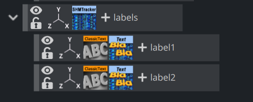

  1. Create a container, name it labels.
  2. Add the SHMTracker plugin to it.
  3. Set a unique ID for Output Field Name, in this example mixer_labels.
  4. To access the Switcher scenes used SHM, set Shared Memory Type to Distributed.
  5. Assign Share Memory Key Name. Default is set to MIXER_LABELS.
  6. Create a child container and name it label1.
  7. Add the Data Text plugin.
  8. Set Field Name to the same ID as used in the parent plugin. In this example, mixer_labels.
  9. In Rebuild Now
    1. Check Trim Options.
    2. Check Remove Prefix Until and enter Sub String label1=
      This crops the label from the incoming string.
    3. Check Choose an Entry.
      1. Set Delimiter to |
        This crops the string, revealing the first label entry.
  10. Repeat these steps for all required labels, modifying the sub-strings accordingly to label2= etc.

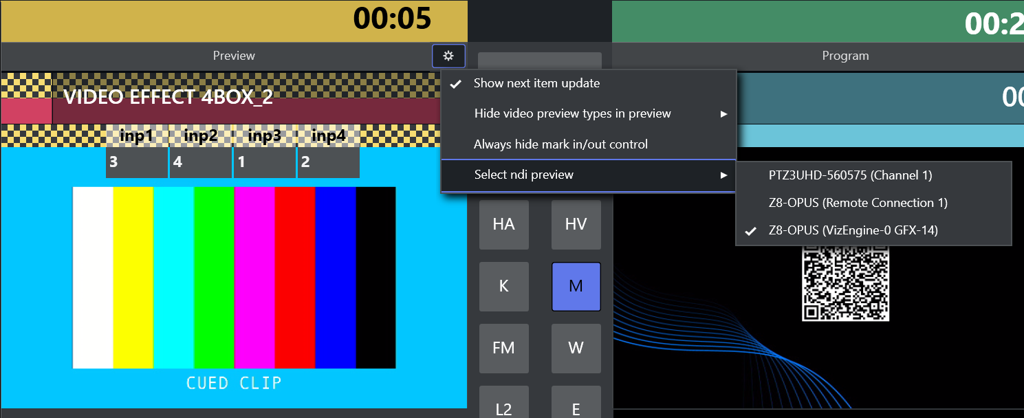

NDI Clip Preview
If a simple preview of the upcoming clip layout/switch is needed and a separate Viz Engine cannot be used, you can instead add a small nested scene to the Switcher scene. This can stream the next cued clip via NDI (Network Device Interface, a protocol).
Note: The Media Preview feature used in Viz Opus is no longer supported.

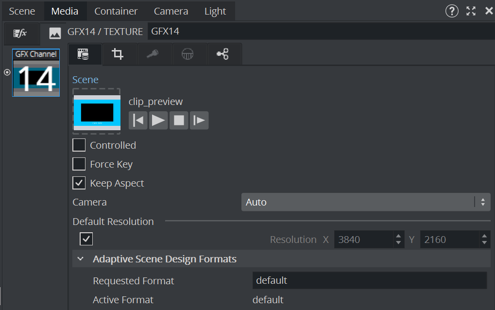

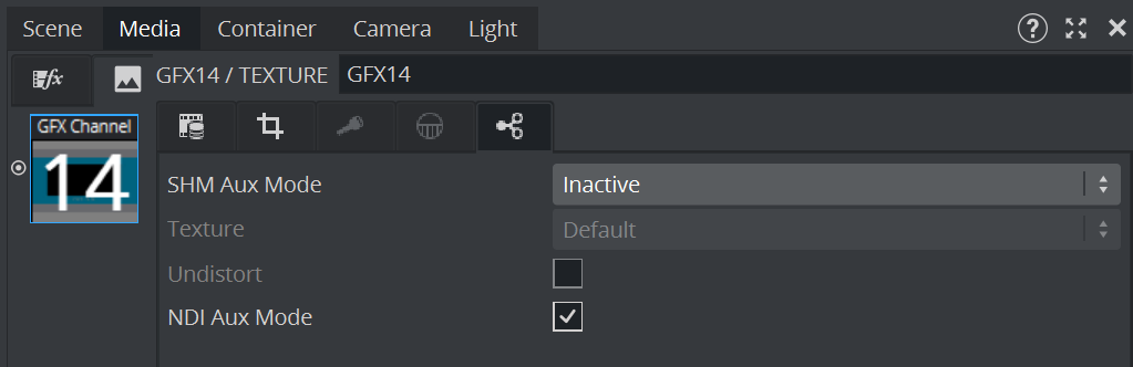

To stream a preview with NDI
Engine Switcher is configurable to send clip cueing commands to a separate scene if needed.
  1. Add the scene to a GFX channel within the Engine Switcher scene.
    By default, GFX channel 14.
  2. Add this channel manually to any existing Switcher scene.
  3. To activate the NDI output of GFX channel 14, activate NDI Aux Mode.
    GFX channel 14 will now be received as a separate NDI stream on the network.
    Previewing a scene
    The preview scene setup is simple.

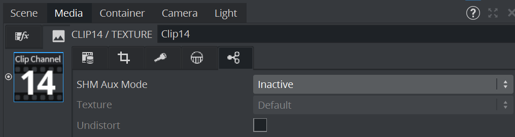

  4. Clip channel 14 and 15 are used to load the next cued full screen or box clip.
    The layout of the scene itself does not matter and requires no further logic.
  5. The two clip channels are added as texture to the scene and can be placed as required.
  6. Ensure that the required clip channels are added as texture within the scene.
    Setting up Viz Mosart
  7. In Viz Mosart, select the source in the Preview window.
  8. As soon as a clip is cued as next item, the GFX channel scene loads the paused clip. This updates the NDI stream of the Mosart UI.

    Viz Mosart
    • C:/channeltemplates/VizEngineSwitcherConfig.xml
    • C:/channeltemplates/ClipServerVizEngine.xml
      Note: VizEngineSwitcherConfig.xml and ClipServerVizEngine.xml are originally located in the Viz Mosart installation folder C:\Program Files (x86)\Mosart Medialab\Mosart Server\ConfigurationFiles.
    • AV Automation Devices Vision Mixer
