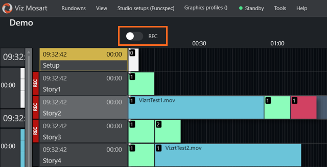

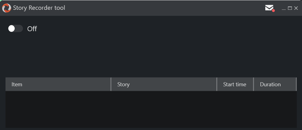

To enable/disable Story Recorder mode
You can enable or disable Story Recorder mode using any of these methods:
  1. Story Recorder panel toggle: The On/Off switch at the top of the Story Recorder panel.
  2. Timeline toolbar toggle: When the rundown contains stories that in the NRCS have been marked for recording, an SR toggle button appears directly in the Mosart UI timeline toolbar:
  3. Keyboard shortcut: A configured keyboard shortcut can toggle, enable, or disable SR mode.
  4. Template control command: the STORY_RECORDER control command on a template can automatically toggle, enable, or disable SR mode when the template is taken.

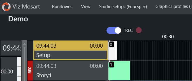

All four methods produce the same result. The current recording status is shown in both the Timeline toolbar and the Story Recorder panel:

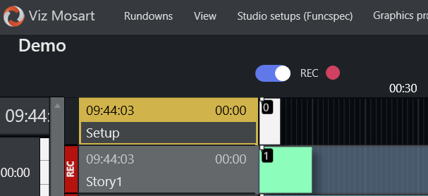

  • Pale red REC indicator: Story Recorder mode is enabled, but recording has not yet started.

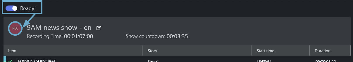

  • Bright red REC indicator: Story Recorder is actively recording. In the Story Recorder panel, the REC button also blinks during recording.

To display the Story Recorder panel
  1. With Viz Mosart running, from the menu bar select View > Floating windows > Story Recorder tool.
  2. Position the Story Recorder window on your workspace.
    (You can also place this window on a second screen.)
  3. (Optional) Save this workspace setup for future use:
    View > Save as new workspace and enter a unique name.

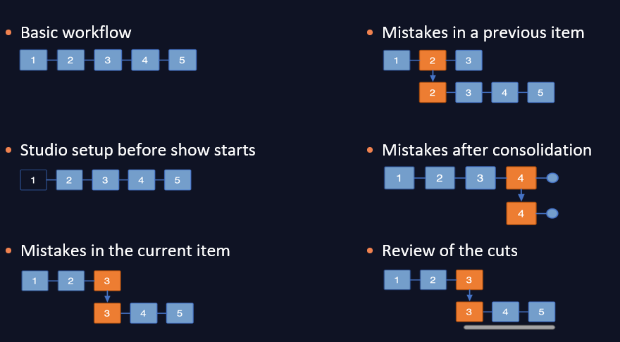

The following diagram illustrates common recording scenarios. Blue items are recorded segments; orange items indicate retake points.
The sections below describe three common use cases for supporting error-free production and recording of a Viz Mosart-driven show.

    After a few seconds, the REC button is red, indicating the system is ready to record your show.

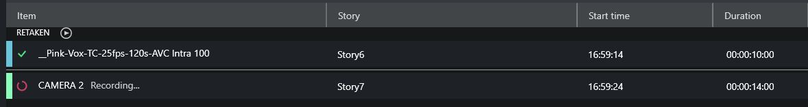

    For each story item taken, a row is presented in the Story Recorder panel, the most recent indicated with Recording...

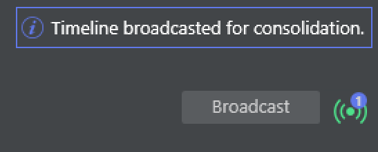

  1. Click the Broadcast button.
    A confirmation message and counter indicate that the clip has been sent for stitching.
Info: The counter indicates the number of EDLs currently being stitched on the EDL transcoder.
  • Each time you click Broadcast, a new task is sent. See also Broadcast below.
  • If you accidentally order the same stitching operation multiple times (by pressing Broadcast more than once for your required recording), you can cancel the transcoding job by reviewing the job queue on the transcoder. Your System Administrator can assist with this task.
  • The counter is cumulative per recording session, and does not decrease once the stitching job has finished or been cancelled on the EDL transcoder side.

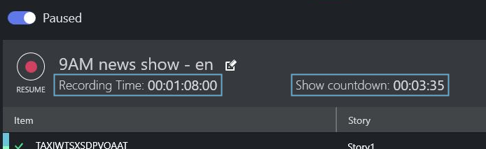

  2. Press PAUSE to interrupt recording as required.
    1. In the Story Recorder panel, the current story item is marked as Paused.
    2. In Rundown view above, the corresponding rundown story title is also blue.
    3. In the Rundown view, on the story row, a pre-roll template is automatically inserted before the paused story item.
  3. Make required changes and prepare to recommence recording, by clicking the button PAUSED.
    A countdown timer cues for retake and recording resumes from the break point.
    Continue as above till the last story line, where an information text warns that the show recording will soon be complete.

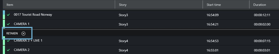

  4. (Optional) When resuming after a pause, approximately 10-15 seconds into the new recording, a snippet featuring the previous cut is available for review.
    Click the Play icon to start view.

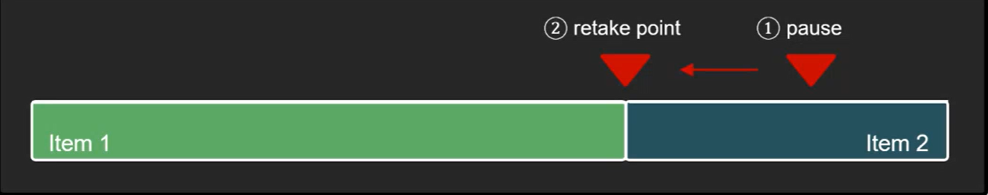

Rolling Back in Time at Retake
The smallest rollback is a Viz Mosart primary story item. A story row usually comprises several story items, each item defined with a Viz Mosart primary template.
So for example, if your running show is executing item three of the four primary items that make up the story, then the pause will cause a rollback to the start of item three.
A retake point is always at the start of a primary item, regardless of where the pause was made.

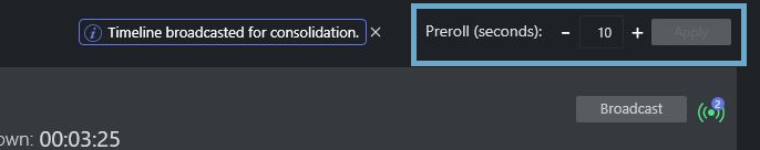

Pre-roll
When you pause a story, Viz Mosart automatically inserts a pre-roll event in the story row, before your paused story item.
The duration of this pre-roll is configurable, usually around 10-15 seconds. The pre-roll period provides the system time to automatically initialize itself back to a stable, known status for all equipment like robotic camera positions, onscreen graphic elements, media clip availability, fader levels. It also provides a cue for the talent to prepare for beginning again.
Critically, the pre-roll period can never be less than the time the video server hardware requires to prepare for recording. This is typically 10-15 seconds.
  • You can configure the pre-roll time from the Story Recorder panel:
Broadcasting an Alternative Version of the Show
Broadcast means auto-creation of a show-level EDL, from the list of story rows in the Story Recorder panel; This EDL is then fed to the EDL transcoder (Vantage) watch folder. The transcoder picks up the EDL file and initiates the job of stitching the clips (that represent the story rows), into a single show clip. This single clip is used for playout.
  • You can broadcast at any time, during a paused recording, and then continue recording.
    This for example can be when producing a trailer, a second language variant of the show, or when in the afternoon you want only to change the last couple of stories from the morning's recording.

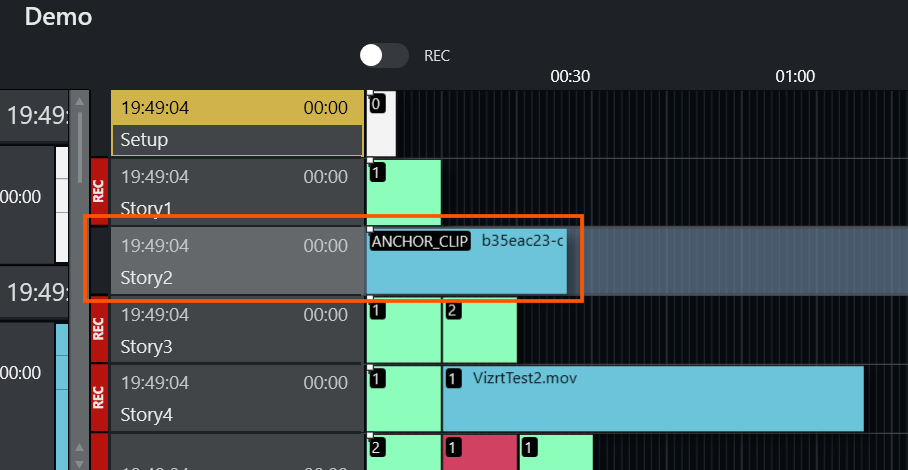

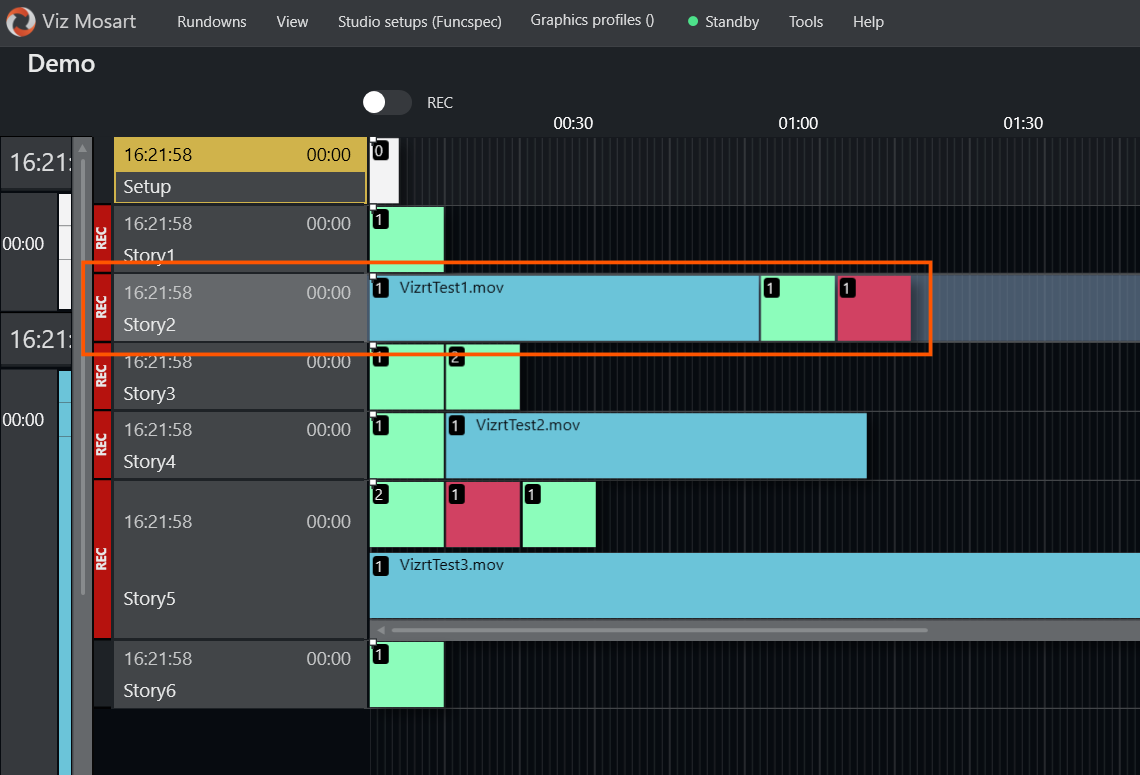

Stories Marked for Recording
For the story clip production workflow, stories must be tagged for recording in the NRCS before the show. Any NRCS that can provide the required metadata fields on the MOS story object can be used with this workflow. Saga and Showmaker offer built-in integration; other NRCS systems can be configured via Newsroom Settings field mapping.
See Story Recorder Setup for the NRCS metadata requirements and configuration details.

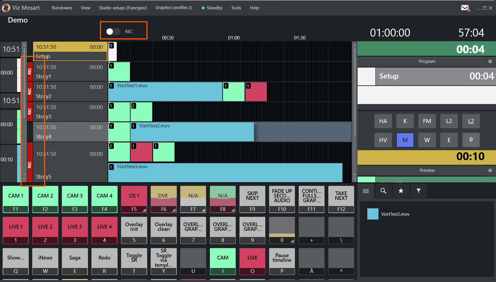

When a rundown containing tagged stories is loaded in Viz Mosart, these stories are shown with a REC indicator in the main timeline view. The Story Recorder mode toggle at the top of the timeline also indicates whether there are stories to be recorded.
The REC indicators means that the tagged story is configured for clip production. When Story Recorder mode is enabled and a clip output (renderer/transcoder) is configured, a clip will be produced for this story. The indicator does not mean the story is currently being recorded, and no clip production occurs unless Story Recorder mode is enabled.

  1. In the NRCS, ensure the relevant stories are marked for recording.
  2. Load the rundown in Viz Mosart. Verify that tagged stories show REC indicators in the timeline.

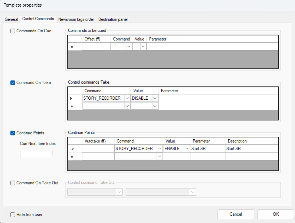

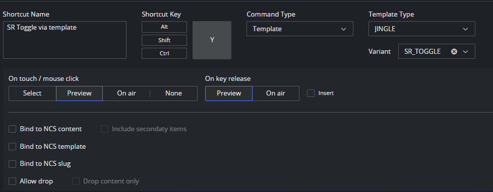

This is achieved by using a dedicated template with a STORY_RECORDER control command that toggles SR mode on and off between stories. The template is configured with:
  • Command On Take: STORY_RECORDER with value TOGGLE (or DISABLE) . This disables SR mode when taken on air, triggering clip production for the completed story.
  • Manual Continue Point: STORY_RECORDER with value TOGGLE (or ENABLE). This re-enables SR mode when the operator takes the next manual continue point.

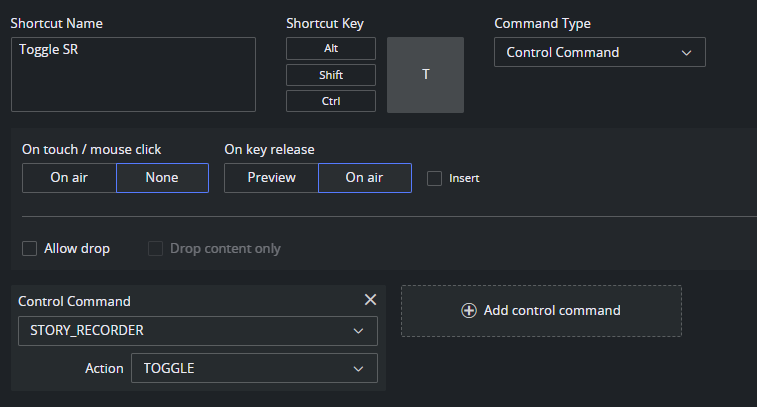

The SR Toggle Template can be executed in two ways:
  • Keyboard shortcut: Configure a keyboard shortcut to take the template in Preview. The operator recalls this shortcut on the last item of each story, then takes the template on air when ready to end the story.
  • From the NRCS: Add the SR toggle template at the end of each story in the rundown. The template is then automatically queued as the last item of the story.

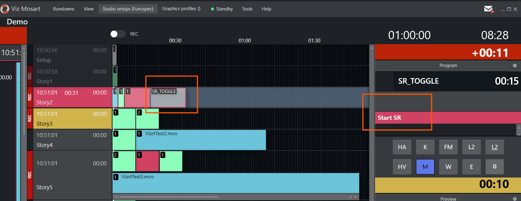

  4. On the last item of a story, bring the SR Toggle Template into Preview (using its keyboard shortcut, or automatically if placed in the rundown).
  5. When the story is finished, take the template on air. This disables SR mode and triggers clip production for the completed story.
    The manual continue point is indicated in the Mosart UI.
  6. When ready to continue with the next story (for example, once the anchor has repositioned), press Take Next. This takes the continue point, re-enables SR mode, and recording resumes with the next story.

Mimir Clip Production
When Story Recorder is configured with a Mimir output, completed stories are submitted as render jobs to Mimir. Stories not marked for recording in the NRCS are skipped.
  • When Story Recorder mode is enabled, Mosart creates recording clip placeholders in Mimir for each configured recorder.
  • At story completion, a render job is submitted to Mimir using the configured preset and Kelda configuration.
  • The clip ID assigned to the story in the NRCS is used as the target item (Anchor clip) in Mimir.
    • On the first recording, the clip is rendered into the existing anchor item placeholder.
    • For repeated recordings of the same story, a new version is created under the same anchor item, preserving the version history.
      Mimir then updates the NRCS (e.g. Saga) with the new anchor clip ID, so subsequent recordings reference the latest version.
See the Story Recorder Setup section of the Viz Mosart Administrator Guide for Mimir device, preset, and Kelda configuration.

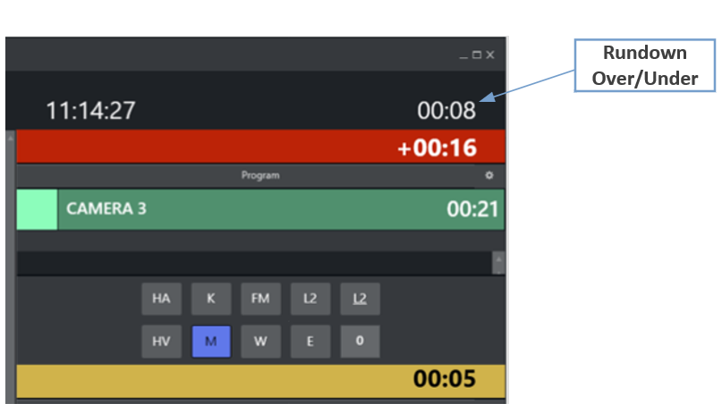

The Mosart UI has been extended with support for Story Recorder-related timing fields.
The Story Recorder panel displays the following new timing details:
The Recording Time field starts at zero when a Story Recorder session is started, and
  • When the timeline is running, this counter is continuously growing, equal to the sum of the already recorded sections + the duration of the current recording.
  • When the timeline is paused, this counter is static, equal to the sum of the recordings prior to the selected Retake point.
The Show Countdown field displays the difference between the planned duration as defined in the NRCS and the Recording Time.
  • When the timeline is running, this counts down.
  • When the timeline is paused, this is static.
If Recording Time exceeds Show Planned Duration, then Show Countdown becomes negative and will be counting up.
The Rundown over/under field is an existing field in the Viz Mosart UI, and when Story Recorder mode is enabled, it provides an indication of the executed recordings relative to the remaining rundown and the planned duration of the rundown:
  • Under: indicates the number of seconds the show must be extended to meet the planned duration.
  • Over: indicates the number of seconds the show exceeds the planned duration.
All these Story Recorder related time fields are also shown in the Mosart Timing Display and forwarded to the Plura Timing System (using the Time Request Protocol).
