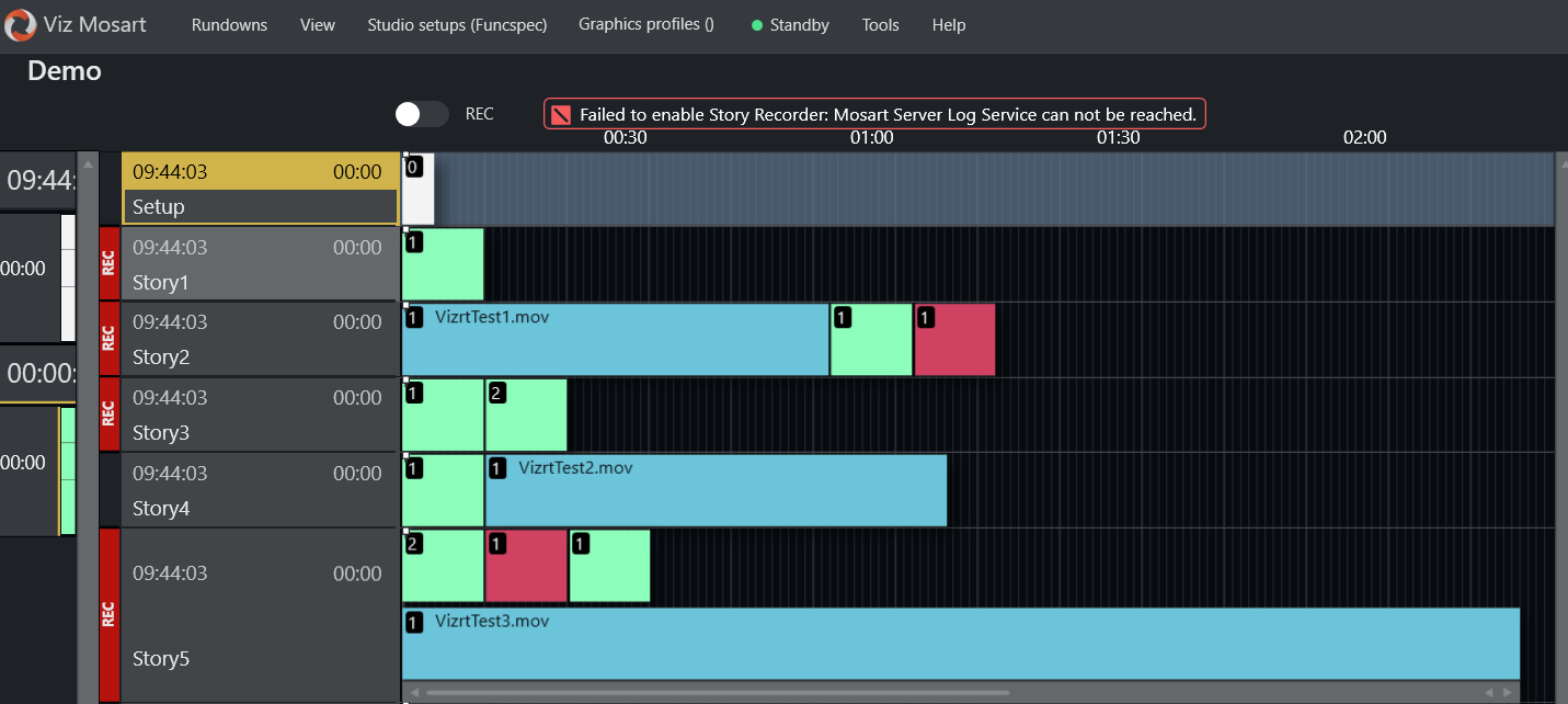

Failed to enable Story Recorder: Mosart Log Service can not be reached.

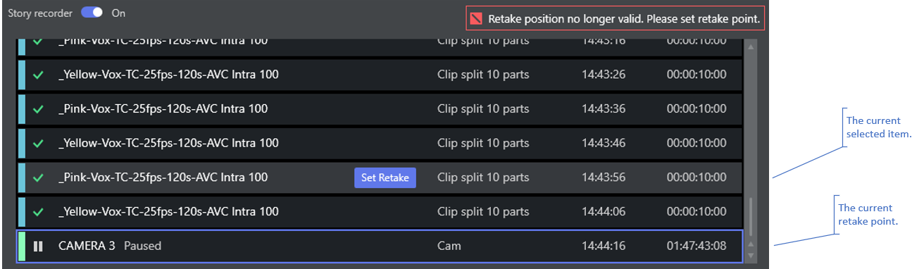

Invalid Retake Position
If you get the error notification Retake position no longer valid. Please set retake point this means that you restarted the show after a pause, but the selected story item is not the retake point (the story item with the Set Retake button):
To fix, do one of the followings:
  1. Select the current retake point (if this has changed by mistake)
    or
  2. Make the selected story item the new retake point by clicking the row's Set Retake button.
If you choose (2), remember that all the recorded story items after the retake point, including the story item set as retake point, must be re-done once the show is restarted after pause (see Working with Story Recorder).

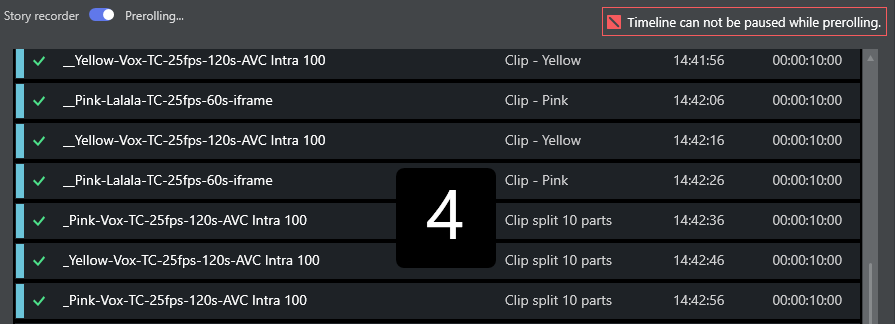

Error when Pausing the Story
If you get the error notification Timeline can not be paused while pre-rolling, this means you are trying to pause while the system is in pre-roll mode. The pre-roll process can not be interrupted.
If this action was done intentionally, let the pre-roll time-out and auto-take the item to be retaken, and then pause again.
