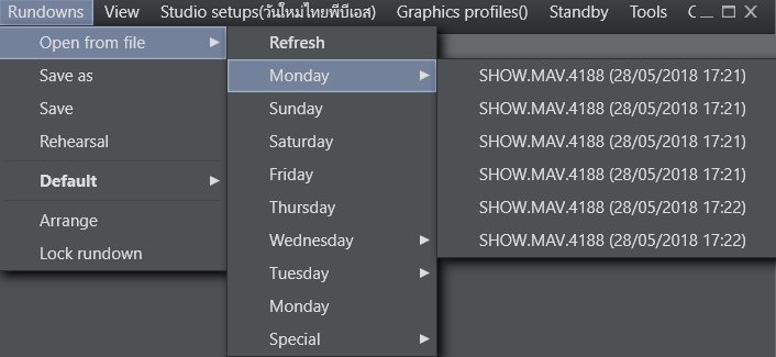

Viz Mosart's primary source for rundowns is the NCS. Viz Mosart also saves the rundown (as an XML file) on the Viz Mosart server. Viz Mosart automatically saves changes to the rundown, but the user may also save manually. To distinguish later versions of a rundown from the original, Viz Mosart appends a timestamp to the file name of any subsequent version. The user may also open a rundown from one of these files. The file rundown is mainly meant for debugging purposes, and not intended for on air productions.
The Rundowns item contains the following options:
  • Open from file. Lists rundowns found in the folder mentioned above. Normally stored at C:\Manus.
    • Refresh. Refreshes the list of available rundowns.
      Between Refresh and Special there are eight menu options for 'today' (this and similar words not referring to the day of writing or the day of reading, but to the day of Viz Mosart use), yesterday, the day before yesterday, up to the day a week ago. The option names are the names of the days in the language of the user's computer. For each of these eight days, there is a sub-menu containing the timestamped rundown files saved on that day. (If none, there is no sub-menu.)
    • Special. Lists the non-timestamped rundown files.
  • Save as. Saves the current rundown with a new name in the window that opens.
Note: Do not include an underscore ('_') in the name. Files with underscore in the name will be automatically deleted once Manus expiration time has been reached. See the Viz Mosart Administrator Guide, section Manus Administrator Configuration
  • Save. Saves the current rundown.
 Info: By default, the location where rundowns are saved is C:\manus, but this may be overridden by the Manus Directory setting in the Settings Editor. Refer to the Viz Mosart Administrator Guide, section Manus Administrator Configuration.

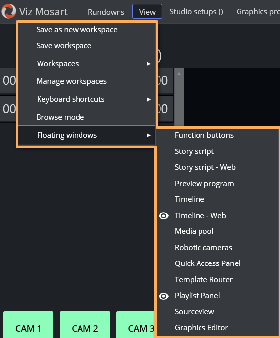

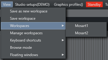

The View item contains the following options and sub-options:
  • Save as new workspace. Saves the current view/workspace with a new name in the window that opens.
  • Save workspace. Saves the current view/workspace.
  • Workspaces. Selects from the available workspaces.
  • Manage workspaces. Opens the Manage workspaces window.

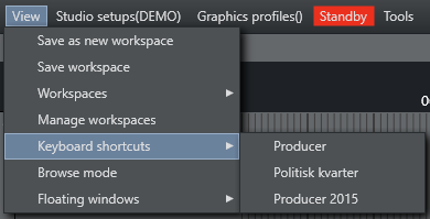

  • Keyboard shortcuts. Determines which Keyboard Layout to be used.
  • Browse mode. Activates/deactivates Browse mode. For more information see Running Viz Mosart in browse mode. Whether this option is shown, is controlled in General Settings accessed from the Tools menu.
  • Floating windows. Lists both the different parts of the main window that can be released as separate windows, as well as windows that can be opened that are not part of the main window:
    Note: The 'eye' icon indicates a floated window.
    Releasing Windows
    Opening Windows

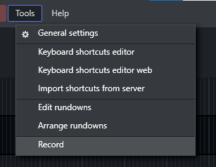

The Tools item contains the following options:
  • General settings. Opens the General settings dialog. See General Settings.
  • Keyboard shortcuts editor.  Opens the Keyboard shortcuts editor. See Keyboard Shortcuts .
  • Keyboard shortcuts editor web.  Opens the new web-based shortcuts manager. See Keyboard Shortcuts .
  • Import shortcuts from server. See Keyboard Shortcuts Editor (section Exporting and Importing Shortcuts from Server).
  • Edit rundowns. Opens Edit Rundowns panel. See Managing NRCS Rundowns. This menu option only appears when having a connection to iNEWS. When using other newsrooms systems, the menu option is not visible.
  • Arrange rundowns. Opens the Arrange rundowns panel. See Arrange Rundowns.
  • Record. Opens a recording panel to create a new video recording. See Recording.

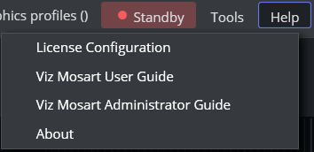

The Help item contains the following options:
  • License Configuration. Opens the License Configuration menu, intended for the Viz Mosart administrator. Please refer to the section Licensing in the Viz Mosart Administration Guide.
  • Viz Mosart User Guide. Opens (this) User Guide.
  • Viz Mosart Administrator Guide. Opens setup and configuration documentation intended for a Viz Mosart administrator.
  • About. Product version identifier and third party license details.

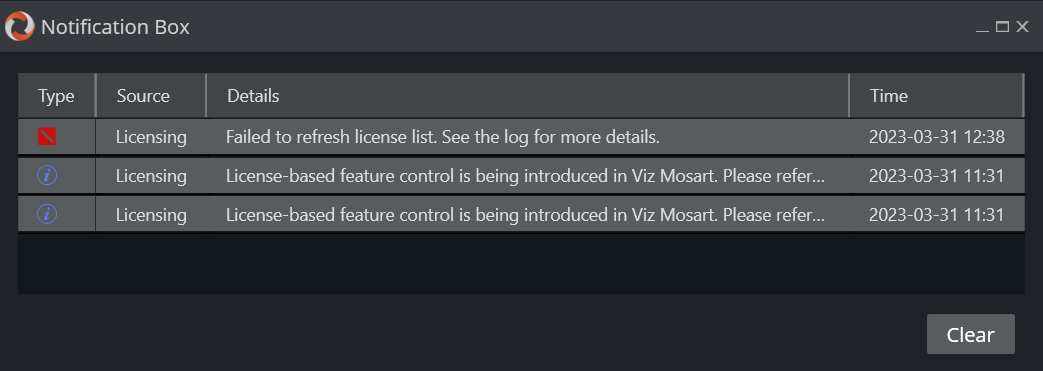

The Notifications icon to the right also appears at the top of all menus. A red marker indicates an unread notification.
  • Clicking the icon. Opens the Notification Box menu, listing important system messages that will usually require action.
