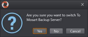

  • Yellow: For Mosart servers, the server is currently in idle mode (standby). This server can be activated by clicking on it. When doing so, the other (active) server is set to idle mode.
  • Grey: For Mosart servers, the connection to the server is currently either not set up, or it experiences a connection error. The Mosart Remote Control Service is possibly not running on the server.
Note: The grey status of the NRCS appears in the GUI if the Viz Mosart server is shut down/restarted.
Clicking the Viz Mosart server currently in standby brings up a pop-up enabling a switch of Viz Mosart servers.

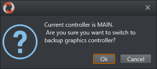

Graphics Controller
For graphics systems supporting graphics control switching, the graphics controller can be switched by clicking the Graphics Controller area.

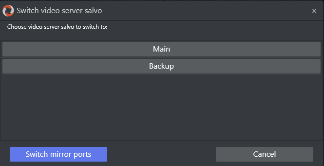

Video server
Salvos
If multiple video server salvos are set up in AV Automation, the operator can switch between them by clicking the Video server area on the status bar.
From the Switch video server salvo menu that pops up, a user can select between the available video server salvos, like Main and Backup in the below example.
Mirror Ports
From the same menu, you can also switch between mirrored video server ports by pressing the blue Switch mirror ports button.
Tip: For further mirroring options, refer to the Mirroring section of the Viz Mosart Administration Guide, under AV Automation > AV Automation Device Properties > Video Servers.
