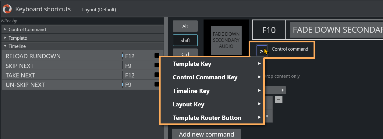

  • You access these settings from the menu bar: Tools > Keyboard shortcuts editor and then selecting Control Command Key from the panel on the right.
Working With Control Commands for a Keyboard

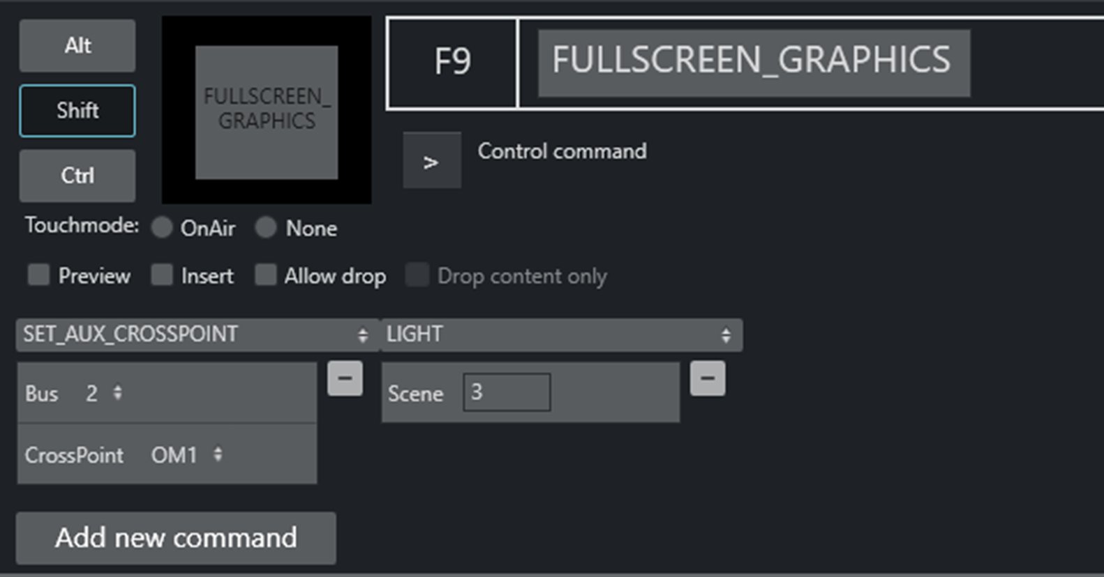

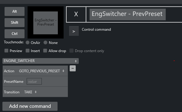

Adding a New Command
To add a new parameter
  1. Refer to the table Keyboard-based Control Command Categories
  2. From the menu bar select Tools > Keyboard shortcuts editor.
  3. Click Add new command to add multiple commands to a shortcut.
    In the figure above, two commands have been added: SET_AUX_CROSSPOINT and LIGHT.
    These commands are executed sequentially from left to right (in the example, first SET_AUX_CROSSPOINT, then LIGHT).

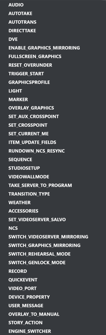

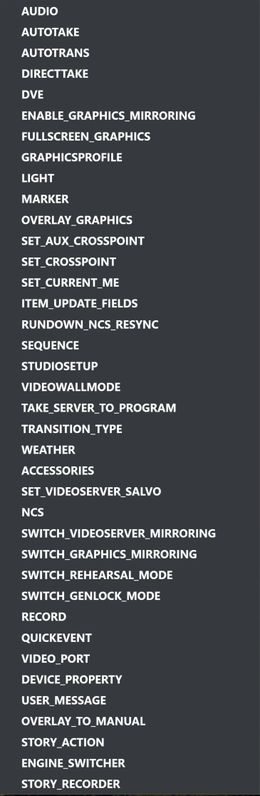

In the Viz Mosart UI, control commands are arranged in categories, based on the key.
The table below refers to commands available per category.
The table below presents the Parameters (command keys) that control what happens when the selected command (in column Command Category and Summary) is run as a keyboard shortcut.

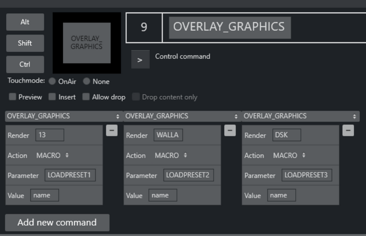

OVERLAY_GRAPHICS
The Overlay Graphics Interface (OGI) provides control and monitoring of overlay graphics for all Viz Mosart-approved graphic engines.
Render: All OVERLAY_GRAPHICS commands share the Render parameter. This parameter can be set to send the given command to a specific engine, or to engines which currently have active graphics On Air, to execute the specific command.
This value can also be non-numeric (Current) or the destination configured in the Overlay Graphics Interface.
In example below, Current was configured to clear the graphics from all the engines.
Alternatively, Engine 1:
For a detailed description, see section Overlay Graphics Interface of the Viz Mosart Administrator Guide.

MACRO
For graphics systems that support macro recall, this recalls a macro on the defined engine/destination.
  • Render: This is typically the engine number from the OGI screen where the status of the devices is displayed. For Vizrt Graphics, the destination defined in the Overlay Graphics Interface (OGI) can also be used.
    When sending a macro command for Vizrt Graphics, Mosart will direct it to the Media Sequencer (MSE), specifying the destination linked to the engine number provided in the command.
    In cases where multiple engines are mapped to the same destination (commonly seen in a mirroring setup), the MSE will send the command to all engines associated with that destination, not just to the engine with the number specified in the command.
Info: For Vizrt Graphics, when multiple controllers are defined in OGI, the engine number shown in the OGI screen is not reliable and instead, the destination should be used.
  • Parameter field is the name of the macro to execute.
Info: For VIZRT graphics, two special macros are available:
  • INITIALIZE (or INITIALISE): Initialize the playlist.
  • CLEANUP: Clear the playlist.

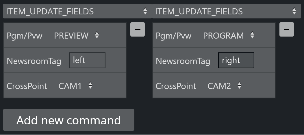

ITEM_UPDATE_FIELDS
Pgm/Pvw: Select PREVIEW or PROGRAM to define the template which will be affected.
NewsroomTag: The newsroom field name that will be affected in the DVE template/boxes.
CrossPoint: Select the crosspoint that will change.
Supports multiple commands of either preview or program, or a combination of preview and program on the same keyboard shortcut.
Update the source (here CrossPoint) assigned to a newsroom tag, for the item in PREVIEW or in PROGRAM.

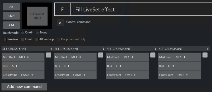

SET_CROSSPOINT
Sets a crosspoint on the vision mixer.
MixEffect:
PP
ME1
ME2
ME3
ME4
M_RIP
M_OTH
Bus: The ME-bus (A, B, C, D or keyers)
Info: Buses C and D are used for video switchers supporting MEs with 4 layers (for example with TriCaster).
CrossPoint: INP1-6.

MIX
Set the transition to be mix with the specified value as number of frames
WIPE
Set the transition to be wipe with the specified value as number of frames
EFFECT
Set the transition to the effect specified by number in the Value field
TOGGLE
Toggle between MIX,WIPE,EFFECT
Value: The transition rate in frames, or the effect number for the mixer effect transition type.
Not used with TOGGLE or CUT.
(Default)
TransitionType: TOGGLE
(cycle through the various transition types)
WEATHER
Controls the timeline of a connected Viz Weather system.
Action:
PLAY
Start the timeline of the weather system.
CONTINUE
When a weather timeline has stop points, send Continue commands to the timeline.
GO TO FIRST
Cue the weather scene to its first page/frame.
ACCESSORIES
Pretakes an accessory.
Action:
TAKE_NEXT
Pretake requires the accessory template to have preload enabled and a primary type to trigger the defined pretake.
Only use accessories with
in-time=0.
SET_VIDEOSERVER_SALVO
Switches to a specified video server salvo.
Salvo: Specify the salvo name.
SWITCH_GENLOCK_MODE
Action:
TOGGLE
Toggle genlock mode.
ACTIVATE
Activate genlock mode.
DEACTIVATE
Deactivate genlock mode.
NCS
Specific control for the OpenMedia newsroom systems.
Action:
START_STATUS
STOP_STATUS
Parameter:
RUNDOWN
STORY
ITEM
SWITCH_REHEARSAL_MODE
Action:
TOGGLE
Toggle rehearsal mode.
ACTIVATE
Activate rehearsal mode.
DEACTIVATE
Deactivate rehearsal mode.
SWITCH_VIDEOSERVER_MIRRORING
Switch mirrored video ports.
Toggles a switch of any mirrored video ports.
SWITCH_GRAPHICS_MIRRORING
Action:
TOGGLE
Toggle mirroring mode for graphics for full screen graphics.
ACTIVATE
Activate mirroring mode.
DEACTIVATE
Deactivate mirroring features.
RECORD
Command:
PREPARE
Cue a recording.
START
Start a recording previously PREPAREd.
STOP
Stop a recording previously STARTed.
DELETE
Recorder: A user-defined name to be used for a recording, tied to ClipName and PortName.
Set in the PREPARE command and then used by the START and STOP commands. A value of Default selects the default recorder.
ClipName:
(PREPARE only): The name of the clip to be created.
Info: It is possible to include the current gallery/studio, template set, and time in the name of the created clip. For details please refer to section Video Server, MAM and Database Connection Strings in the Viz Mosart Administrator Guide (ClipNamePattern property).
 PortName (PREPARE only): The name of the video port where the recording shall take place. Note that this port has to be part of the “Rec” virtual video port group.
Default value is “Rec”.
Recorder: A value of DEFAULT selects the default recorder.
Default value is Rec.
Info: For the setup of recording ports, please refer to section AV Automation Devices Video Servers in the Viz Mosart Administrator Guide.
QUICKEVENT
Command:
NEXT_ITEM
Select the next item (down).
NEXT_GROUP_ITEM
Select the next group-selected item (down).
PREVIOUS_ITEM
Select the previous item (up).
PREVIOUS_GROUP_ITEM
Select the previous pre-selected item (up).
TAKE_SELECTED
Attempt to put the selected item to air.
TAKE_SELECTED_TO_WALL
Takes the selected item to the wall item specified in the parameter. See section Template Router.
{PREVIEW_SELECTED
Attempt to put the current selected item to either the graphics preview engine or the video server preview port (virtual group "P").
Can also insert Preview in the storyline, depending on the type and context.
See also PRELOAD_SELECTED.
PREVIEW_SELECTED_TO_WALL
Put the selected item to the selected wall salvo preview wall item specified in the parameter. See section Template Router.
PRELOAD_SELECTED
Attempt to preload the current selected item to the preload port/engine if available and configured, in AV Automation.
See also PREVIEW_SELECTED.
FILTER_LEFT
Switch the selected filter to the filter displayed to the left of the currently selected filter (this also works in the Quick Access Panel, QAP).
FILTER_RIGHT
Switch the selected filter to the filter displayed to the right of the currently selected filter (this also works in the QAP).
CLEAR_SELECTION
All selected and group-selected marks are removed.
TOGGLE_SELECT
Mark the current item in the list as group-selected. The group selected items can be iterated with NEXT_GROUP_ITEM and PREVIOUS_GROUP_ITEM.
LOWERTHIRD_ACTION_SELECTED
Put the selected lower third in the Quick Access tab based on the (mandatory) value of Parameter.
Parameter:
  • DEFAULT: Take in only
  • AUTO: Take in if not On Air
                Take next continue point if On Air and has continue points
                Take out if On Air and no more continue points
  • CONTINUE: Take next continue point
  • TAKEIN: Take in only (same as DEFAULT)
  • TAKEOUT: Take out (even if there are more continue points left
VIDEO_PORT
Send a specific command directly to a specific video port.
Action: What action to perform on clip assigned to port:
PLAY_PAUSE
Play or Pause assigned clip
STOP
Stop assigned clip
CUE
Cue assigned clip
RECUE
ReCue assigned clip
SET_LOOP
Tells the video player to loop the current clip
PLAY_TAIL
Skip to end of clip and start playing. Specify a Parameter (see below).
CUE_TAIL
Same as PLAY_TAIL but does not start to play.
VideoPort: Name of the video port for sending commands to.
Parameter: Used for PLAY_TAIL and CUE_TAIL commands.
Specified length from end or start of clip to skip to. Use negative number to count from end.
For example, -10 to skip to 10 seconds before end of clip. Used for rehearsal.
Tip: For additional control possibilities, refer to the section Video Port Control Commands.
Not applicable for all video servers, behavior varies depending on video server type.
Is not visible in the rundown (only visible in Template Router)
DEVICE_PROPERTY
Parameter1:
AUDIO
CAMERACONTROL
Parameter2: String variable
Parameter3: Additional optional control value
USER_MESSAGE
Generate an arbitrary logging message
Message:
Insert a simple log message to inject into logging when this button is pressed.
When activated, adds the specified text string to all connected logs.
This is useful for the operator in fault-finding situations, where, a known message string can be pushed into the log, for example, at the point of a troublesome production situation.
OVERLAY_TO_MANUAL
Convert all lower thirds(overlays) to manual for the current, preview or selected story.
The control command OVERLAY_TO_MANUAL has three optional parameters:
Target: The type of story to be converted
SELECTED
(default)The selected story in the GUI.
PREVIEW
The next story
ONAIR
The on air story
Handlers: Comma-separated list of handler names.
Empty list means all handlers.
Example: WALL,DSK.
TakeOutMethod: Method for the converted overlays to be taken out.
AUTOMATIC (default)
  • MANUAL
    Converts all lower-thirds in the specified Target with the specified Handlers to MANUAL.
    - If no handler name is specified, it converts all lower-thirds in Target to MANUAL.
    If TakeOutMethod is set to MANUAL, the converted overlays also have to be taken out manually. Otherwise they are taken out (automatically) after the specified duration.
Defaults:
Target: SELECTED
STORY_ACTION
Invoke an action on a target story.
Target: The type of story to be converted, either:
SELECTED
(default) The selected story. Used for GUI.
PREVIEW
The next story
ONAIR
The on air story
Action:
TOGGLE_COUNT_DOWN_TO
(Not available for ONAIR) Toggle the target story count down to the target story.
SET_AS_NEXT
(Not available for PREVIEW or ONAIR) Set the target story as next.
SET_AS_NEXT_AND_SKIP
(Not available for ONAIR) Set the target story as next and skip any remaining items.
TOGGLE_LOCK
Toggle the lock story from NCS update on the target story.
REMOVE
(Not available for ONAIR) Remove the target story.
LOOP_START
Set the start loop at the target story.
LOOP_END
Set the end loop at the target story.
LOOP_CLEAR
Clears any loops in the rundown.
APPEND_ITEMS_TO_CURRENT
Take all items of target story and append them after the current on air item.
This command can replace functionality in the Story context menu with a shortcut.
Can only be used from the Viz Mosart UI.
ENGINE_SWITCHER
Action:
INIT
Reset the Engine Switcher status. Typically used at rundown reload.
PRESET_STYLE
Jump back to the previous preset.
GOTO_PREVIOUS_PRESET
Toggle between the last preset applied and the previous one.
PresetName:
Name of Preset, created in Viz Engine.
Transition:
CUT
TAKE
STORY_RECORDER
See section Story Recorder.
RESET_OVERUNDER
Resets the Rundown Over/Under timer to 00:00.
TRIGGER_START
Plays the cued clip from the taken template that had TRIGGER START enabled in the video server device.
