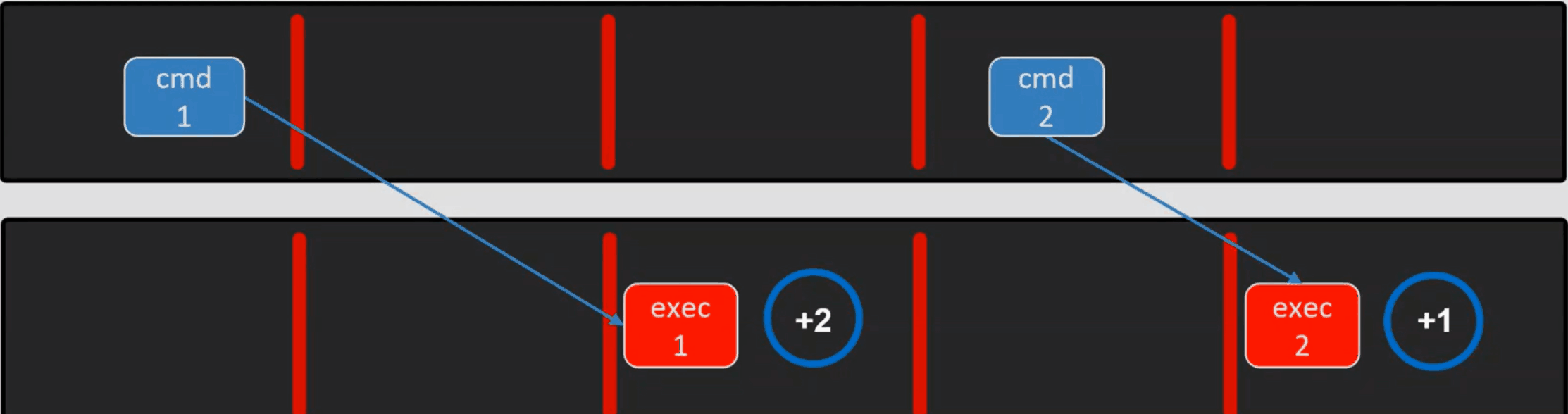

Unless it is known where in the frame the Viz Mosart command is issued, the response from the equipment will always be arbitrary.
In the figure below, the red bars represent the start of a frame. The outgoing Viz Mosart commands (cmd 1, cmd 2) are now aligned with the start of the frame grid (frame accurate).
Tip: The illustrations in this section are animated. If you are viewing a PDF, we recommend the HTML version of this document, the latest can always be found online from here.
This provides deterministic behavior from the controlled equipment, as the equipment is always given exactly the same amount of time to respond (in the above figure, after one frame).
Without frame accuracy, cmd 1 might be fired already somewhere in the first or second frame above, and the gear will not operate at the anticipated frame, giving unpredictable results.

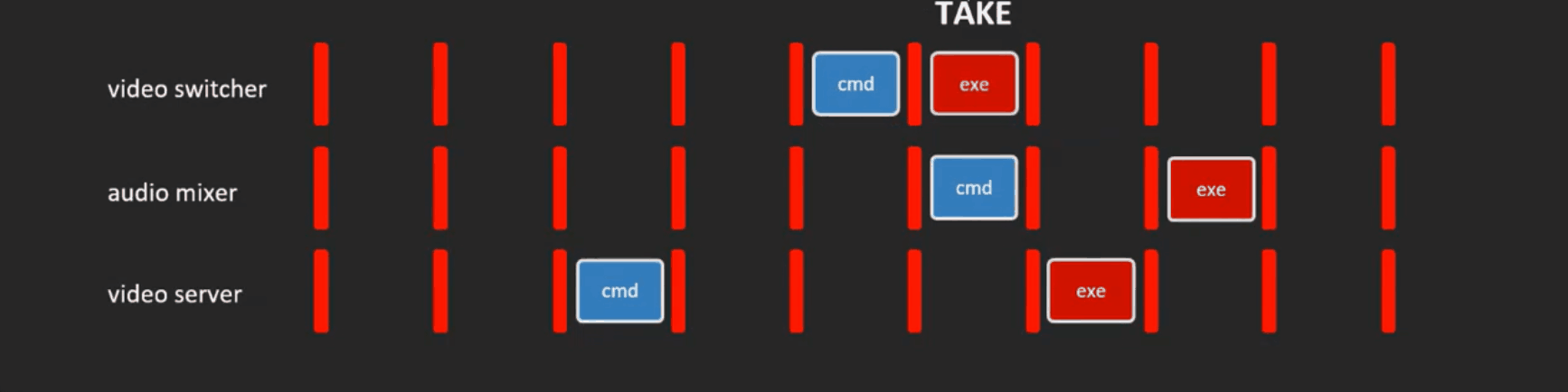

Latency Compensation
In non-frame accurate systems, Viz Mosart only compensates for delays in the behavior of the playout video server.
With frame accuracy, Viz Mosart can compensate for any latency of the controlled equipment.
As a pay-off of Predictable Behavior of Equipment, a calibration process can reveal the latency of each piece of gallery equipment.
Viz Mosart can then compensate for these delays, by always executing commands earlier.
In the figure above, the three devices (video switcher, audio mixer and video server) have millisecond latencies of 1, 2 and 3 frames respectively.
After compensating by executing each command specifically earlier, Viz Mosart can now successfully perform the TAKE command, synchronized for all three devices, from the same frame.

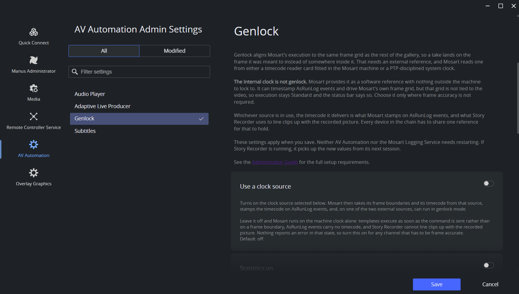

Frame accuracy settings are made in Viz Mosart Central Settings.
In AV Automation, open Central Settings, then select AV Automation > Genlock. The Genlock tab under Devices > Properties links to the same place.
Set

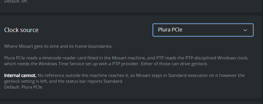

Use a clock source: switch on, then set Clock source to the clock the machine uses. Plura PCIe is the default. Select PTP if the Windows system clock is disciplined to a PTP grandmaster (Viz Mosart 5.15.0 and later).
Genlock mode: switch on. Genlock needs an external reference, so this is available on Plura PCIe and PTP only, and is hidden while the clock source is Internal.
Calibration: the individual latencies of the gear being controlled, as derived when calibrating the system. Each accepts a value from 0 to 100.
Click Save.
The changes apply immediately if Story Recorder mode is not enabled. There is no need to restart AV Automation or the Mosart Logging Service. If Story Recorder is enabled, the settings are taken into consideration in the next Story Recorder session.
Central Settings can be opened from Manus Administrator and Media Administrator as well, and a save there reaches AV Automation the same way.
Combinations of Genlock mode and Clock source:
Genlock mode | Clock source | Logic |
Off | Not in use | Classic mode. No timecode in the Viz Mosart logs. No statistics can be performed. |
Off | Plura PCIe or PTP | Classic mode. Timecode from the selected clock source is written in the Viz Mosart logs generated from AV Automation. |
On | Plura PCIe or PTP | Frame accurate behavior when executing Viz Mosart templates during a show. Timecode from the selected clock source is written in the Viz Mosart logs, generated from AV Automation. Viz Mosart falls back to the internal clock source if the selected clock source is detected as inaccurate. |
On | Internal | Not possible. The Internal clock is a software reference with nothing outside the machine to lock to, so it cannot drive genlock. Viz Mosart stays in Standard execution and the status bar reports Standard. Genlock mode is hidden while this clock source is selected, and switched off on save. |
On | Not in use | Not allowed. Viz Mosart will fall back to Standard execution mode, with no timecode. |
Genlock mode: switch off.
Use a clock source: switch off.
Click Save.

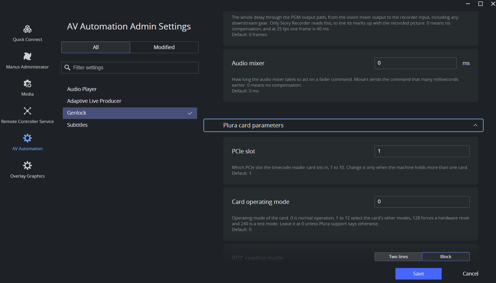

The properties of the Plura timecode reader card are set in Viz Mosart Central Settings, under AV Automation > Genlock, in the Plura card parameters section. The section appears only while the clock source is Plura PCIe.
To configure the Plura timecode reader card
Expand Plura card parameters and set the PCIe slot, the card operating mode, the VITC reading mode and line range, the reader priority, the timecode frame rate, and whether mid-frame events are raised. The defaults suit a standard installation; change them only when the card is fitted or fed differently.
Click Save. The card is reconfigured without restarting AV Automation.

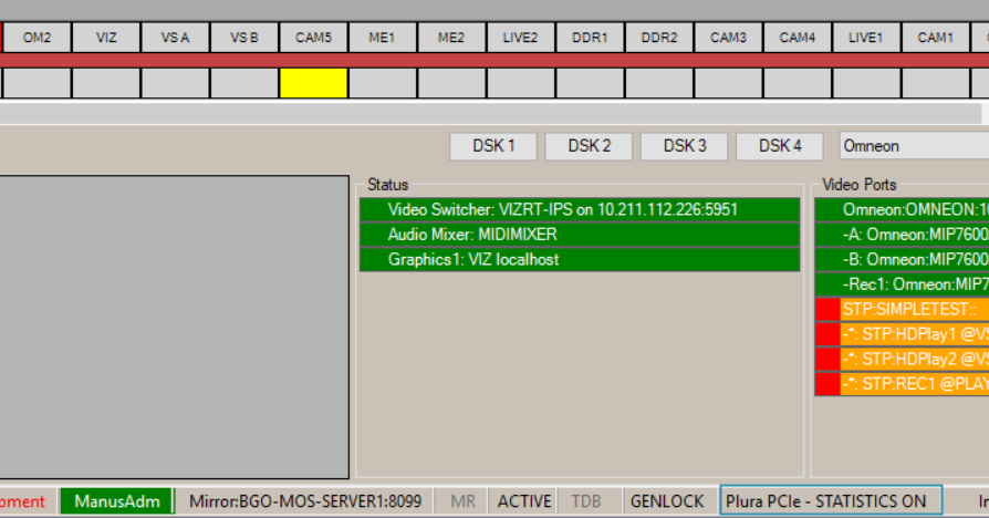

Check the indicator in the AV Automation status bar at the bottom of the screen, that statistics are on:
