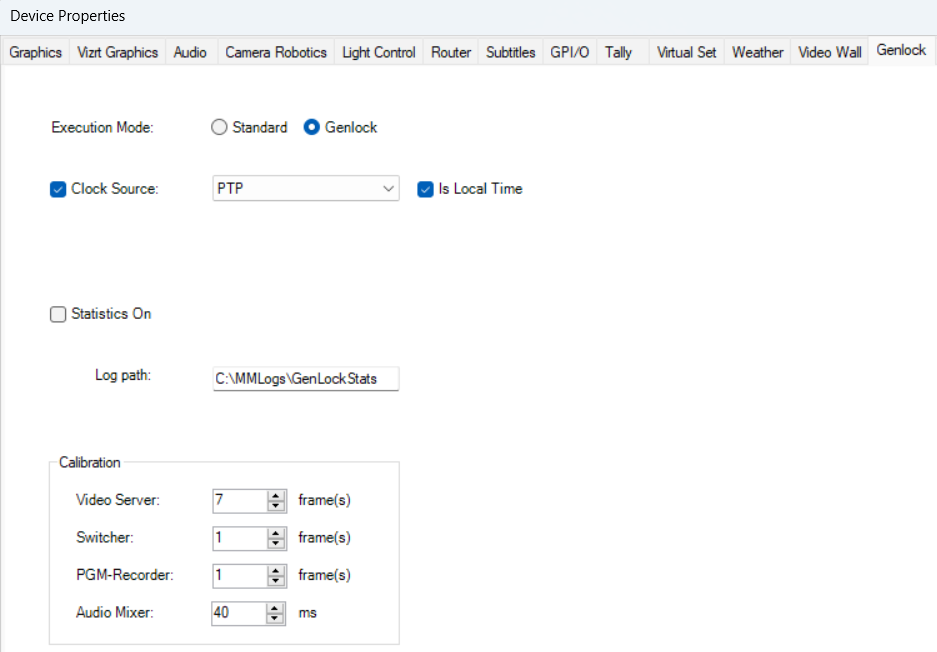

Viz Mosart Genlock Settings
In AV Automation, go to Devices > Properties > Genlock and set Viz Mosart in Genlock mode. Then set the clock source to match the route you run, either the Plura card or PTP.
Enter the latencies measured by the tests described here on the AV Automation Genlock tab, in the Calibration box.
The four fields in the Calibration box are:
Field
Measured by
Unit
Video server command latency
Test A2 or B2
Frames
Switcher command latency
Test A3
Frames
PGM-Recorder latency
Test A4
Frames

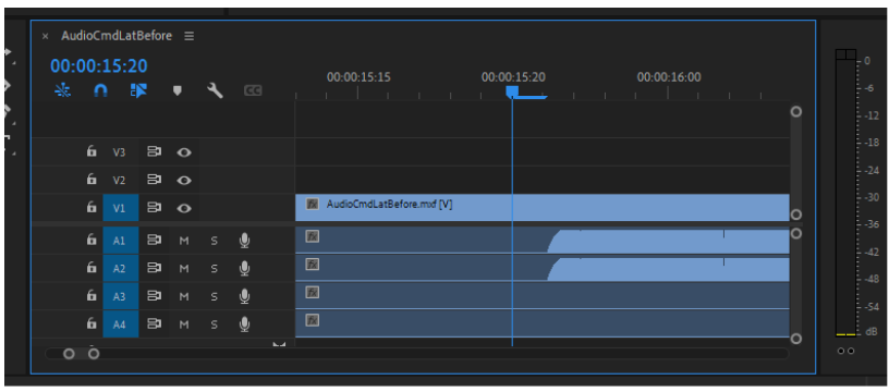

Audio mixer command latency
Test A6
Milliseconds

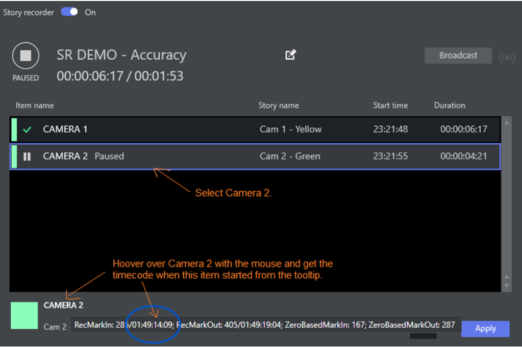

For Story Recorder users only, set the video recorder to an I-frame only format for the intermediate recordings. This works around some issues with long-GOP format recordings. It has no impact at all on the final, consolidated show clips.

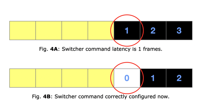

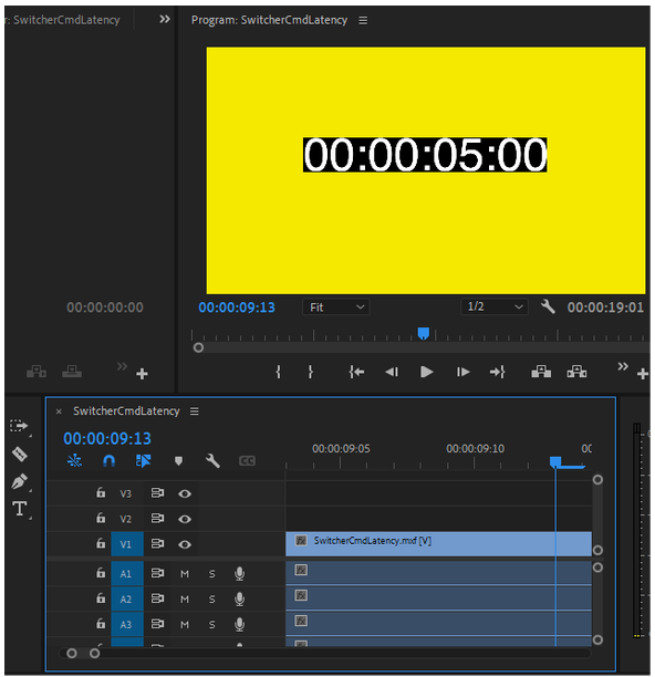

A3
A2 (not B2)
Mobile phone or recorder
1 frame
The time it takes the video switcher to respond to a cross point switch command.

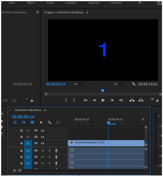

A5
Recorder, NLE
Audio and video lip sync
Optional
Test of audio-video lip sync offset as set up in the server room.

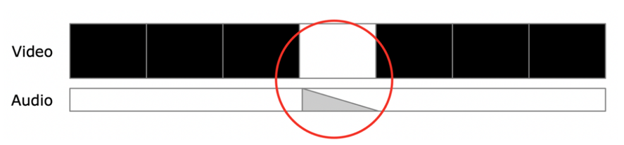

A6
A2 and A3
Recorder or Story Recorder, Clip Tool or NLE
0 ms
The time it takes the audio mixer to respond to a fader command.

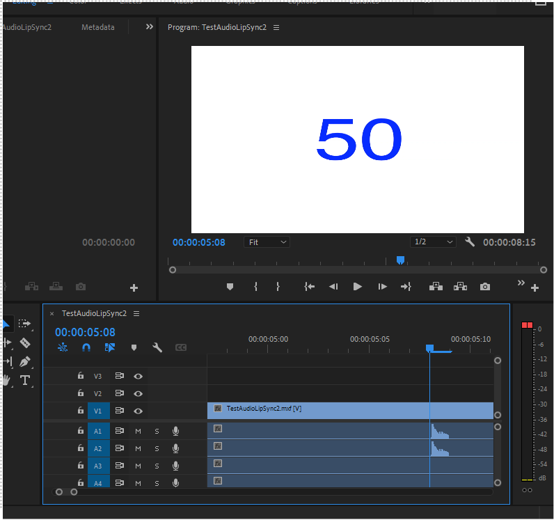

  • The white frame in WhiteBlack-Clapper-Num is exactly one frame.
  • No audio fade at the head of Pink-Sine-TC. A6 measures audio onset against the first pink frame, so an encoder-added ramp silently corrupts the result.

Rundown Calibration-A3
  1. Camera
  2. Clip Yellow-Silent-TC, auto-take 5s, A/B roll.
  3. Clip WhiteBlack-Clapper-Num, A/B roll.

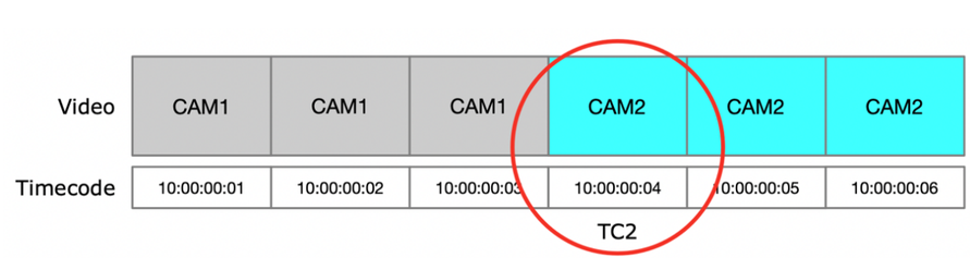

Rundown Calibration-A4
  1. Camera 1
  2. Camera 2, with a visually different feed than Camera 1.
Rundown Calibration-A5
  1. Camera
  2. Clip WhiteBlack-Clapper-Num, A/B roll.
  3. Camera.

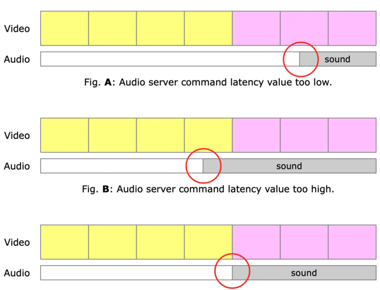

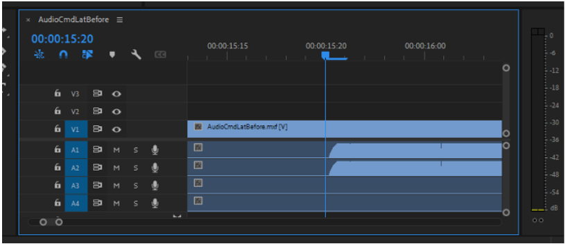

Rundown Calibration-A6
  1. Camera
  2. Clip Yellow-Silent-TC, A/B roll, fader with audio ripple, crossfade in/out set to 0, autotake 5s.
  3. Clip Pink-Sine-TC, A/B roll, fader with audio ripple, crossfade in/out set to 0.

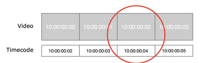

Calibration A1: Recorder in-out Latency (optional)
This test is optional, but still recommended if you have the required gear available.
The video recorder is required in several calibration tests, and in some of these it is important to know whether the video recorder introduces any in-out (throughput) latency. For example, if the recorder is recording a clapper board hit at a given timecode, will it show up in the recording at the same timecode, or a few frames later?
A professional video recorder normally has zero in-out latency, and your recorder will likely behave the same. If in doubt, perform the test.
What is the plan?
Connect a feed with burned-in, actual house clock timecode directly to the recorder input and make a short recording. No Viz Mosart is involved here. Then check the recording and compare the difference between the burned-in timecode and the recorder's own timecode track. The difference is the recorder latency.
Setup
This test is somewhat demanding in terms of gear. You need a feed showing the live house clock timecode burned in. This can be achieved in several ways:
  • A zero-latency camera pointed at a zero-latency timecode display.
  • A zero-latency camera with built-in timecode display.
  • A device such as a Rubidium, emitting an SDI feed with zero-latency burn-in timecode.
Some re-cabling is also needed for this test.
Test material and gear
  • Timecode feed as described above.
  • The video recorder being tested, properly set up with genlock and timecode.
  • A tool to inspect the recorded video, such as Harmonic's Clip Tool.
Test
  1. Connect the timecode feed directly to the recorder input.
  2. Make a recording a few seconds long.
  3. Inspect the recording using Clip Tool (or similar).
  4. Establish the difference in frames between the burn-in timecode shown in the video area and the timecode associated with the frame (from the recorder's timecode track). In the figure below, the latency found is 2 frames.
  5. Remember this latency as the recorder in-out latency. It is needed later.
In the example above, the 10:00:00:02 timecode from the feed being recorded is matched with a 10:00:00:04 timecode from the video recorder's own timecode track. The recorder in-out latency here is 2 frames.

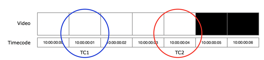

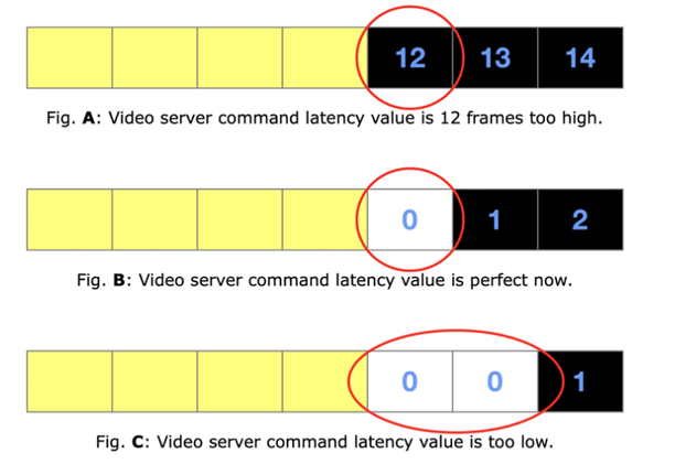

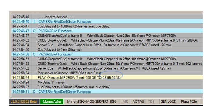

Calibration A2: Video Server Command Latency
This test measures the video server command latency, which is the time it takes the video server to respond to a play command, expressed in frames. Perform the test for each of the individual video server ports involved in the playout of rundown clips.
What is the plan?
Cue a clip in the video server that starts with a single white frame, followed by black frames. At a known timecode, Viz Mosart instructs the video server to play the clip while the playback port is being recorded. Check the recording and look for the recorder timecode associated with the last white frame, which is the first frame being played. The difference in timecodes is the latency.
Setup
This setup needs some re-cabling. To measure the latency of playout port A, for example, use a cable to connect port A directly to the recorder input. Re-cable to test the other ports.
  • Rundown: Calibration-A2. See Rundown recipes above.
  • A video recorder. If you do not have a recorder, run alternative test B2 instead.
Test
  1. Cable the port being tested directly to the recorder input.
  2. On the AV Automation Genlock tab, set video server command latency to 0.
  3. Load rundown Calibration-A2.
  4. Start the recording.
  5. Start the rundown and run story by story.
  6. A few seconds into the clip, stop the recording.
  7. In the AV Automation Log area (see Figure 3 below), look up the timecode for the moment the video was started. Call this TC1 (the blue circle in Figure 2 below).
  8. In the recording, using Clip Tool or similar, look up the timecode of the last white frame. This is TC2 (the red circle).
  9. The command latency for this port is the difference in frames between TC1 and TC2. In the figure below, that is 3 frames of latency.
  10. If you measured the recorder in-out latency, subtract that value from the latency found in the previous step.
  11. On the AV Automation Genlock tab, set video server command latency to the latency found.
Repeat this test several times for the same port, to check for consistent behavior. Then repeat the test for each of the playout ports.
Info: All playout ports must have identical latency values.
Calibration A3: Switcher Command Latency
This test only makes sense, and only produces a reliable result, if you were able to run the recommended test A2 beforehand rather than the less preferred test B2. If you had to use test B2, which assumes a switcher command latency of 1 frame, skip test A3 and keep the 1 frame value.
This test measures the switcher command latency: the time it takes the switcher to respond to a cross point command, expressed in frames.
What is the plan?
While a yellow clip is playing, cue and start a second clip with burned-in increasing frame numbers (0, 1, 2 and so on) that starts playing with frame #0 exactly at the take point. Video server latency was measured in the previous test. At the same time, open the cross point for the clip and record the PGM output. If frame #2 shows as the first frame of the clip instead of the expected #0, the switcher has a 2-frame command latency.
  • Rundown: Calibration-A3. See Rundown recipes above.
  • A mobile phone or video recorder for recording the PGM output, for example using AV Automation or Harmonic's Clip Tool to start the recording on the video server.
Test
  1. Make sure cabling is restored to normal.
  2. On the AV Automation Genlock tab, set switcher command latency to 0.
  3. On the AV Automation Genlock tab, make sure that video server command latency is calibrated and specified.
  4. Load rundown Calibration-A3.
  5. With a mobile phone or recorder, record a video of a monitor showing the PGM output.
  6. Start the rundown.
  7. Stop the recording once the rundown is completed.
  8. In the recorded video, locate the first non-yellow frame. The big blue number shown is the latency. See Figure 4 below as an example.
  9. On the AV Automation Genlock tab, set the switcher command latency value to the number found.
  10. To confirm, repeat the test from step 4.
  11. The first non-yellow frame should now be a white frame with a big blue 0, as shown in Figure 4B below. Success.
Repeat this test at least 5 times. All tests should result in the same latency value.
Calibration A4: PGM-recorder Latency
Info: This test is relevant for Story Recorder users only.
This test measures PGM-recorder latency, which is the sum of in-out latencies from the vision mixer, any additional gear in the PGM output path, and the in-out latency of the video recorder used for Story Recorder.
What is the plan?
In Story Recorder, take Cam1 followed by Cam2 while recording the PGM output. Use the Story Recorder panel to get the house clock timecode for when Cam2 was taken. Then check the recording, locate the cut to Cam2, and find the recorder timecode for that moment. The difference between the two timecodes is the PGM-recorder latency.
  • Rundown: Calibration-A4. See Rundown recipes above.
  • Two camera feeds.
  • Story Recorder's video recording feature.
Test
  1. On the AV Automation Genlock tab, make sure the switcher command latency value is calibrated and specified.
  2. Load rundown Calibration-A4.
  3. Enable Story Recorder. Wait for it to enter Record mode.
  4. Start the rundown.
  5. Once the rundown has ended, pause Story Recorder.
  6. In the Story Recorder panel on screen (see Figure 7 below), locate the timecode of the take of Camera 2. Call this TC1 (the blue circle).
  7. Using Clip Tool or similar, load the recorded clip and locate the hard cut from cam1 to cam2.
  8. Note the recorder timecode of the first frame of the Camera 2 take. Call this TC2 (the red circle).
  9. On the AV Automation Genlock tab, set PGM-recorder latency to the number of frames between TC1 and TC2.
Calibration A5: Audio and video lip sync (optional)
Info: This test is optional and is defined here for completeness, as this has probably already been taken care of in your setup.
This test checks the lip sync relation between video and audio as found on the PGM output. The goal is to have audio and video perfectly in sync, even before Viz Mosart comes into play.
What is the plan?
Play a clapper-board style clip into an open cross point with open audio faders, record the PGM output in a video recorder, and check the result. This does not test Viz Mosart, only the PGM signal.
  • Rundown: Calibration-A5. See Rundown recipes above.
  • A video recorder for recording PGM.
  • A professional NLE such as Premiere Pro or Final Cut Pro.
Test
  1. Load rundown Calibration-A5 and Set as Next the clapper clip, if this is not the first story in the rundown. This cues the clapper clip on PGM.
  2. Observe which port is cued on PGM.

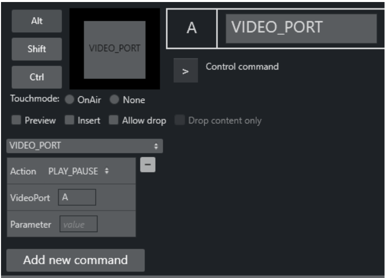

  3. Prepare a keyboard shortcut (see Figure 10 below) instructing the video server to play the clip on the port cued on PGM.
  4. Open the audio fader for the same port in the AV Automation UI.
  5. Start the recorder.
  6. Press the keyboard shortcut to start the clip.
  7. Stop the recording after about 10 seconds.
  8. Using an NLE (or other reliable software), check whether video and audio are in sync. The clapperboard sound should start within the white frame, close to the start of the white frame. See the figure below.
If audio and video are not in sync, tweak the server room gear accordingly and repeat the test until satisfied.
Calibration A6: Audio mixer command latency
The goal of this test is to measure audio mixer command latency: the time it takes the audio mixer to respond to a fader command.
What is the plan?
Take a silent yellow clip, followed by a pink clip with full sound right from the first frame, while PGM is recorded. Looking at the cut in the recording using a quality NLE, audio should show up exactly at the start of the first pink frame. Any audio mixer command latency makes the audio show up delayed compared to the first pink frame.
  • Rundown: Calibration-A6. See Rundown recipes above.
  • A video recorder recording the PGM output. Story Recorder works too.
  • Harmonic's Clip Tool, or a serious NLE such as Premiere Pro or Final Cut Pro.
Test
  1. On the AV Automation Genlock tab, make sure that video server command latency is calibrated and specified.
  2. On the AV Automation Genlock tab, make sure the switcher command latency value is calibrated and specified.
  3. On the AV Automation Genlock tab, make sure the audio command latency value is set to 0 ms.
  4. Start the video recorder to record the PGM output.
  5. Start the rundown and take story by story.
  6. Once the rundown has ended, open the recorded video in Clip Tool or an NLE.
  7. Find the location in the recording where the silent yellow clip cuts into the pink clip with sine wave sound. The audio should start right at the first pink frame.
  8. Using Clip Tool or the NLE, find out where the audio really starts relative to the first pink frame. Do this by ear, stepping through the frames, or visually, by looking at the audio track in the NLE.
  9. If the audio is late, increase the audio mixer command latency setting on the AV Automation Genlock tab and repeat the test. See Figure 13 below.
  10. If the audio is early, decrease the audio mixer command latency setting and repeat the test. See Figure 14 below.
  11. If the audio starts at the beginning of the first pink frame, the test is successful.
Repeat the test several times to confirm consistent behavior.

Calibration B2: Video server command latency
This test is an alternative to the recommended A2 test.
This test measures the video server command latency, which is the time it takes the video server to respond to a Play command, expressed in frames. Perform the test for each of the individual video server ports involved in the playout of rundown clips.
Test A2 is preferred over this one, because this test depends on the switcher command latency while that value has not been calibrated yet. Instead, this test assumes a switcher command latency of 1 frame, which is a good guess. Use this test if you cannot run test A2, which requires a video recorder.
What is the plan?
Take a yellow clip, followed by a black clip with numbered frames, where the first frame is white. Record the session on a mobile phone from a monitor. Set the video server latency initially very high, which causes Viz Mosart to wait too long for the clip to play. As a result, the video server is already playing well into the clip once it is taken on PGM. The number in the first non-yellow frame in the recording indicates how many frames were waited too long.
  • Rundown: Calibration-B2. See Rundown recipes above.
  • A mobile phone for recording the PGM output from a monitor.
Test
  2. On the AV Automation Genlock tab, set the video server command latency to 20 frames.
  3. On the AV Automation Genlock tab, set the switcher command latency to 1 frame.
  4. With a mobile phone, record a video of a monitor showing the PGM output.
  5. Load and start the rundown. Take story by story until the last one.
  6. Once you see the blue numbers on the black background, stop the video recording.
  7. On the phone, find the very first non-yellow frame in the recorded video. It shows a number, for example 12. This is the number of frames waited too long for the video server. See Figure 15A below.
  8. On the AV Automation Genlock tab, set video server command latency to 20 minus the number found. In this example, that results in 8.
  9. Reload the rundown and repeat the test.
  10. The first non-yellow frame should be a single white frame, followed by black frames, as shown in Figure 15B below. In all other cases the test failed, so retry.
Repeat this test for the other video ports involved in video playout, by changing the templates.
Note: All these ports should produce the same latency value.
Having found the latency value, repeat this test a few more times to confirm consistent behavior. In all cases a single white frame followed by black frames should be the result.
