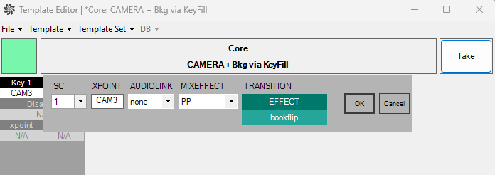

A KeyFill command can set the content for any superchannel and as such, the background content as well. Read more on the next section, Composing a DVE layout box.

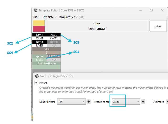

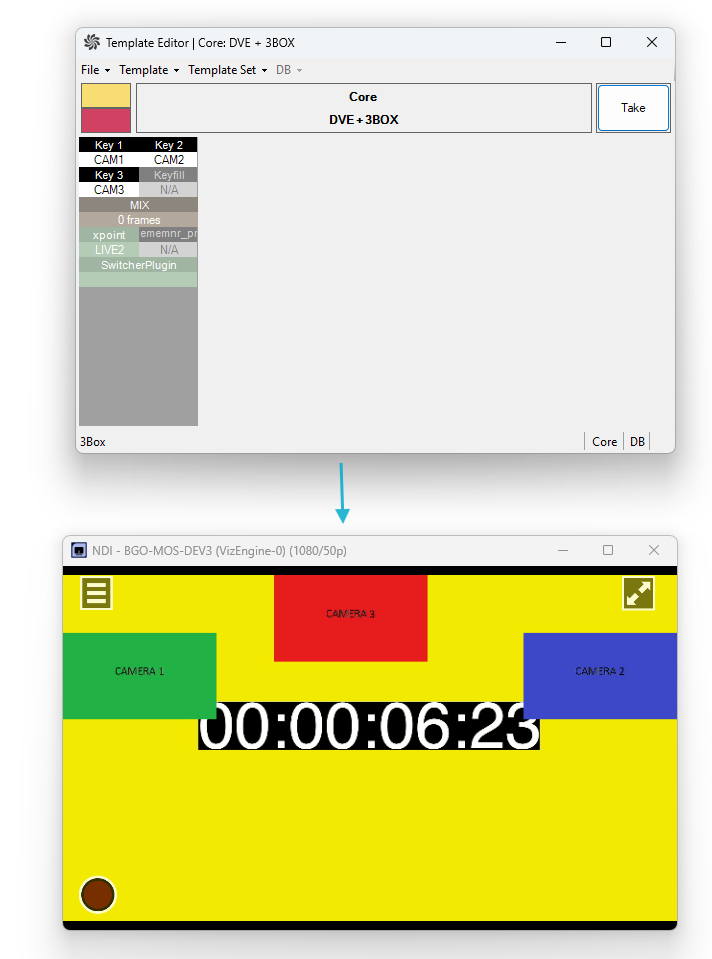

A DVE needs two separate things, and Mosart sets them independently.
A preset (1Box, 2Box, 3Box, and so on) defines the layout only: which superchannels are visible and where their boxes sit on screen.
The content of each box is set per superchannel.
The background (SC1) from a Switcher Crosspoint (or a KeyFill).
Each box (SC2 and up) from a KeyFills command.

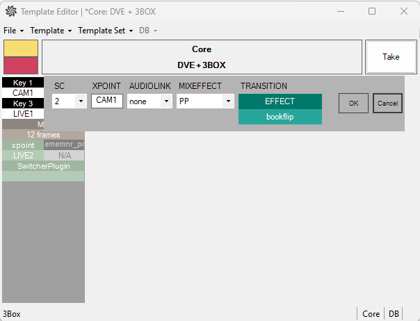

A KeyFills command sets the content on the keyer superchannels (SC1 and up) of a mixer effect. Use this, for example, to build a DVE box layout directly on PP. For ALP, each KeyFill row can carry its own transition, set in the TRANSITION column of the KeyFills dialog: a Mix with a rate, or a named Effect from A/V Setup. See Transitions for how each option behaves on air.
For ALP you can now also use a KeyFill to set the content for the background (SC1).
Note. A KeyFill transition plays through the cue-then-take (rundown) flow. A direct or un-cued take of a KeyFill source uses a hard cut.

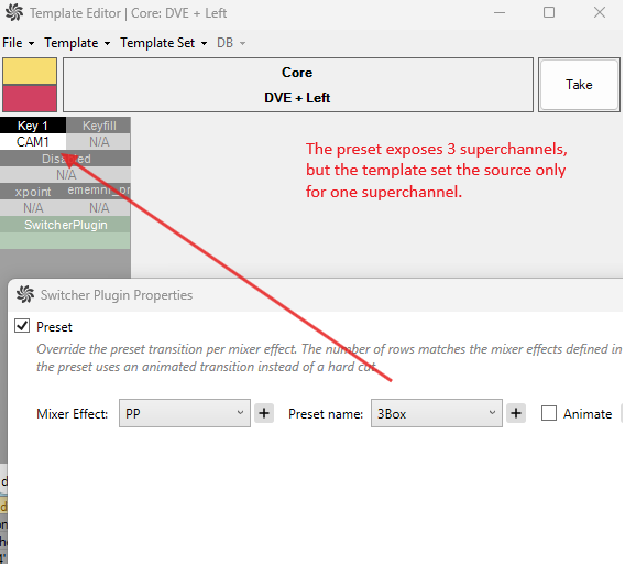

The property KeyEnable for a KeyFill which controls a keyer visibility on a traditional switcher is not available for ALP. In other words, the superchannel visibility can not be controlled with the KeyEnable property. Content on a superchannel is visible only when the active preset exposes that superchannel. A template with KeyFills on SC2 and SC3 but no preset shows nothing while the current preset is 1Box. Set the preset on the same template, or from a previous take, so the KeyFill content appears.
The opposite case matters too: a preset can expose more boxes than the template fills. A preset only reveals whatever content is already on the superchannels it shows, so a box you do not set keeps the content left there by an earlier take.
Note: Fill every box that the preset exposes.
Any superchannel you leave unset keeps its previous content, and that old content goes on air.
A template that takes a preset must set the content on every superchannel that preset shows.
Example
This preset shows the background plus three boxes:
Region in the layout | Superchannel |
2, left box | SC2 |
3, right box | SC3 |
4, top box | SC4 |
A template that selects this preset but sets a KeyFill only on SC2 (for example CAM1) leaves SC3 and SC4 untouched. On air, SC2 shows CAM1, while SC3 and SC4 still show whatever was last set on them, which may be stale content from a previous story.
To get a predictable look, set content for SC1, SC2, SC3, and SC4 on the same template.
In the Template Editor, an
N/Aon a KeyFill row means no content is set for that superchannel, so its box keeps its previous content.

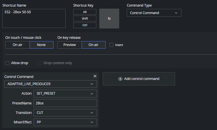

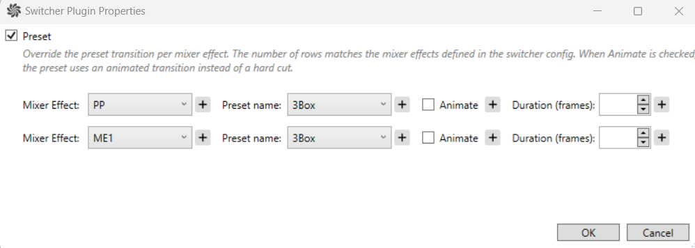

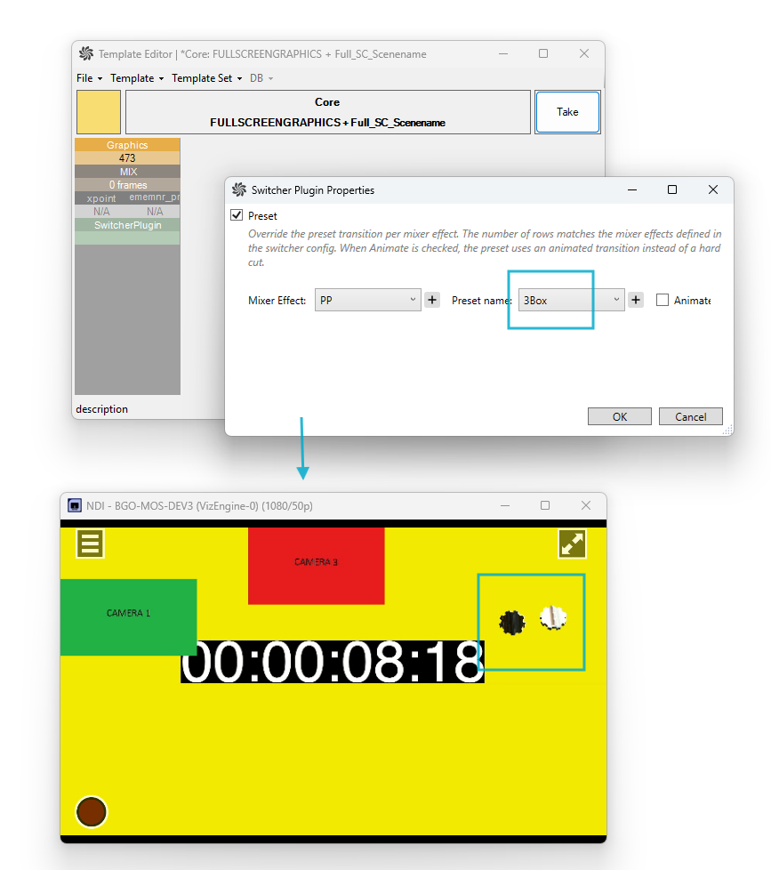

To select a preset for a template, add a Switcher Plugin device command.
To create a Switcher Plugin device command
Open the Switcher Plugin Properties dialog and configure:
Preset: Check to enable a preset override for this template.
Mixer Effect: Select the mixer effect (PP, ME1, and so on) corresponding to the Viz Engine instance where the preset will be set.
Preset name: Select the preset from the Engine Presets list (for example 2Box).
Animate: Check to make the preset use the animated transition as designed in the scene, instead of a hard cut.
Duration (frames): Animation duration in frames (applies only when Animate is checked).
The number of rows matches the mixer effects defined in the driver config. Each row independently controls one mixer effect.

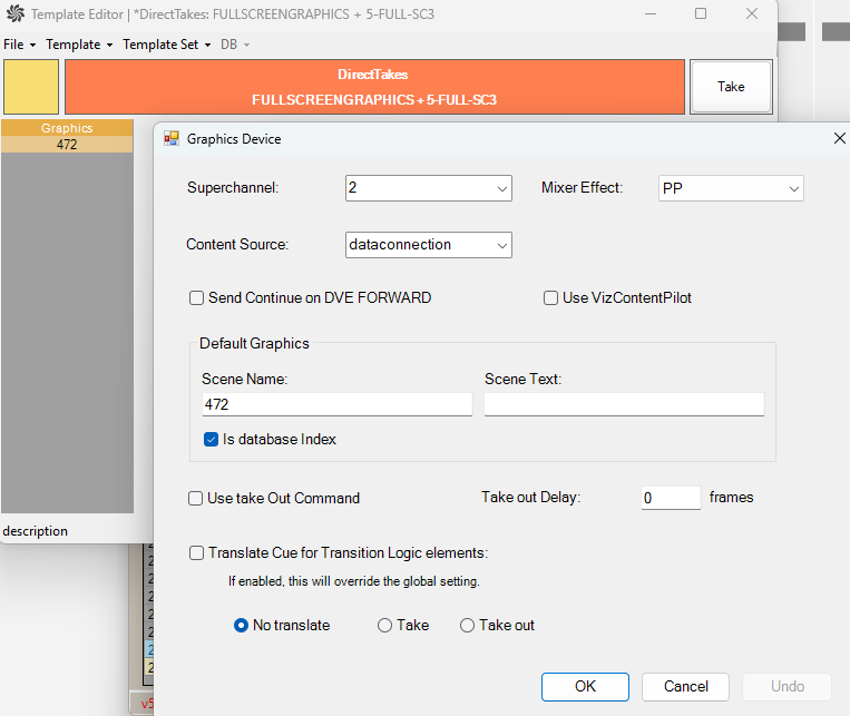

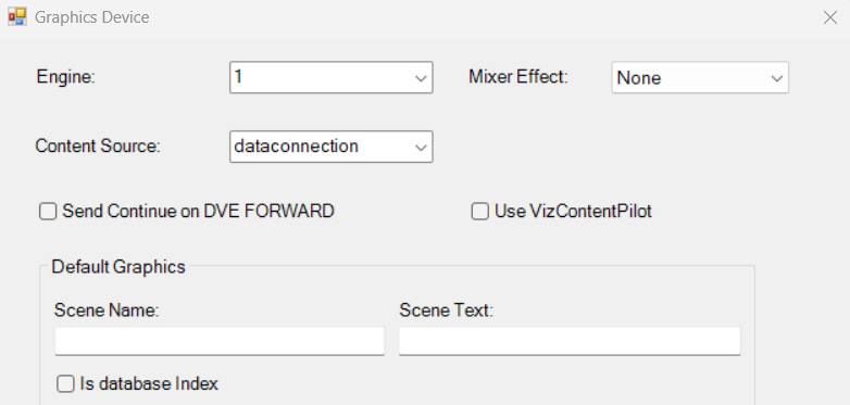

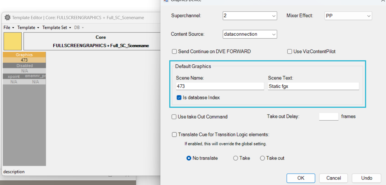

To take graphics on any superchannel of an ALP, add a Graphics device command on the template. In the Graphics Device dialog, select the Superchannel and Mixer Effect where the graphic should appear. For a fullscreen graphic on the main output background, set Superchannel to 1 and Mixer Effect to PP. No Switcher Crosspoint is needed on the template (as required when working with a traditional switcher), only the Graphics device command.
Graphic content can come from two sources:
NRCS: A Pilot Edge MOS object placed in the story after this template. The graphic content loads from the newsroom system.
Static graphic: Enter the graphic ID in Scene Name field and check: Is database Index.

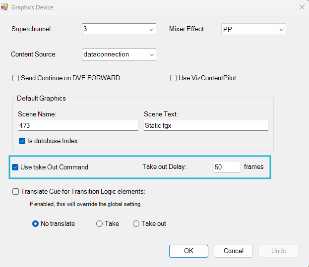

To add a graphic on the boxes of a DVE (for example 3Box), add a Graphics device command and select the Superchannel on the Mixer Effect where the graphic should appear. Provide the graphic ID in Scene Name with Is database Index checked, or provide content from the NRCS on a story containing this template followed by a fullscreen graphic MOS object.
Note: Keep the layout when taking a graphic on a superchannel.
A graphics template with no Switcher Plugin applies the default preset configured in the switcher settings, because a preset must be loaded before a superchannel can show the graphic.
If you are on air with a DVE layout such as 3Box and the next template takes a graphic on a superchannel, the layout resets to the default unless the template keeps the same preset.
To take the graphic without changing the layout, add a Switcher Plugin to the template set to the same preset that is on air (3Box in this example).
In the example below, a a 3Box layout is onair and next a graphic is taken on superchannel 3. To preserve the layout, a Switcher Plugin was added to set the same preset as currently onair.

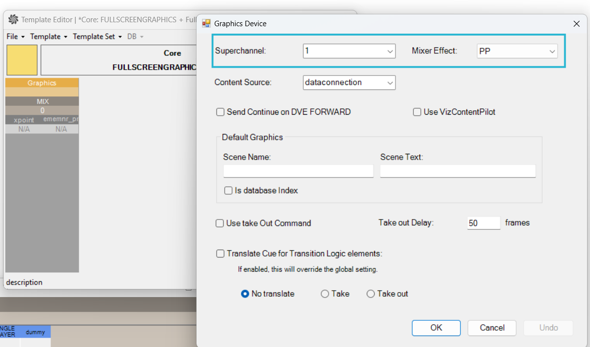

To control graphics content transition

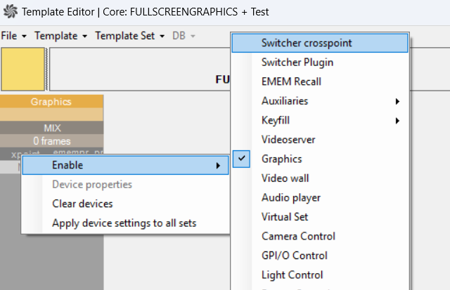

For now, only the content transition for superchannel 1 can be controlled from Mosart templates when taking graphics as content.
Configure a Graphics Device and select Superchannel 1.
Add a Switcher crosspoint to enable the transition.
Disable the Switcher crosspoint as this is not needed.
Configure a transition or let Mix 0 for a hard cut.

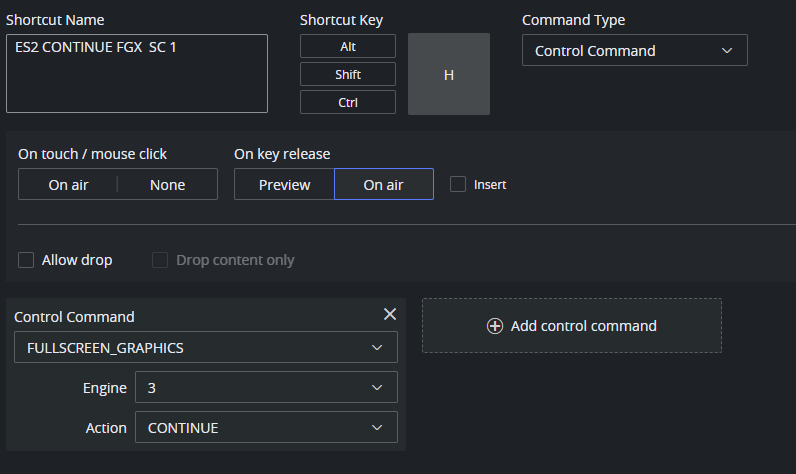

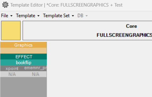

Some graphics are built with continue points (stop points) in the scene. The graphic pauses at a stop point until a Continue command advances it to the next one. Use this to step through a graphic, for example to reveal the next item or move to the next state, and also to play an out animation at the end. For these graphics you advance with a Continue command rather than a take out.
A Continue is sent to the graphic currently on air, on a channel resolved from a mixer effect and a superchannel, and the Media Sequencer advances that graphic to its next stop point.

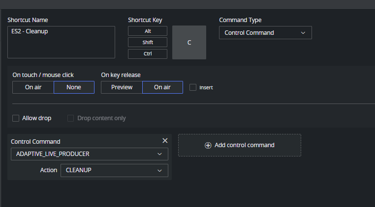

You can trigger Continue two ways:

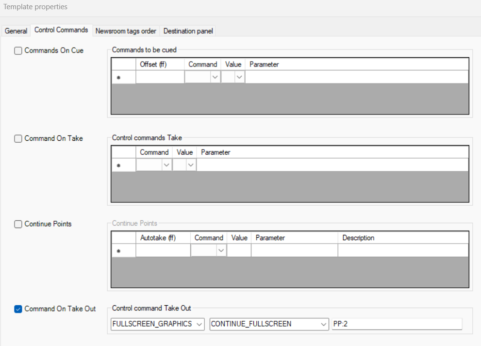

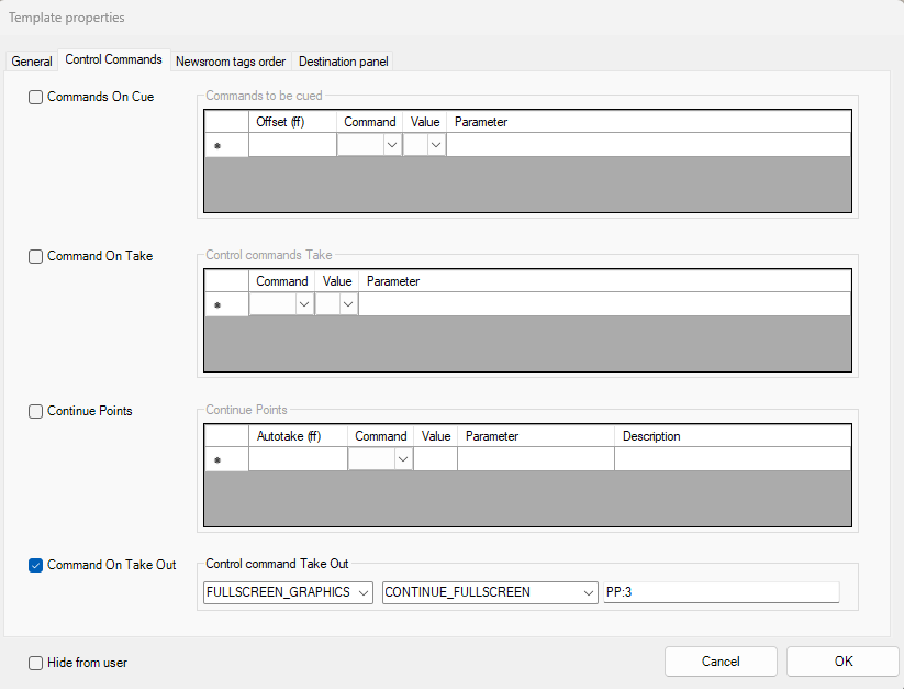

Control command on a template
Add a Control Command, select FULLSCREEN_GRAPHICS, and set the value to CONTINUE_FULLSCREEN. Target a specific mixer effect and superchannel using the format <mixer effect>:<SCn>, or leave it on Current to use the on-air graphic. This is the reliable option, because the target does not depend on which template is currently on air.

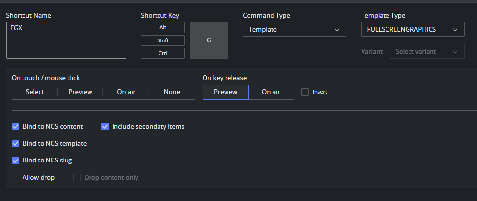

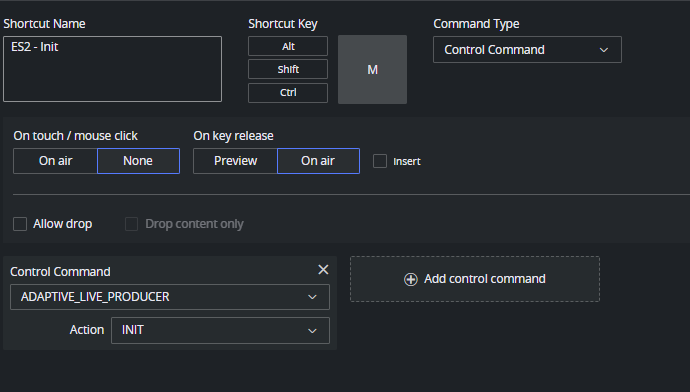

Keyboard shortcut
In the keyboard editor the field Engine lists graphics engine numbers (1 to 8) and Current; for ALP only Current is valid, since it uses the on-air template's mixer effect.
Info: Currently the editor does not display mixer-effect and superchannel selection, so the keyboard shortcut is limited to the current on-air graphic.
Info: Continue with Current only resolves while the graphic is still the on-air graphics item. Once a live-only template (with no graphics) becomes the on-air template, Current cannot find the mixer effect and the continue is skipped. Target the mixer effect and superchannel explicitly on the template control command to avoid this.

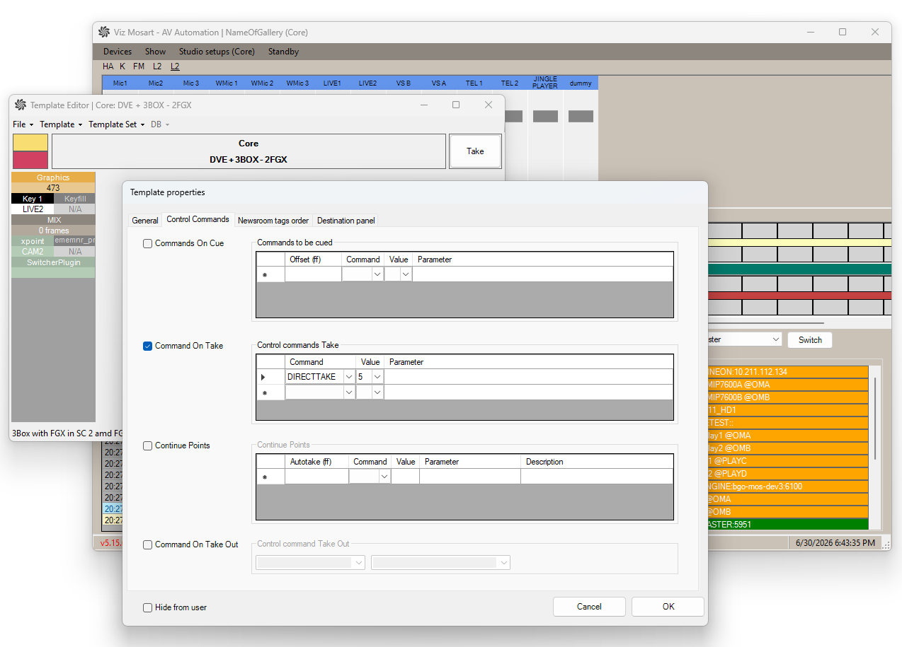

Multiple graphics on DVE box layout
A template can include only one Graphics device, so it takes a single fullscreen graphic. To show more than one graphic on a DVE layout, take the extra graphics separately. There are two ways to do this, and in both the graphics are not taken in sync (each graphic takes on its own, not in the same frame as the layout or the other graphic).
DirectTake from a control command
On the DVE template, add a control command that direct-takes another template carrying the second graphic. In the Template Editor, on the Control Commands tab, add a DIRECTTAKE command on take and set its value to the template that takes the second graphic.
The referenced DirectTake template holds the second Graphics device, and its graphic ID must be set in the template itself (Scene Name with Is database Index), so it cannot be driven from the NRCS.
Accessory template (secondary item)
Add an Accessory template, with its own Graphics device, to the story item that takes the first graphic. In the NRCS, place the accessory as a secondary at the start of the story (or later in the story if needed) so it takes within the DVE item. With this method both graphics, the one on the main item and the one on the accessory, can take their content from the NRCS.
With either method the extra graphic is not taken in the same frame as the layout or the other graphic. Each graphic takes on its own director, so they are not synchronized.
Info: With either method the extra graphic is not taken in the same frame as the layout or the other graphic. Each graphic takes on its own director, so they are not synchronized.

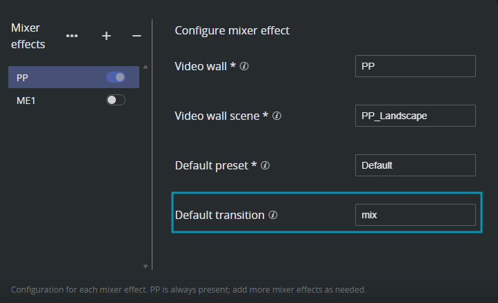

ALP supports two type of transitions: preset transitions (changing the layout) and content transitions (changing what plays on a superchannel). They are independent and can be combined on the same take.
Info: All engines must share the same content transition names. Content transition names in A/V Setup (effects) and in the switcher configurations must exist as directors in the preset scenes on every Viz Engine in the setup. A mismatch makes the transition fail silently on that engine.
Preset transitions
A preset transition animates the switch between layouts (for example 1Box to 2Box). Viz Engine runs the animation using the transition director defined in the preset scene. The Switcher Plugin on the template controls the transition, the Switcher Crosspoint transition has no effect on the preset.
Switcher Plugin setting | Preset behavior |
No Switcher Plugin | Scene default transition. |
Animate unchecked | Instant preset cut. |
Animate checked, no duration | Animated transition using the duration last set on that preset transition. |
Animate checked + Duration > 0 | Animated preset transition with custom duration. |
Content transitions
A content transition animates the switch of the live source or graphic on a superchannel. The director must be configured in the Viz Engine preset scene (for example crossfade, bookflip, dissolve).
The main transition control on a template, defined when a Switcher Crosspoint is added, controls the transition for superchannel 1 (background).
Choose main transition control when adding transition on a superchannel where graphics content is taken using the Graphics device.
The KeyFill command controls the transition for any superchannel.

Cut (or Mix 0) | Hard cut ( |
Mix or Wipe rate > 0 | Uses the Default transition setting on the switcher configurations. |
Effect (from A/V Setup) | Uses the effect name directly as the content transition director name. |
Mix or Wipe with rate > 0
For ALP, a Mix and a Wipe with rate > 0 are similarly treated as content transition, and behave identically on air. This is configurable in the switcher settings and applies for any transition control on a Mosart template.
To get a distinct wipe, set it up as an Effect in A/V Setup that points at a wipe transition director in the scene.
Effect transitions: when a template uses an effect from A/V Setup, the effect name is used directly as the content transition director name, and the duration comes from the effect's frame count (default 1 second). Each effect name in A/V Setup must match a director in the Viz Engine scenes.

Camera template with hard cut (Mix 0): set the template Mix Rate to 0. Mosart sends a hard cut for both preset and content. No animation.
Camera template with transition (Mix > 0): set the Mix Rate above 0 (for example Mix 25 for one second at 25 fps). Mosart uses the configured mix transition for the content, and animates the preset if the Switcher Plugin has Animate enabled.
DVE template with preset animation: add a Switcher Plugin with the target preset per mixer effect. Enable Animate and set the duration. On take, Mosart sends the preset transition as "transition" instead of "cut". Preset animations and content transitions run at the same time, so design the scene to handle both together. Each KeyFill can also carry its own content transition (a Mix rate or a named Effect), set per row in the KeyFills dialog, so box sources can animate independently of the layout.
Template with effect transition: in A/V Setup, create effects whose names match content transition directors in the Viz Engine scenes (for example "bookflip", "dissolve"). On the template, select the effect. Mosart sends the effect name as the content transition director with the configured frame count as duration.

Configure keyboard shortcuts for ALP control commands in Mosart's Keyboard Shortcuts editor. Set the Command Type to Control Command and select ENGINE_SWITCHER_VIA_MSE as the command.
Action | Description |
| Initialize the ALP connection and show. |
| Clean up ALP playout state (profile-wide). |
| Change preset on a mixer effect (set PresetName and Transition). |
Run the INIT keyboard shortcut to preload the graphics and scenes used in the show onto the MSE playlist before the show starts. This is the main reason to use INIT: loading a scene while the show is running can cause a stutter on whatever is currently on air, so every scene that could be played, including heavy ones, should be loaded up-front. INIT loads them into the Viz Engine ahead of time, so taking a graphic on air is smooth. After a scene is loaded, its images and texts can be updated in the background from NRCS values without that cost.
For SET_PRESET, set the MixerEffect field to target a specific mixer effect (PP, ME1, ME2) or ALL to apply to all mixer effects. Set PresetName to the target preset and Transition to CUT or TAKE (animated). Taking a preset with a custom animation duration is not supported from keyboard shortcuts.
The CLEANUP action resets the ALP playout state on the MSE. It operates on the entire profile (all mixer effects and all superchannels).
Per-mixer-effect cleanup (targeting only PP or only ME1) is not supported.
CLEANUP is also available as a control command on templates (see below).
Note: CLEANUP does not clear superchannel content entries.
It clears MSE playout state and unloads the preset scene, but superchannel content entries stay in the MSE VDOM, so
old content reappears when the scene reloads.
Beyond the ALP control commands below, the standard Template Keys work as usual for ALP. Keyboard shortcuts that bind a template's content to the NRCS (Bind to NCS content) or that drop content onto a key (Allow drop and Drop content only) behave the same way as for a traditional switcher.
Control commands on templates
ALP actions can be triggered from template control commands (on cue or on take out).
In the Template Editor, add a control command.
Select ENGINE_SWITCHER_VIA_MSE as the command type.
Value | Description |
| Change preset (set the preset name in the Parameter field). |

DVE: A DVE template with the 2Box preset and keyfills switches several sources together.
Fullscreen graphics: A fullscreen graphics template shows graphics on the superchannels.
