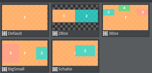

Preset (1Box, 2Box, …)
DVE layout controlled via Switcher Plugin

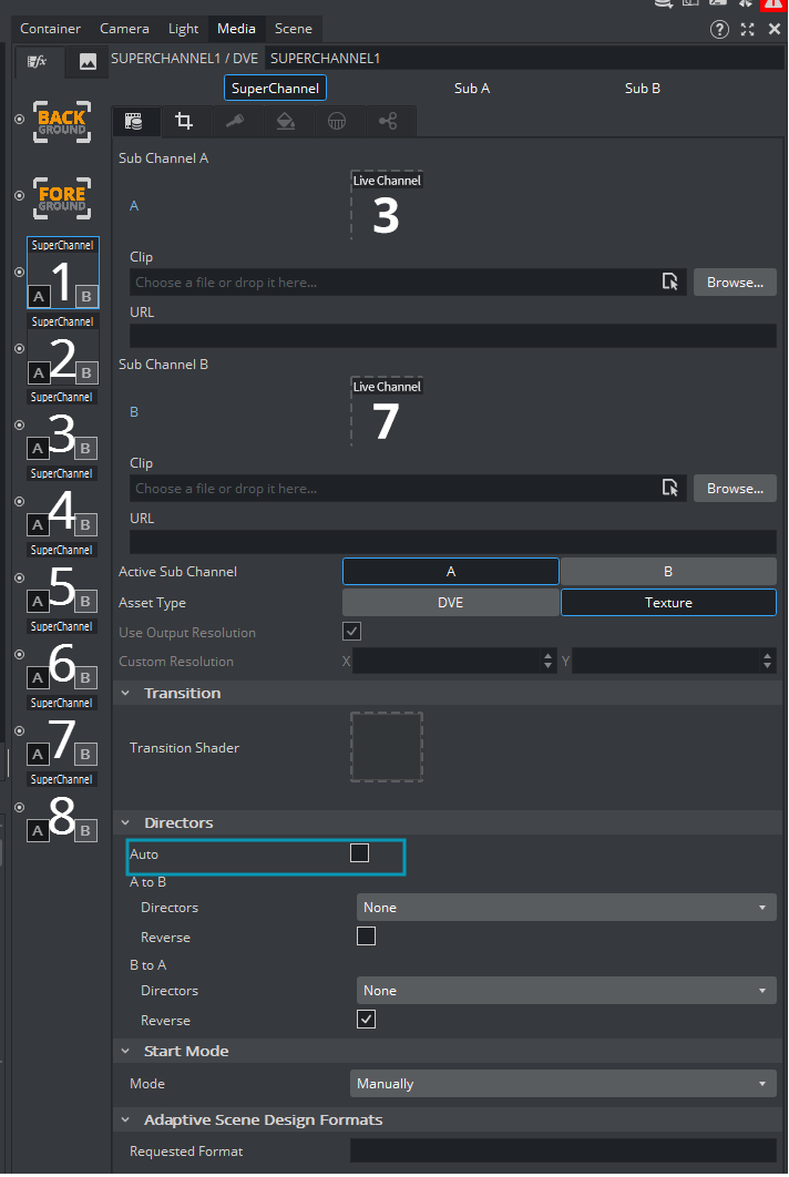

  • Same number of superchannels across all engines (PP, ME1, ME2)
  • Same preset names on all engines
  • Content transition directors configured in the scene design (for example crossfade, dissolve, bookflip). These directors drive animated transitions between content on a superchannel.
  • The Auto property on the Directors of each superchannel must be off to allow Mosart control the content transitions.

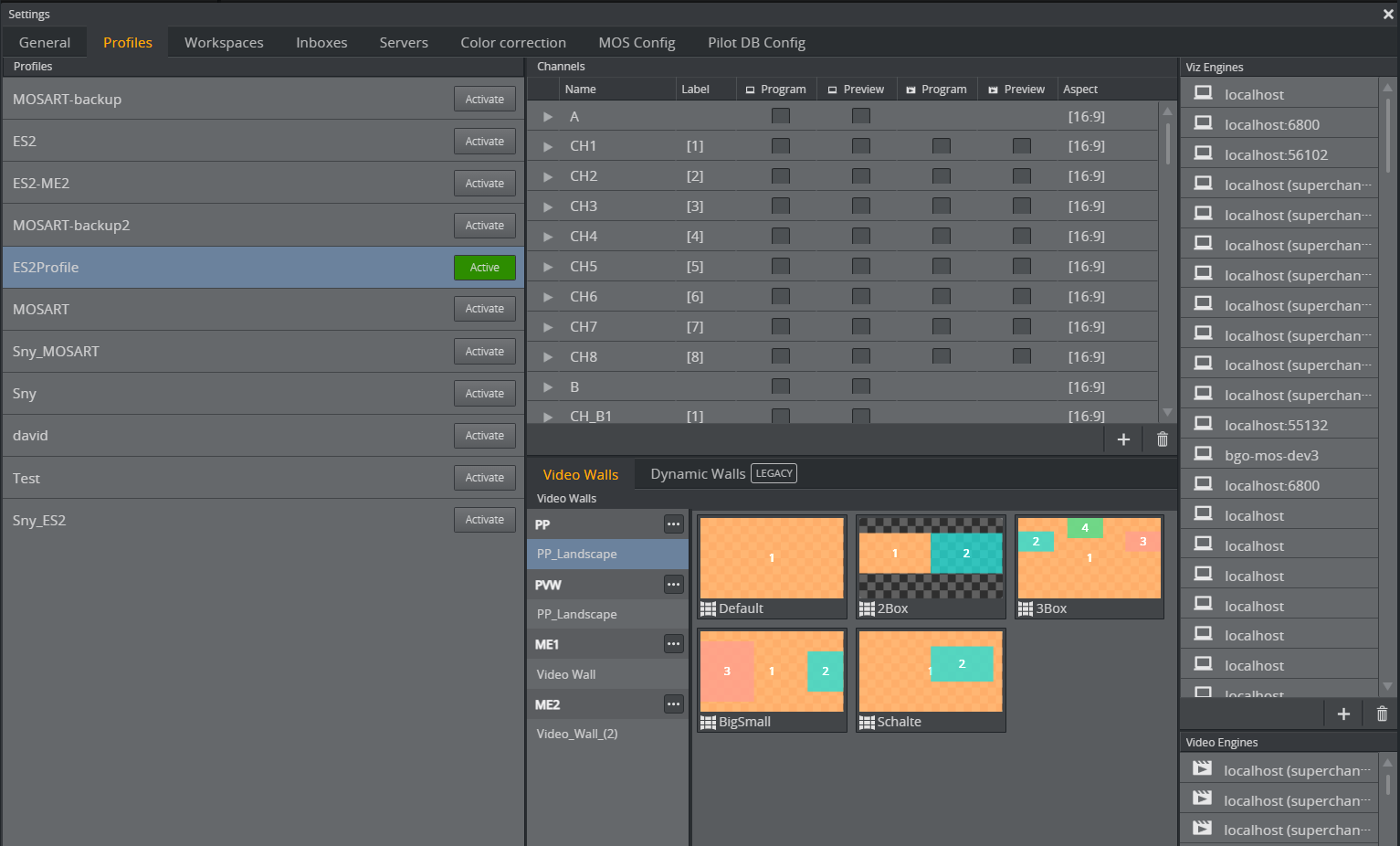

Each Mixer Effect is configured with Viz Multiplay’s Profiles configuration, for now. In the Viz Multiplay profile configuration, you set up a Mixer Effect as a video wall, the Viz Multiplay object that controls a Viz Engine's superchannels. The video wall terminology belongs to Viz Multiplay; in ALP, one video wall is one Mixer Effect.

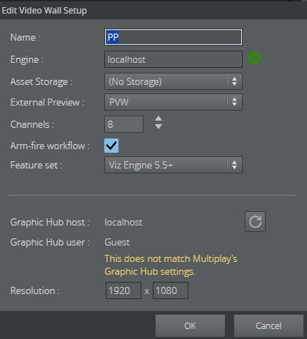

  1. Create a profile with connections to each Viz Engine.
  2. Create video walls for the main output (PP) and any secondary outputs (ME1, ME2, and so on).
    Each video wall corresponds to a Mixer Effect in Mosart (PP, ME1, ME2).
    Name the video walls as you desire (it does not have to be PP, ME1 etc.)
  3. Verify that Arm-fire workflow is enabled and configure the required number of superchannels.

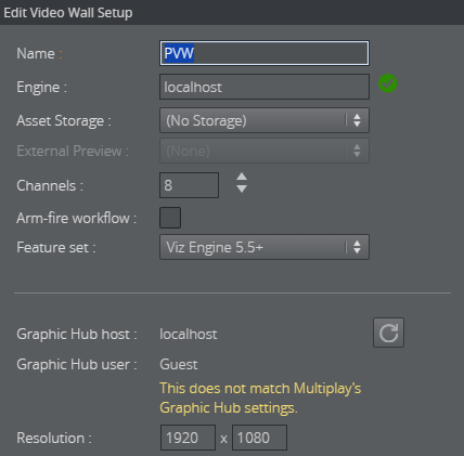

  4. For each video wall, optionally configure a preview wall for preview output on a separate engine and link to it from the program wall.
    For the preview wall, do not select Arm-fire workflow if the preview is configured on the same machine as the main output. See details in section Preview Setup.
  5. Create scenes for each video wall. Set the same scene in the matching preview wall.
  6. Create presets in the scene using Viz Multiplay or Viz Artist:

  3. In Viz Multiplay, create two video walls for ALP pointing to the same scene — one for program and one for preview.
  4. On the Program video wall, check arm-fire workflow and select the preview video wall as its preview.
  5. On the Preview video wall, do not check arm-fire workflow.

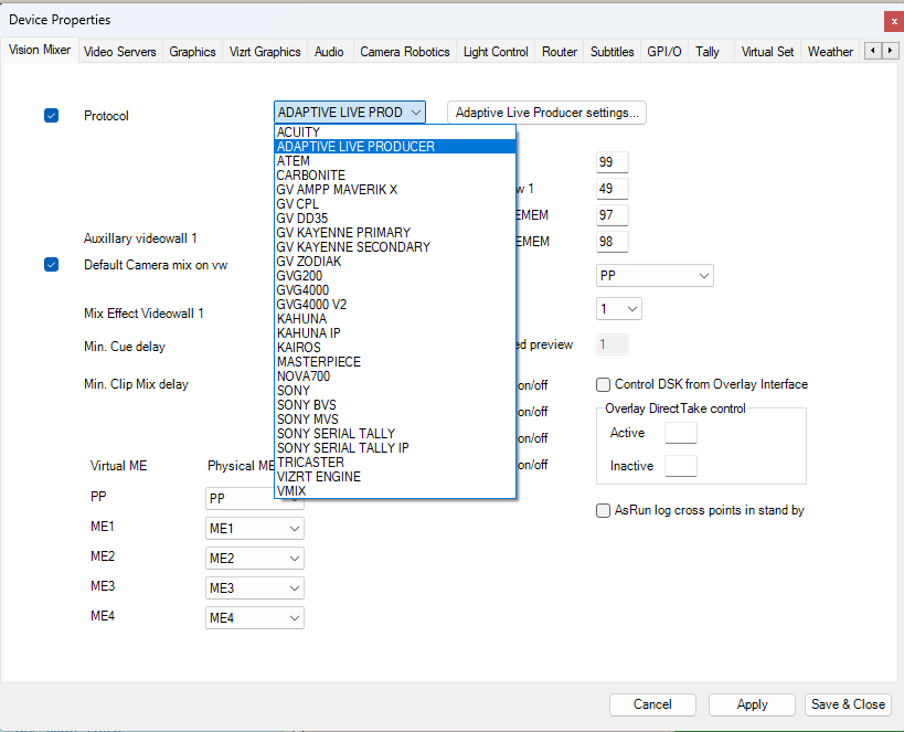

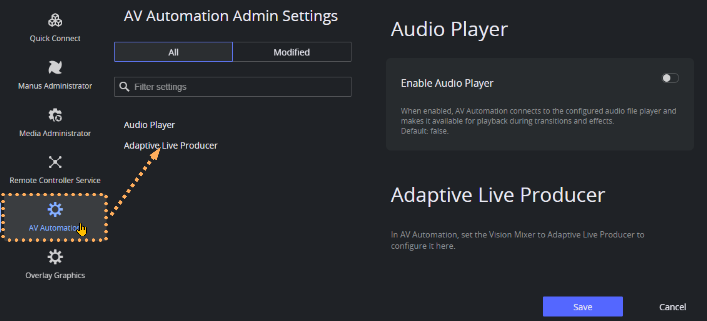

To configure ALP in Viz Mosart
  1. In AV Automation navigate to Devices > Properties > Vision Mixer [tab] select and enable Adaptive Live Producer protocol from and open the Mosart central settings page to configure its properties.
  2. In the AV Automation navigate to Devices > Settings.
  3. In the combined Settings window that opens, select Adaptive Live Producer.

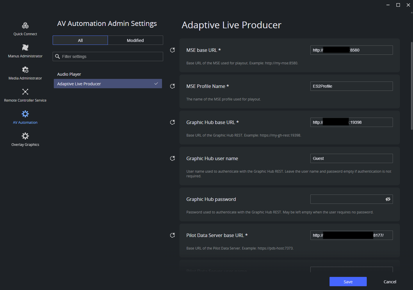

  4. Configure the settings following these guiding values:
Setting
Scope
Description
MSE base URL
Global · required
Base URL of the MSE used for playout. Example: http://my-mse:8580.
MSE Profile Name
Global · required
Name of the MSE profile used for playout (default MOSART).
Graphic Hub base URL
Global · required
Base URL of the Graphic Hub REST. Example: https://my-gh-rest:19398.
Graphic Hub user name
Global · optional
User name to authenticate with the Graphic Hub REST. Leave the username and password empty if no authentication is required.
Graphic Hub password
Global · optional
Password to authenticate with the Graphic Hub REST. May be left empty when the user requires no password.
Pilot Data Server base URL
Global · required
Base URL of the Pilot Data Server. Example: https://pds-host:7373.
Pilot Data Server user name
Global · optional
User name to authenticate with the Pilot Data Server. Leave the username and password empty if no authentication is required.
Pilot Data Server password
Global · optional
Password to authenticate with the Pilot Data Server. May be left empty when the user requires no password.

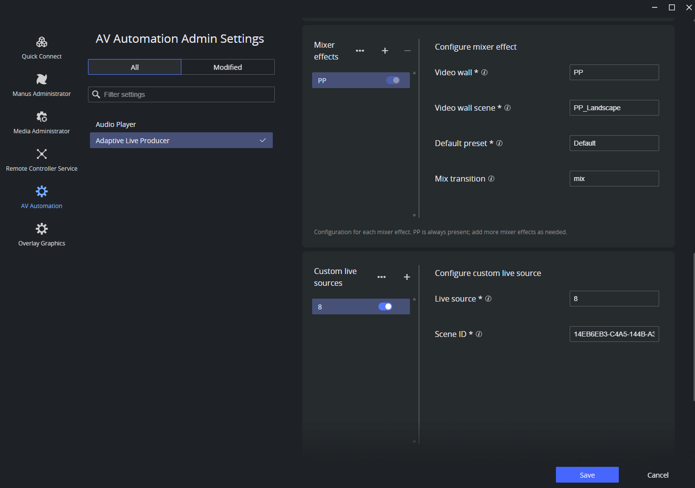

Mixer effects
Per mixer effect · required
PP is always present; add more mixer effects as needed.
The names are auto-generated: ME1, ME2 etc.
Video wall
Name or ID of the video wall used by this mixer effect (as created in Viz Multiplay).
Video wall scene
Name or ID of the video wall scene used by this mixer effect (as created in Viz Multiplay).
Default preset
Preset used as the default when no Switcher Plugin command is added on a Mosart template.
Default transition
Per mixer effect · optional
Transition name used for Mix and Wipe with rate > 0 transitions on the background (SC1). If empty, the whatever transition is currently used on the scene is used.
Custom live sources
Optional
Use this when a live input needs more than a plain video texture, for example a branded frame, a border, a rotation, or any other treatment built into the scene design.
Custom live sources are optional. Each override targets one live source by number and applies to every mixer effect (PP, ME1, ME2, and so on). You cannot set a different scene per mixer effect.
Live source
Custom live source · required
The live source number the override applies to (1 to the number of live sources).
Scene ID
UUID of the Graphic Hub scene to use instead of that live source (for example, for branding).
Mixer effects is an expandable list: PP is always present, add ME1, ME2, … as needed.
Custom live sources are an optional list that applies to every mixer effect.

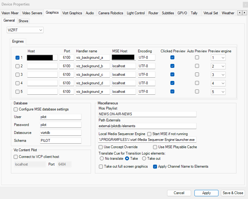

Enabling the Adaptive Live Producer switcher in AV Automation also lets the graphics driver play out fullscreen graphics directly on the superchannels.
  • In AV Automation navigate to Devices > Properties > Graphics [tab], follow the guidelines in the screenshot below.

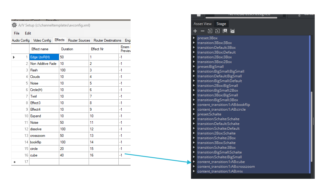

  4. Configure the Engine Presets list. Preset names must match those created in Viz Multiplay and Viz Artist.
  5. Configure Effects. Each effect name must match a content transition short name in the Viz Engine preset scenes (for example bookflip, dissolve).
    1. All engines (PP, ME1, and so on) must use the same content transition names; the design of each transition can differ per engine.
    2. Both custom and shader transitions are supported.
