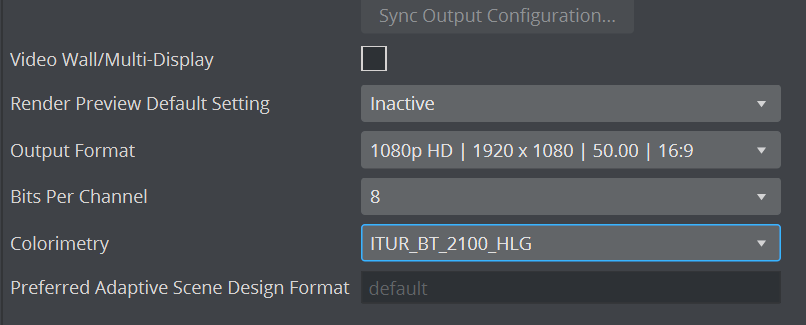

The environment refers to the format of video signals and clips in use. It is generally static, with the engine supporting both SDR and HLG signals (the configuration must match the environment). Configuration details are described in the Viz Engine Administrator Guide.
Note: The incoming signal needs to match the configuration.

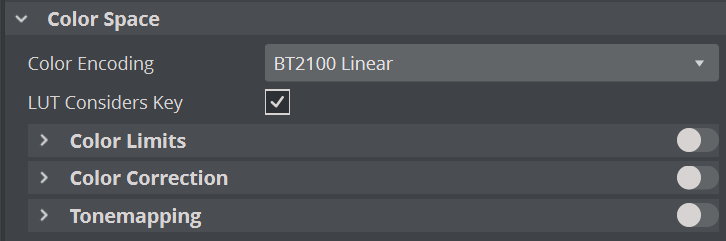

HDR scenes define as scenes that use the linear BT.2100 color encoding. The color encoding of a scene should be determined in advance and remain unchanged. The scene color limits are also relevant for HDR, the default limits of 0 and 1 clamp the output to nominal signal range. Using superblack and superwhite requires relaxed or disabled color limits.

Scenes must be designed from the start in HDR, using the linear BT.2100 color space. If all assets are HDR, no conversions are required. However, SDR assets require conversion using an SDR to HDR LUT. HDR to SDR conversion is not necessary, but should be enabled in the configuration, if it is possible that SDR scenes are used as well.
