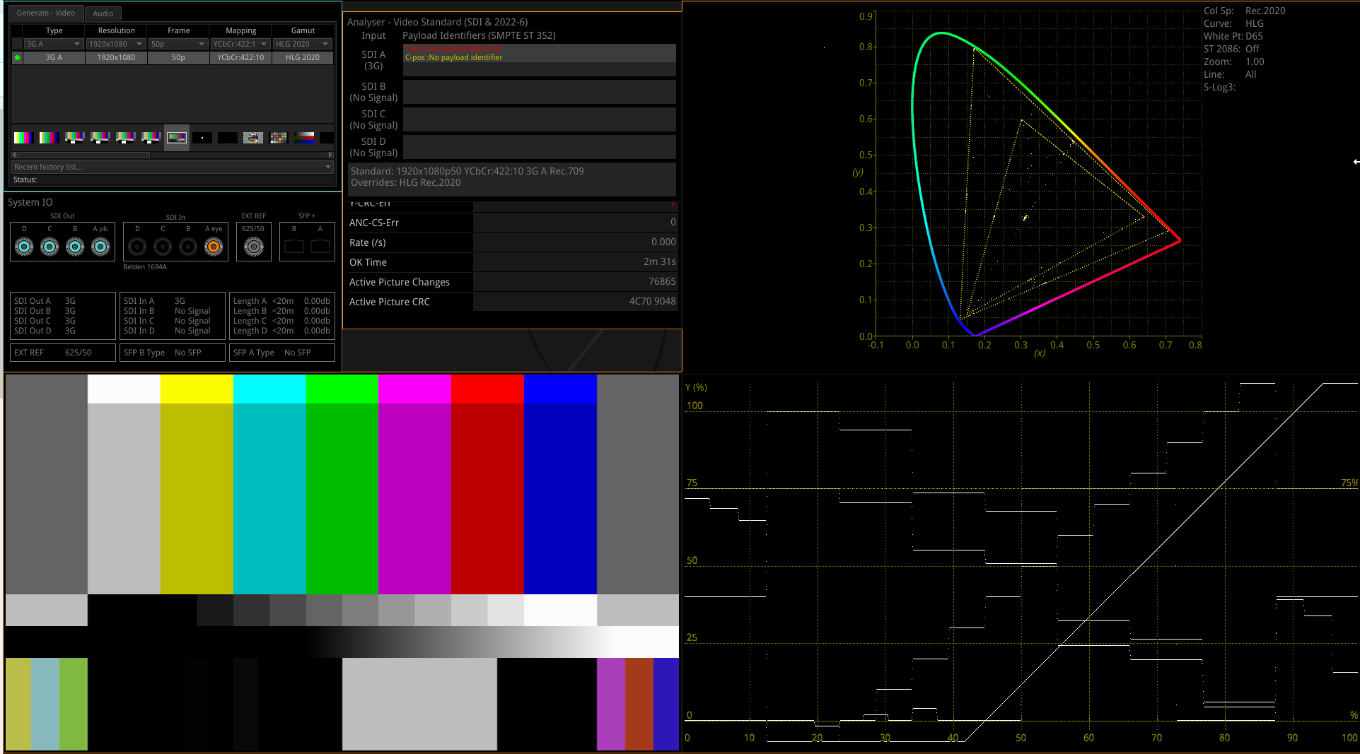

To verify the correct output of your HDR design, we recommend using a calibrated SDI reference monitor. A spectrum and waveform analyzer helps measure and validate the correct output.

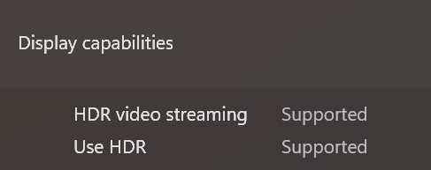

  • Select the display, and turn on HDR:
  • Make sure your display is capable of showing HDR content:

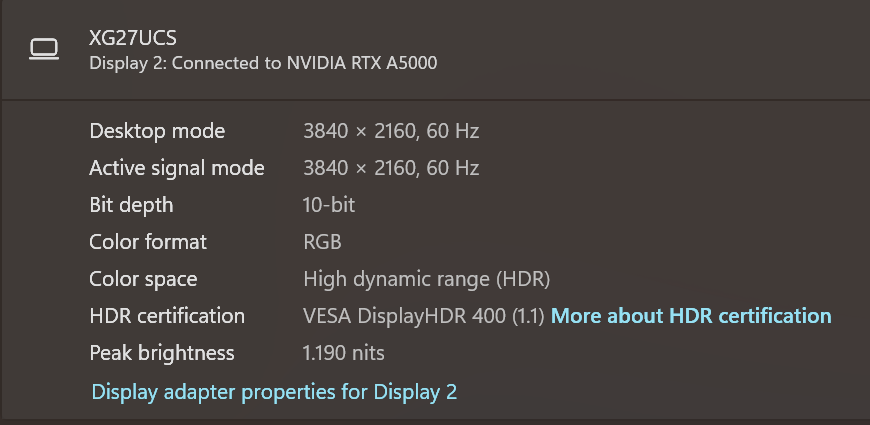

    Additional information is available in System > Display > Advanced display:

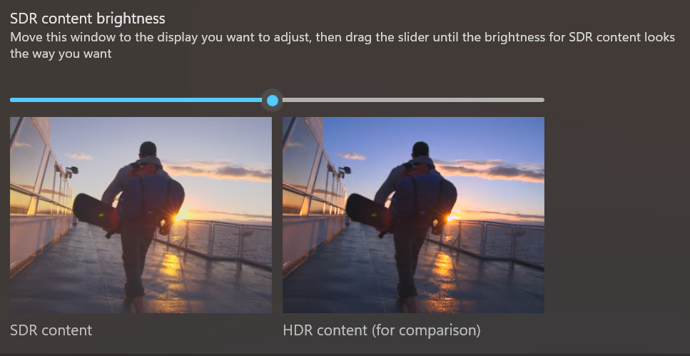

  • To verify if the window is capable of HDR color space, move the slider in the SDR content brightness:
    If the scene editor window is not being affected by the slider setting, the HDR output is working correctly.
