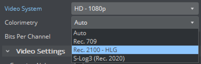

The input color space conversion needs to be active, preferably to Both:
Using Live Video
SDI/IP and NDI Sources
SDI/IP inputs with Matrox boards and NDI inputs are fully supported in HDR workflows. They are converted between SDR and HLG, and the renderer selects the appropriate version of the input texture for the given use case.
The colorimetry of NDI inputs is determined based on NDI signal’s metadata. Signals with missing metadata are treated as SDR. The only requirement to use (and send) NDI stream, is to set the in and output color depth to 16-bit. NDI streams deliver the required metadata to automatically set the correct color space.
Other live input types (for example, SDI inputs with AJA or Bluefish, SHM SMURF, WebRTC, etc.) are only supported in SDR scenes. To use SDI or IP based sources, make sure the correct colorimetry is set in the config settings for your input source.
Mismatches between the configured colorimetry lead to incorrect conversions.
Note: Input channels using hardware DVE on Matrox X.mio boards (SDI, IP, and Matrox Clip player) only work if the colorimetry of the input channel matches the output colorimetry.
Limitations:
  • S-Log3 (Rec 2020) is for backward compatibility only.
  • SDI/IP sources in DVE mode need to match the output colorimetry.
  • SDI or IP based HDR workflows are supported on Matrox boards only.

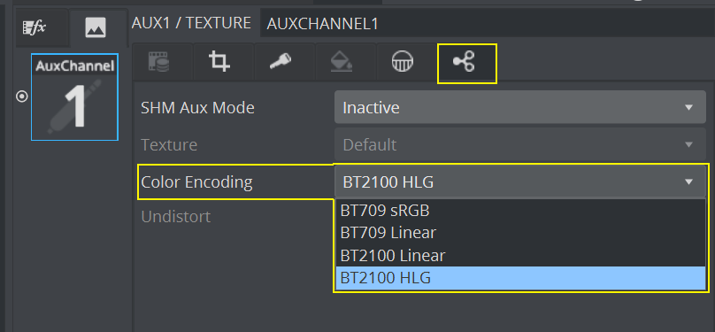

AUX Channels
AUX channels (used to exchange data with third party renderers, such as Unreal Engine) need to have the correct color space set in the in the Aux tab.

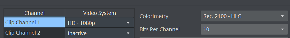

Matrox Clip Player
To use the Matrox clip player for HDR clip playback, the colorimetry needs to be set explicitly in the Viz Configuration:
Note: If you are using DVE inputs, the colorimetry needs to match the output colorimetry.

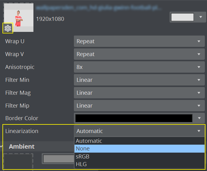

As images require embedding metadata to interpret content correctly, images from other sources (a local file storage) might require a manual setting of the linearization method.
The linearization method can be set to sRGB or HLG within the texture options of several plug-ins (PBR, Phong, Texture Slot, etc.).

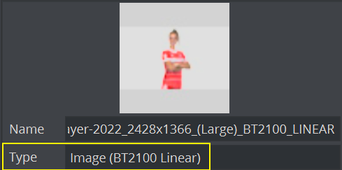

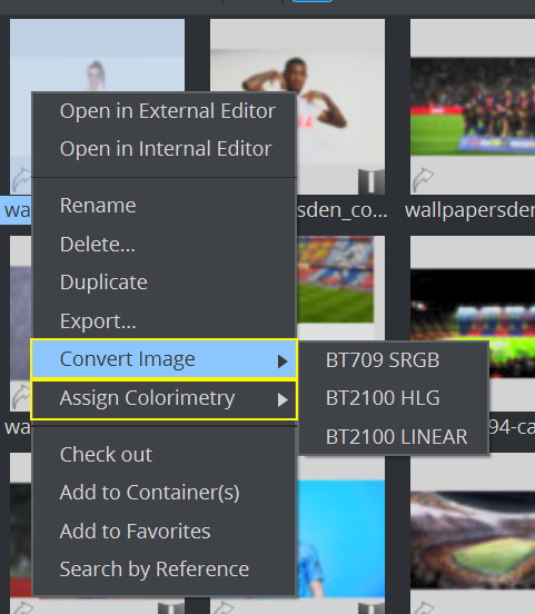

You can also reassign the colorimetry on existing images, or convert images from one color space to another. In Asset view, right click on an image to either re-assign, or convert to a different color space.
Images with correct metadata for HDR are labelled in Asset view, and more details are shown in the properties panel:
