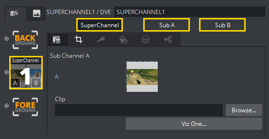

Super Channel and Subchannels

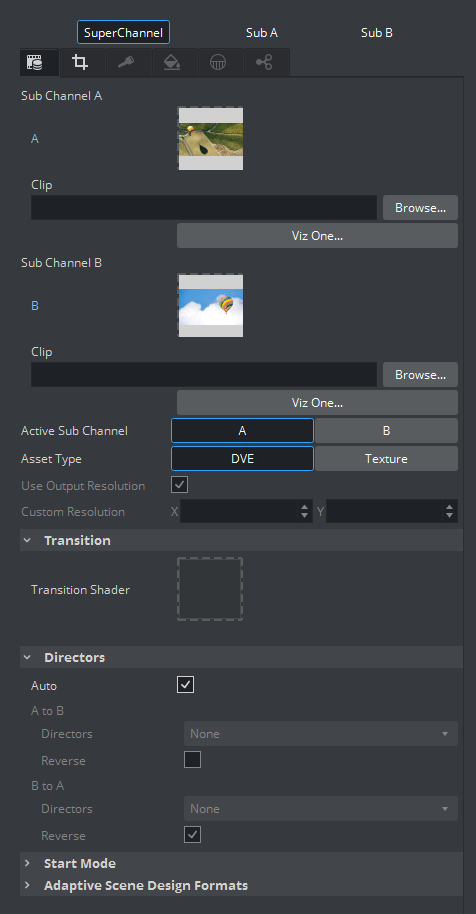

A Super Channel utilizes some generic settings and settings for A and B channel. The icon in the side panel shows a preview of the two Subchannels. To switch between the different properties you can use the tabs on the top or you can click the icons to switch:
Super Channel Settings
 Sub Channel (A, B): Drag scenes, images, live feeds or clips to the Sub Channel icon. Click Viz One to load a clip from your configured Viz One system, or load a local clip by clicking the Browse for a clip button.
Active Sub Channel
Forces the Super Channel to switch between A and B.
  • Asset Type: Switches between DVE and Texture mode. DVE requires a videoboard with hardware compositor capabilities. You can override the default output resolution (Use Output Resolution) with a custom resolution if needed (useful in certain scenarios like videowalls setups or if the surface of the texture channel is needed in third party applications).

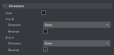

  • Directors: Sets the animation of the transition, from sub channel A to B, or from B to A. Disable Auto to select an existing Director to run the transition with, or None to disable the transition.

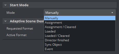

Start Mode: Selects what triggers the Super Channel transition:
  • Manually: Sets user manual switching from sub channel A to B, or vice versa, by selecting the sub channel in Viz Artist or through external commands.
  • Assignment: Triggers transition when you assign a new asset to inactive sub channel.
  • Assignment / Cleared: Triggers transition asset assignment, or when you clear the sub channel.
  • Loaded: Triggers transition when an asset is loaded. This is useful for Super Channels that display images when image background loading is active in the Viz Engine configuration.
  • Loaded / Cleared: Triggers transition when an asset is loaded, or when you clear the sub channel.
  • Director finished: Triggers transition once a given director has finished execution.
  • Sync Object: Drag a Super Channel to the Sync objects area. Sync objects provide a way to synchronize execution of Super Channel transitions between multiple Super Channels. Sync objects monitor all linked Super Channels until all their inactive sub channels have been loaded. The sync object then calls onAllChannelsArmed to trigger the transition for all Super Channels managed by the sync object. You can add as many Super Channels to a sync object as are required.
  • Event: Allows you specify the Scene, the sender (Animation from Stage or from Super Channel) and the Event (on Started, on Stopped, onDirectorStarted, onDirectorStopped).

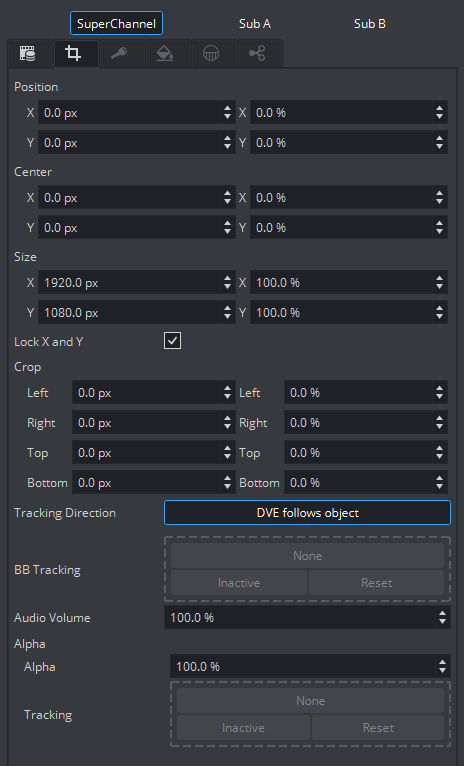

Super Channel Transformation
This section is used to animate the whole Super Channel, including both sub channels. Super Channel animations are independent of the sub channel animations. This means that you can have a transition animation between multiple Super Channels, which is often required for content on Videowalls.
You can animate certain Super Channel properties, such as Position, Size, or Alpha, to define custom transitions between one or more Super Channels. A detailed description of the parameters can be found in the Media Asset Panel.
Note: Super Channels deal with rendering content assigned to the two sub channels, A and B, in the current main scene. Thus, they represent an intuitive and easy to use mechanism for transitioning between the sub-channels A and B.

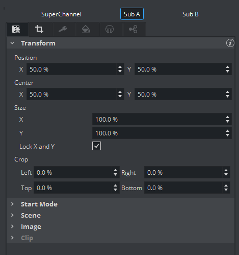

Sub Channels
A Super Channel is composed of two Sub Channels, A and B.
You can animate certain Sub Channel properties, such as Position, Size, or Alpha, to define custom transitions between the two Sub Channels.
Transformation Settings

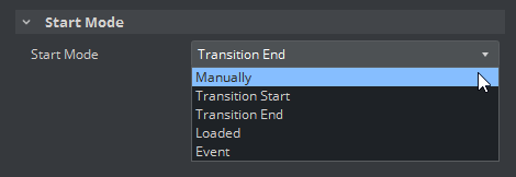

Start Mode Settings
Here you can select how to trigger the Sub Channel animation. The Start Mode options are:
  • Manually: Sets user manual switching from subchannel A to B or vice versa by clicking the corresponding subchannel in Artist or through external commands.
  • Transition Start: Triggers on transition start.
  • Transition End: Triggers on transition end.
  • Loaded: Triggers transition once a newly assigned asset has been loaded. This is of special interest for Super Channels displaying images, with image background loading activated in the Viz Engine configuration.
  • Event: Allows you specify the Scene, the sender (Animation from Stage or from Super Channel) and the Event (on Started, on Stopped, onDirectorStarted, onDirectorStopped). An event is fully defined by its event name, the identifier/name of the sender, and its arguments. A new internal event system was introduced in Viz Engine 3.9. This allows certain objects to fire and listen to internal events. Amongst those objects are:

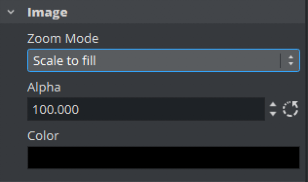

Image Settings
  • Image: Allows you to control the Zoom mode, Alpha value and the border color of a loaded Image.

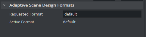

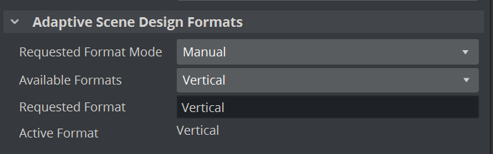

Adaptive Scene Design Formats Support for Super Channels
Super Channels can be set to render a certain format using the command or Viz Artist:
#<sceneID>*SUPERCHANNEL*1*REQUESTED_FORMAT SET <name of format>
Note: If the requested format is not supported by the Super Channel scene, then it falls back to the default format to render content.
Note: Formats support is possible if we are using a scene in SubChannel A or B.
Set the Requested Format for SubChannel A or B
There are several options available for Requested Format Mode in SubChannels:
  • Manual: Renders a given format. Can be set using Available Formats.
  • Inherit from Main Scene: Uses the format of the GFX Channel Master scene.
  • Use Aspect Ratio: Selects the format automatically based on the width/height, and therefore, the aspect ratio of the scene. The first matching format is applied. Only works for DVE.
    #<sceneID>*SUPERCHANNEL*1*A*SCENE*REQUESTED_FORMAT SET <name of format>
    #<sceneID>*SUPERCHANNEL*1*A*SCENE*REQUESTED_FORMAT_MODE SET <mode> // options are MANUAL, INHERIT_FROM_MAIN_SCENE or USE_ASPECT_RATI
