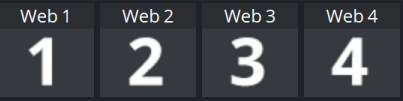

Web Channels allow a designer to use up to eight HTML-based render layers. They can be used either as Texture or as DVE effect.

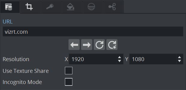

Web Channels only require a valid URL. Once entered, the webpage is rendered and can be interactively used.

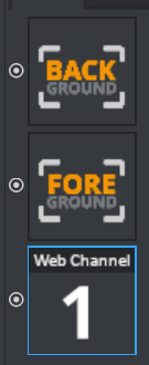

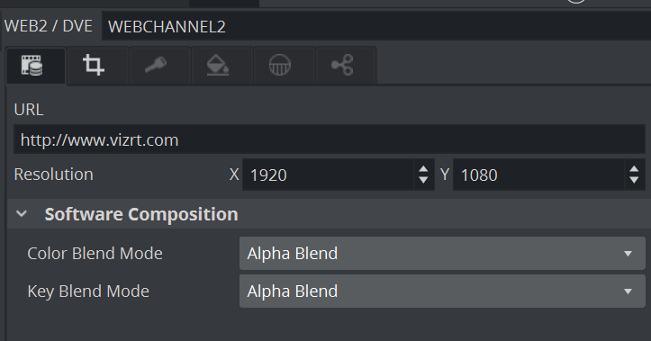

If you want to blend your webpage against any background in DVE mode, make sure your are using the following order:
