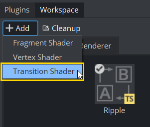

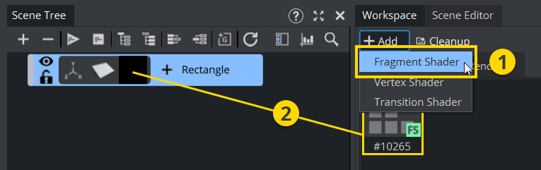

Create a new scene and add a rectangle to it.
Next step is to switch to the Scripting Workspace. In the workspace, select +Add and Fragment Viz Engine Shader. A new Shader appears as Fragment Shader.

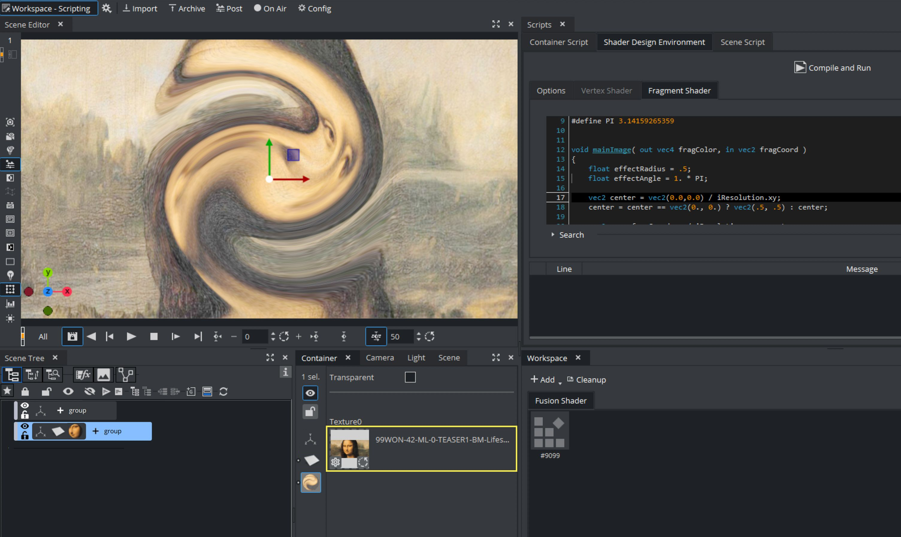

Drag the Shader to the container. the Shader Design Environment is activated. As we are creating a Fragment Shader only, only this tab gets activated. A Vertex Fragment Viz Engine Shader would activate both tabs, Fragment and Vertex Shader.
Now copy and paste the shader code into the Script Editor. As we need to link some properties between the Shader and Viz Engine, some adjustments are needed for our code. Viz Engine calls fragmentMain() on a Fragment shader, therefore we call the existing mainImage code from within this function.

Hitting the Compile and Run function still gives some errors. We need to replace the iMouse variable with a static variable. vec2(0.0,0.0) as we do not want to interact with the user.
Finally the texture, defined in the original code iChannel0, needs to be replaced by a function that provides a Viz Engine texture. Expose this as a property the user can change:
Fragment Shader
@registerParametersBegin
@registerParameterSampler2D(iChannel0, "Texture0")
@registerParametersEnd

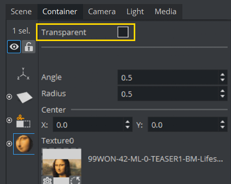

This overrides the iChannel0 with a userParameter. After a Compile and Run, we now have a property available to the user. Drag and drop a texture on it and you'll already see some effects:

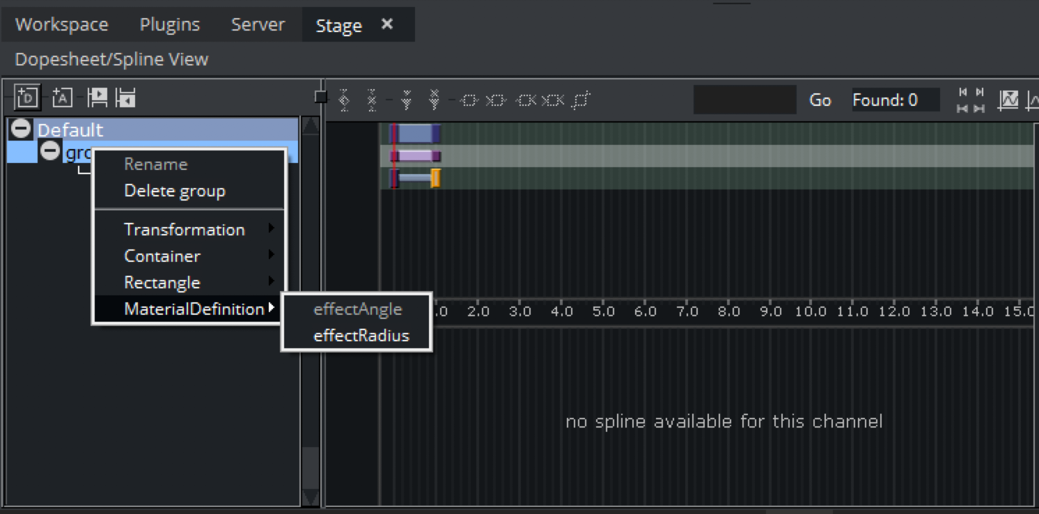

Now if you change some parameters like the effectRadius or effectAngle and click on the Compile and Run button, the shader behaves differently.
float effectRadius = .5; float effectAngle = 1. * PI;
It would be nice, if we can also expose those settings to the user. We extend our code so that we use more parameters to set our variables. Finally, to access the values of this parameters, the lines where those variables are used need to be slightly changed to read the actual values.

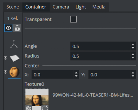

The UI now has been extended to show these values:
Changing these values immediately changes the way how the shader affects our image. Instead of an image, you can also apply this effect to any Media Asset like Live Sources or Clip Surfaces. These values are also fully animatable.
Tip: Viz Engine Shaders can be saved into Graphic Hub. Drag and drop them from the Workspace window into the Graphic Hub Server view.
Properties for Viz Engine Shaders
Viz Engine Shaders can integrate into Viz Engine design workflows by exposing some parameters to the user. This enables certain built-in render features inside the Viz Engine Shader. These properties can be found in the Options tab.
Transparency is part of the Viz Engine Shaders User Interface:

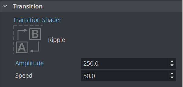

As a transition example we will create a Ripple effect with parameters:
  1. First add a Super Channel to your scene and add two images as a source into the Sub Channel A and Sub Channel B slot (these can be also other scenes, live sources, etc..). These textures are available in the Transition Shader as viz_textureA() and viz_textureB() functions.
  2. Open the workspace panel and create a new Transition Shader, give it a unique name:
  3. Double click on the Shader to open the scripting window (if the window does not open, make sure it is selected in the Available Docks menu).
The Transition Shader code:
@registerParameterFloat(amplitude, "Amplitude", 100.f, 0.f, 500.f)
@registerParameterFloat(speed, "Speed", 50.f, 0.f, 1000.f)
float amplitude = userParametersFS.amplitude;
float speed = userParametersFS.speed;
const float PI = 3.141592653589793;
float progress = viz_getTransitionTime();
vec4 getFromColor(vec2 op) {
return viz_textureA(op);
vec4 getToColor(vec2 op) {
return viz_textureB(op);
vec4 transition (vec2 uv) {
vec2 dir = uv - vec2(.5);
float dist = length(dir);
vec2 offset = dir * (sin(progress * dist * amplitude - progress * speed) + .5) / 30.;
return mix(
getFromColor(uv + offset),
getToColor(uv),
smoothstep(0.2, 1.0, progress)
void fragmentMain() {
vec2 op = viz_getTexCoord();
vec4 result = transition(op);
viz_setFragment(result);
4. Copy paste the code above into the editor and hit Compile and Run.
Important Parts of the Code
  • The first 4 lines define parameters exposed into the User Interface to manipulate the look of our transition.

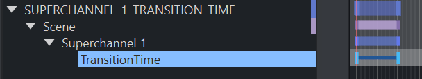

  • The time is used by calling viz_getTransitionTime();
    The duration/speed of the transition can be changed inside the stage:
  • The calculation is done in the transition() function.
  • getFrom and getToColor are wrappers used to read the pixels from the source and destination image, using viz_textureA and viz_textureB
To Use the Transition Shader
  1. Click on Media, your Super Channel and choose Super Channel > Content.
  2. Drag your new Shader from the Workspace to the Dropfield in the Transition Area.
Note: The two additional fields Amplitude and Speed, are the exposed parameters defined in the beginning of our script.
  1. Once the shader is assigned to the Super Channel as a transition shader, a new director with the name SUPERCHANNEL_i_TRANSITION_TIME (where i is the Super Channel index) is automatically created to animate the transition time.
  2. Now Click on A or B to see the Transition Shader in Action.
Note: The shader can always be updated in the scripting window. Compile and Run should be clicked afterwards to update the transition as well.

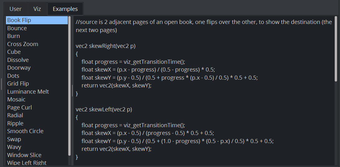

Shader Samples Library
As a starting point, Viz Engine provides some examples for beginners. You can explore them in the Shader Design Environment > Examples, or Transition Shader > Examples tab, depending on the shader type. The following figure shows the transition shader samples:
Copy and paste the sample code into the editor window.

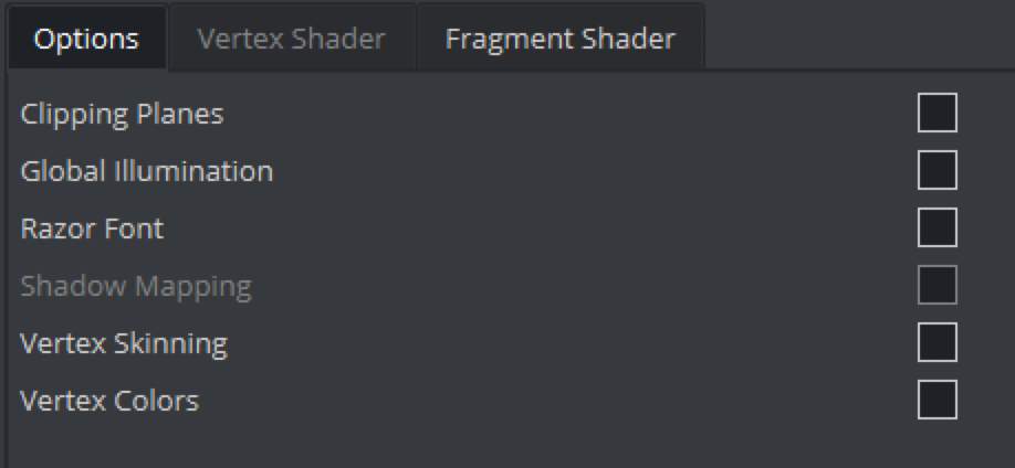

Built-in Features
All Viz Engine Shader templates have built-in features that can be enabled separately. Enabling a feature generates multiple variants of the shader and the best fitting one is selected to render. Keep in mind that the more features enabled, the more combinations of Shaders need to be generated and compiled. This can drastically increase the load time of a scene and the performance impact of a material. Only the features that are really necessary should be enabled.
Clipping
Enables support for the scenes Clipper objects. The template shader takes care of discarding the elements that are clipped.
Note: This feature makes use of the discard keyword, which can have a negative impact on performance.
