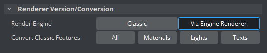

  • Render Engine and Scene Conversion
    • Render Engine
      • Classic: Uses the Classic Render Pipeline (from Viz Engine 3).
      • Viz Engine: Uses the Viz Engine Render Pipeline (introduced in Viz Engine 4).
    • Convert Classic Features: Migration helper functionality that converts Classic Render Pipeline scenes to Viz Engine Render Pipeline scenes (with limitations in quality of conversion).
      • All: Converts all materials, lights and texts, from a classic scene.
      • Materials: Converts all Classic materials to Viz Engine Renderer material definitions.
      • Lights: Converts all Classic lights to Viz Engine Renderer (V4) lights.
      • Texts: Converts all Classic texts to Viz Engine Renderer texts.

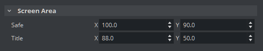

  • Screen Area
    • Safe X/Y: Sets the size of the Safe area X and Y values in percent of the screen resolution.
    • Title X/Y: Sets the size of the Title area X and Y values in percent of the screen resolution.

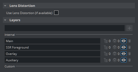

  • Lens Distortion: Enables the lens distortion for this scene, see Advanced Lens Distortion.
  • Layers
    • Internal: Shows information about the two fixed layers Main and SSR Foreground and allows to set the visibility to be toggled.
    • Custom: Allows to create and modify new Render Layers. This is for future features. For more information about Render Layers see Screen Space Reflection.

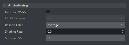

  • Anti-Aliasing
    • Override MSAA:
      • Disabled: Use MSAA settings from Config > Render Options > Full Scene AA
      • Enabled: Override MSAA settings from Config with MSAA Samples
    • MSAA Samples:
      • Number of samples used for MSAA.
      • Off to disable MSAA completely.
    • Software AA:
      • Off: Uses hardware antialiasing only.
      • FXAA: Removes pixel jiggering through an additional post processing effect based on the final rendering.
      • Temporal AA: Uses multiple frames to calculate smooth edges (best quality).
Note: For more information about anti aliasing methods, please see To Improve Render Quality.

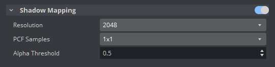

  • Shadow Mapping
    • Sets the resolution of the shadow map (higher means more compute time).
    • PCF Samples defines the quality of the shadow map.
    • The Alpha Threshold defines at which opacity an object starts to cast a shadow.

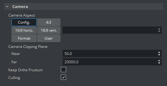

  • Camera
    • Camera Aspect: Sets the camera aspect.
      • Config: Makes the camera aspect equal to the settings in the Output Format panel of the Viz Configuration (see the Configuring Viz section of the Viz Engine Administrator Guide).
      • 4:3, 16:9 Horizontal and 16:9 Vertical: Makes the camera aspect independent of the aspect for the rest of the scene.
      • Format: Uses the aspect ratio of the selected format (See Adaptive Scene Format)
      • User: Enables the user to set a user defined camera aspect ratio. When building a Scene with a customized aspect ratio for a Video Wall, set the user-defined camera aspect to the same value as the Aspect shown in the Viz Configuration (Output Format > User Defined > Aspect (which is set dynamically based on the other values). When building a Scene with a customized aspect ratio for other (for example, hand-held/mobile devices or online publishing), set the Keep Editing Aspect (Render Options in Viz Configuration) parameter to Editor as this does not affect on the On Air or Viz Engine output (see also To Design Graphics with a User Defined Aspect Ratio).
    • Camera Clipping Plane: Sets the range of the virtual camera. Near sets the close range while Far defines the far range. Only containers within this range are rendered. This setting also affects the shadow rendering.
    • Keep Ortho Frustum: Takes the original frustum stored and does not allow its re-computation after changes have been made to the camera parameters in the orthogonal mode when active.
    • Culling: Saves performance for a scene when set to Active. Objects whose bounding box is outside the camera view are not rendered. This is of great importance to performance in large scenes and virtual studio. Normally Culling should be Active.
Note: The camera range is where the Zbuffer is within. So if Zbuffer problems arise, they may be solved by editing the camera clipping plane settings.

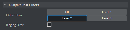

  • Output Post Filters
    • Flicker Filter: Makes it possible to change the level of the flicker filter from Off up to Level 3. The flicker filter is used to remove/reduce flickering from a scene in case of interlaced video output. If a flicker filter is applied and the scene still flickers, try using the next level. Flicker filtering is off by default in HD resolution. Set allow_flickerfilter_hd = 1 in the config file to enable it for HD resolutions, too.
    • Ringing Filter: Reduces the ringing artifacts on the SDI output and applies only to SD formats. The ringing filter can be set to Off (see Render Options (set Force Ringing Filter Off to Active) under Viz Configuration in the Viz Engine Administrator Guide). The default Ringing Filter is located in Scene Default Values in Viz Configuration).

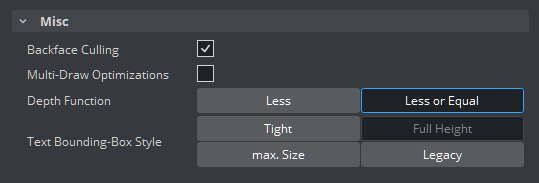

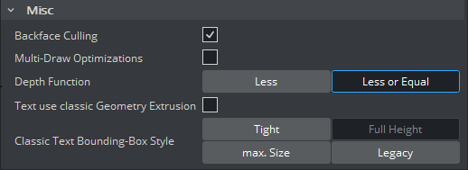

  • Misc
    • Backface Culling: Draws geometry usually not visible to the camera. This can be enabled for certain objects using the Expert plug-in.
    • Multi-Draw Optimizations (Viz Engine Render Pipeline only): Allows to render multiple geometries with only one call to the GPU (for example, for Text rendering)
    • Depth Function: Defines the depth function calculation.
    • Text use classic Geometry Extrusion: Sets whether to use the modern text (instead of the now obsolete classic style of extrusion for text). This option is for compatibility reasons, and is not checked by default for scenes created from Viz Engine 5.4.0 or later. The newer style generally has better performance, especially with animation.
    • Classic Text Bounding-Box Style: Defines how the bounding boxes for classic texts are calculated. This is for compatibility reasons only and usually does not need to be changed.
      • Tight: Draws the bounding box tightly around the text.
      • Full Height: Default and recommended setting.
      • max. Size: Only required for imported old scenes from 2.x.
      • Legacy: Uses the same algorithm as in 2.x versions (not in use anymore).
