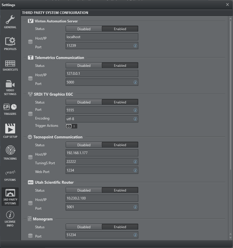

Vinten Automation Server
Viz Arc can be connected to a Vinten Automation Server. Vinten is a supplier of manual and robotic camera support systems.
  • Status: Enables or disables the server.
  • Host/IP: Host or IP of where the Vinten server is installed.
  • Port: The default port is 11239.

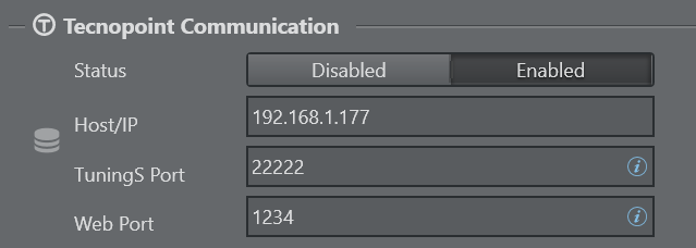

Tecnopoint Automation Server
Viz Arc can be connected to a Tecnopoint Automation Server.
  • Host/IP: Host or IP of where the Tecopoint TuningS server is installed.
  • TuningS Port: The default port is 22222.
  • Web Port: The HTTP port used to fetch thumbnail images, the default is 1234.
SRDI TV Graphics Integration (EGC)
The SRDI integration where Viz Arc acts as a server.
  • Status – enables or disables the listener. When enabled, it starts automatically with Viz Arc; changes take effect as soon as the settings are applied – no restart needed.
  • Port – the TCP port Viz Arc listens on (default 5555). Configure the same port as the CG connection target in SRDI. Viz Arc listens on all network interfaces.
  • Encoding – text encoding of the incoming data (default utf-8). Switch to iso-8859-1 if accented characters look garbled.
  • Trigger Actions – optional: when enabled, each incoming command also executes the Viz Arc action named after the SRDI page (see Triggering Actions below). Off by default – the data is stored in the Data Map either way.
Telemetrics Automation Server
Viz Arc can be connected to a Telemetrics Automation Server.
  • Host/IP: Host or IP of where the Telemetrics server is installed.
  • Port: The default port is 5000.
Utah Scientific Router
Viz Arc can connect to a Utah Scientific Video Router.
  • Status: Enables or disables the router.
  • Host/IP: Host or IP of where the Utah router is installed.
  • Port: The default port is 5001.
Monogram
Viz Arc supports monogram consoles.
  • Status: Enables or disables the console.
  • Port: Sets the UDP port to listen for device input.

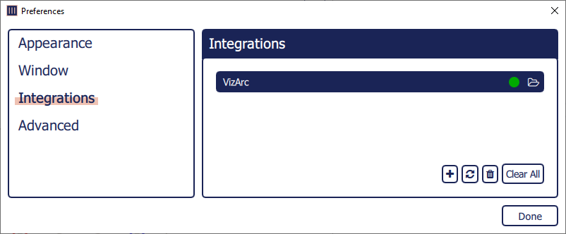

To configure monogram to work with Viz Arc, go to Monogram Creator > Preferences and add the Viz Arc integration.

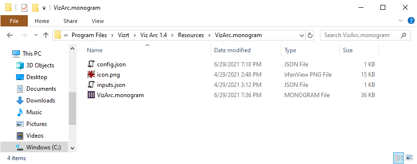

A predefined integration can be found in the Viz Arc program-data folder under Resources/VizArc.monogram.
In the config.json fille, the port can be changed to something else than the 51234 default port.
config.json
"name": "VizArc",
"id": "vizrt.VizArc",
"exe": [ "VizArc.exe" ],
"connection": [
"name": "VizArcConnection",
"type": "udp",
"port": 51234

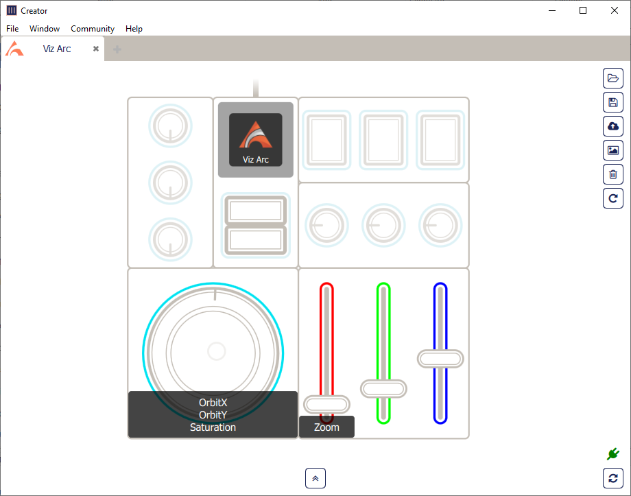

When used with an ORBITER module, the integration can be used to control an NDI PTZ camera using the NDI Action
A sample of connected monogram modules including an ORBITER module.

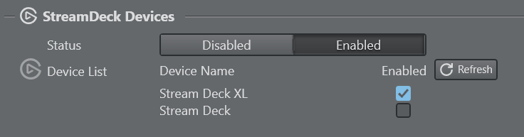

Stream Deck
The Stream Deck Devices section lists all Stream Deck devices connected to the system.
  • Status: Enables or disables Stream Deck device usage.
  • Device List: Lists of all currently connected devices. Use the Refresh button to refresh the list in case a device has been connected or disconnected after starting Viz Arc. Uncheck any device you do not want to use in Viz Arc.

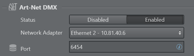

Art-Net DMX
The Art-Net section is used to configure the listening port and interface for Art-Net DMX lighting data.
  • Status: Enables or disables Art-Net listening.
  • Network Adapter: The network interface to listen on for Art-Net messages.
  • Port: The port to use to listen to the messages, the default port is 6454.
