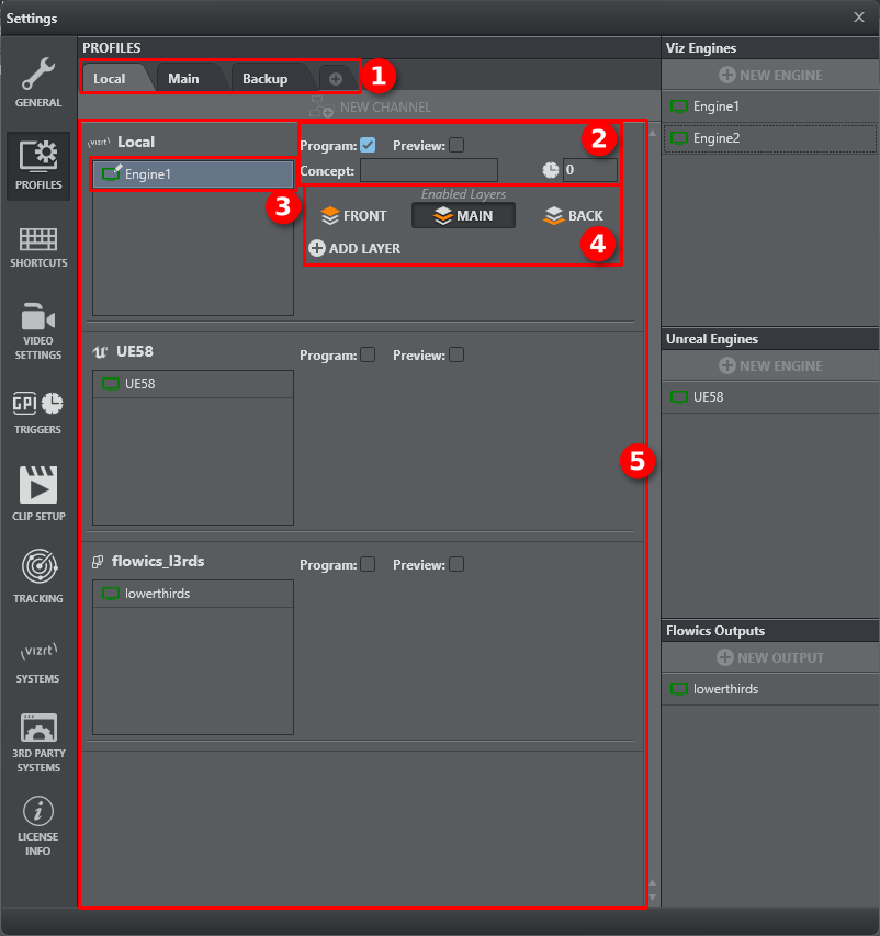

1. Profiles: Used to configure the different groups of Viz or Unreal Engines available for control by the user; these groups are called Channels.
  2. Engine and Channel Settings: Used to configure Program/Preview, the concept and an execution delay for each Engine.
  3. Engines list: Viz Arc is capable of controlling more than one Viz Engine at the same time. For example, when working with multiple tracked cameras. This menu contains all the Engines assigned to a given channel.
  4. Enabled Layers: Layers enabled in the Scene Tools when selecting a channel and selecting into which layer a scene is loaded.
  5. Channels: A channel is a group of Viz Engines (or Unreal Engines) that receive the same commands at the same time. For example, when executing actions or loading a scene.
To access the Profile config menu, press the Profiles icon on the left of the window in the Config panel:

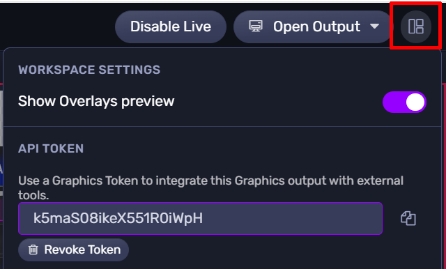

To Add a Flowics Output
  1. Press the NEW OUTPUT icon.
  2. Enter the display name of the new output, the Flowics API URL (default https://api.flowics.com/) and its Graphics API token. The token can be found on the Flowics output control page, under the settings panel:

To Configure an Engine's Settings
image-20260809-220412.png It's possible to assign every Engine as a Program or Preview engine.
image-20260809-220339.png An Engine can also be set as Editing Engine, which means the Engine is used for a scene tree load, or to select and objectify a Transition Logic scene, for example.
image-20260809-220300.png The Concept determines which scene concept is used by the engine when a scene is loaded through the Scene Loader Action or a Template Action. The Execution Delay can be used to delay all commands that are sent to the engine. This can be useful for set-ups involving (for example, AR and Videowall) Engines where output runtimes of the various subsystems are not uniform.

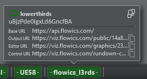

In case of a Flowics channel, you can see the Graphics API token of each output instead of a host and port. Click the small triangle at the right of an output to see more details: the Base URL of the Flowics API and the output's Output, Editor and Control URLs. The copy button next to each URL copies it to the clipboard, so you can quickly open the rendered output, the Flowics graphics editor or the output control page in a browser.

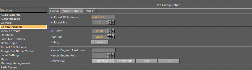

The first two entries show the shared memory communication port settings, which can be used with scripting or SHM. To configure the Shared Memory ports on Viz Engine, go to Viz Engine configuration under Communication > Shared Memory where you can configure UDP and TCP ports for Shared Memory updates.
