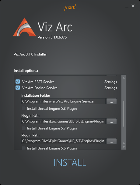

Run the Viz Arc bundle installer and select the Viz Arc Engine Service:
The installer detects any compatible Unreal Engine version and installs the Viz Arc plug-in to the respective Unreal installations.

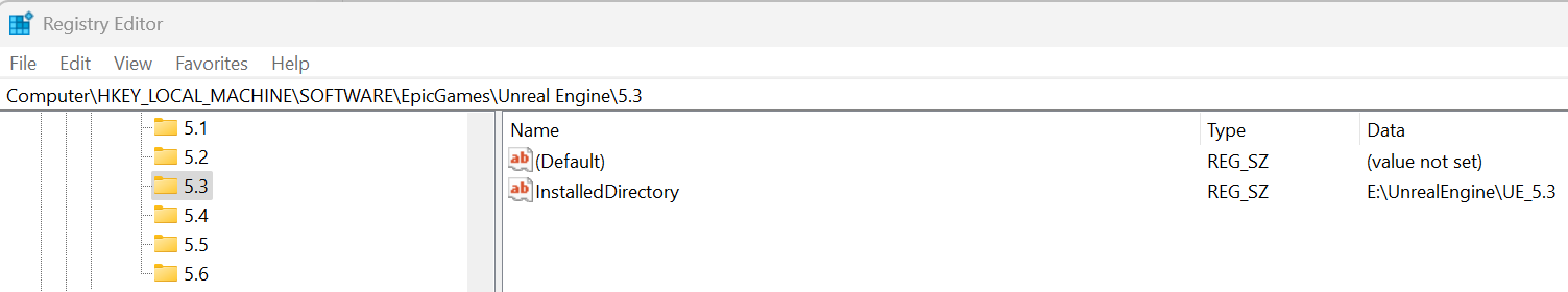

The registry key used is InstalledDirectory and can be found in the registry under:
  • Computer\HKEY_LOCAL_MACHINE\SOFTWARE\EpicGames\Unreal Engine\5.3
  • Computer\HKEY_LOCAL_MACHINE\SOFTWARE\EpicGames\Unreal Engine\5.5
  • Computer\HKEY_LOCAL_MACHINE\SOFTWARE\EpicGames\Unreal Engine\5.6
  • Computer\HKEY_LOCAL_MACHINE\SOFTWARE\EpicGames\Unreal Engine\5.7
  • Computer\HKEY_LOCAL_MACHINE\SOFTWARE\EpicGames\Unreal Engine\5.8

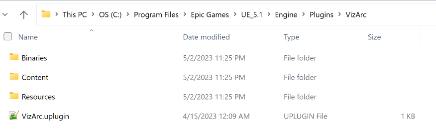

The plug-in gets installed under the subfolder Engine\Plugins\VizArc of the respective Unreal Engine installation (for example, C:\Program Files\Epic Games\UE_5.5\Engine\Plugins\VizArc).
Unreal Registry Entries: On some machines, the registry entries might not be present although the Unreal Engine is installed correctly. This usually occurs when the Unreal Engine installation has been executed without administrative privileges. The registry entries can either be added manually or the plug-in can be installed manually (see below).

The plug-ins can be copied manually to the Unreal Engine plug-in folder. After installation of the Unreal Loader, the plug-ins can be found under the folder C:\ProgramData\vizrt\VizArc\Resources\Unreal.
Select the version to install and copy the entire VizArc folder to the Unreal plug-in destination folder. For example, copy C:\ProgramData\vizrt\VizArc\Resources\Unreal\5.3\VizArc to C:\Program Files\Epic Games\UE_5.3\Engine\Plugins\VizArc.
Warning: Different versions are not compatible. Always copy the plug-in matching the Unreal Engine version.

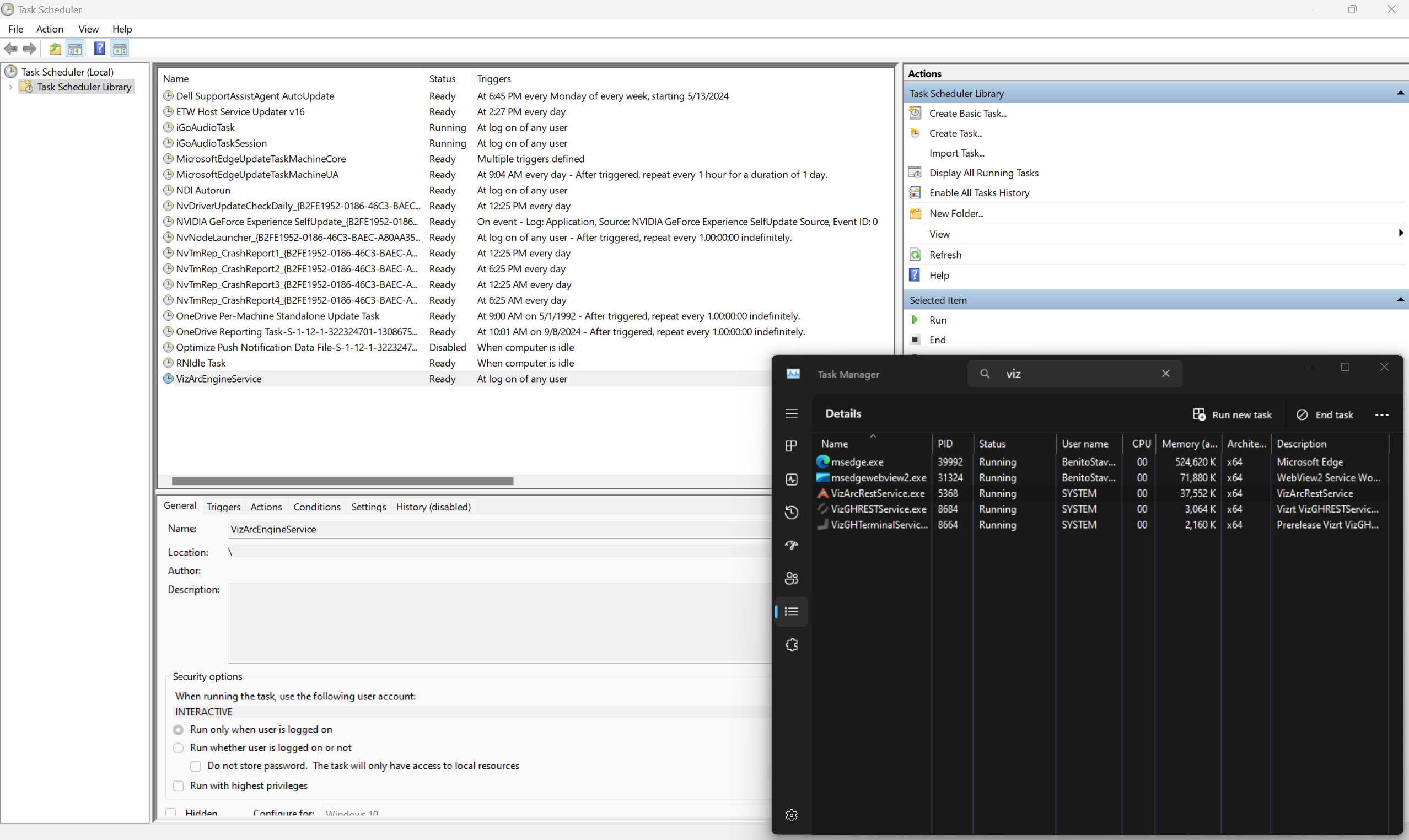

After successful installation the Unreal Loader starts automatically and whenever a user logs on to the system it starts as a scheduled task. To see the task settings execute the windows command taskschd.msc.
Under the name VizArcEngineService all the settings of the scheduled task can be reviewed. Check the task manager whether the process is running. The process can be terminated and started using the context menu on the scheduled task.

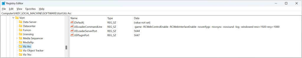

The first time you start the service, registry keys are generated with default values for communication ports and unreal startup parameters. The registry key can be found in HKEY_LOCAL_MACHINE\SOFTWARE\vizrt\Viz Arc.
The relevant keys and their default values are:
  • UELoaderServerPort: The communication port used by Viz Arc to talk to this service. Default is 5644.
  • UELoaderCommandLine: The default command line suffix added on each Unreal Engine start up. Default is -game -RCWebControlEnable -RCWebInterfaceEnable -noverifygc -novsync -nosound -log -windowed resx=1920 resy=1080 -RenderOffScreen.
Note: The default resx and resy are configured to be HD format. Change this accordingly if your output format is different. Add the log flag to launch the engine in offscreen mode with the output console only.
Render off-screen: The -RenderOffScreen switch is part of the default command line, so the rendering takes place off screen (recommended when used together with the Viz Engine integration). Remove the switch when the Unreal render window should be visible on the machine.
  • UEPluginPort: The communication port to be used by Viz Arc to talk to the Viz Arc Unreal Engine Plugin. Default is 5647.
Note: The UEPluginPort is not used directly by Unreal Loader.

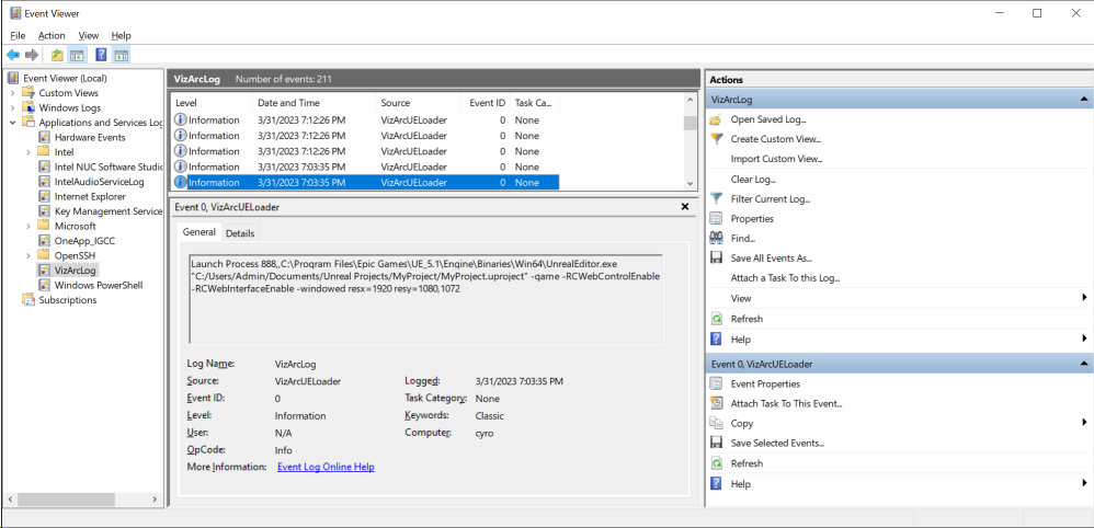

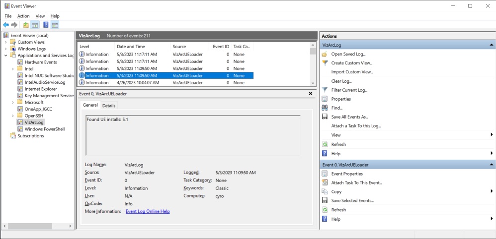

The Windows event viewer contains some basic logging of the service. Under Application and Services you can find a VizArcLog that contains all relevant log entries:
Among other events the event viewer logs which project and map is loaded through Viz Arc and which Unreal Installations have been found after start-up. The Unreal Loader identifies the Unreal installations based on the registry keys found in Computer\HKEY_LOCAL_MACHINE\SOFTWARE\EpicGames\Unreal Engine\.
