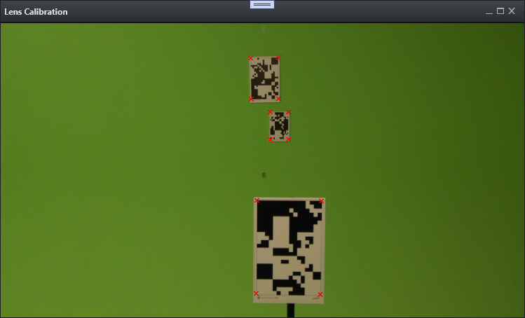

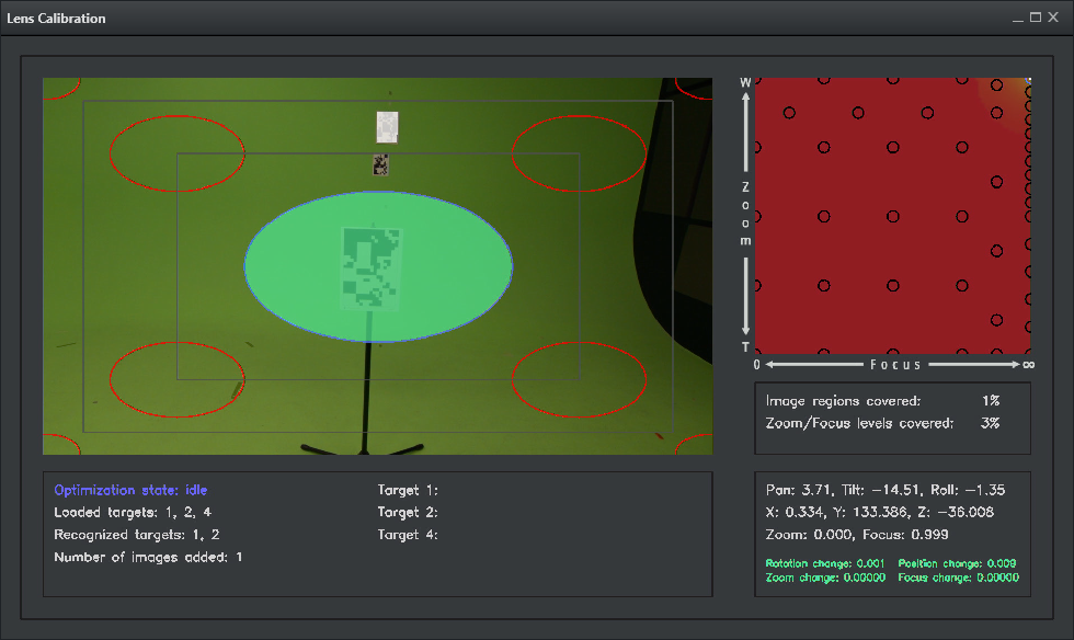

The Open Coverage button launchs an NDI window showing the calibration tool interface.

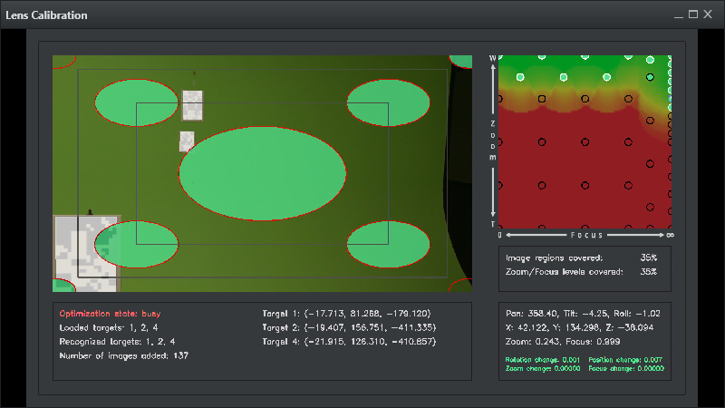

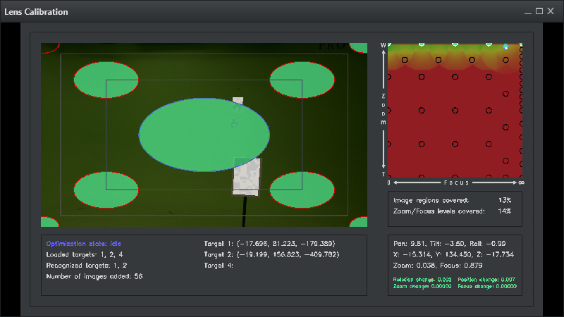

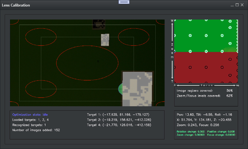

The coverage panel used for the actual calibration is divided into five sections.

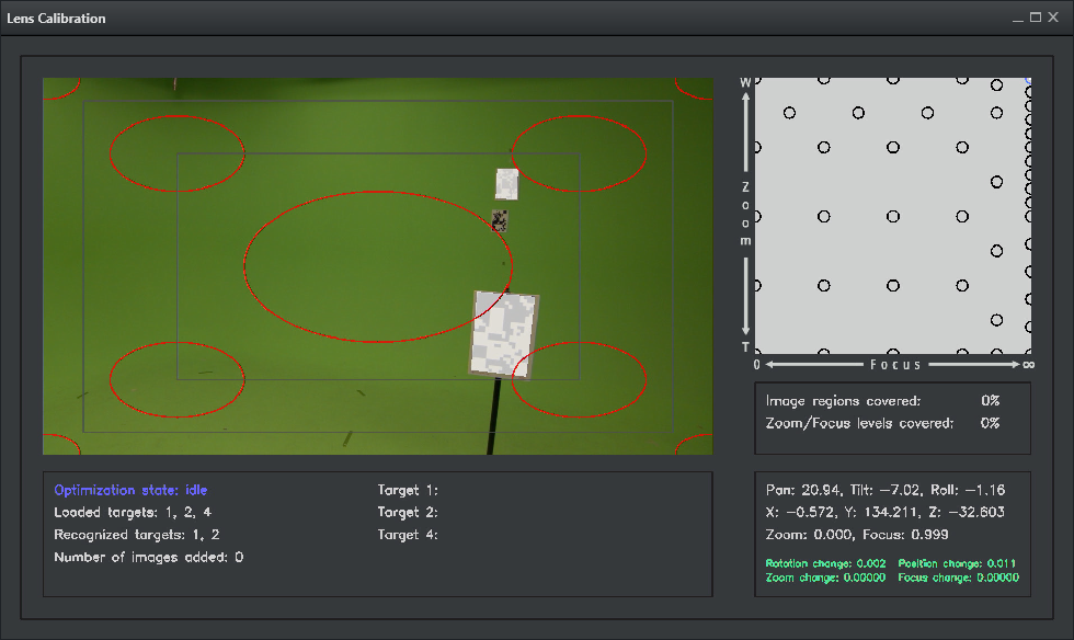

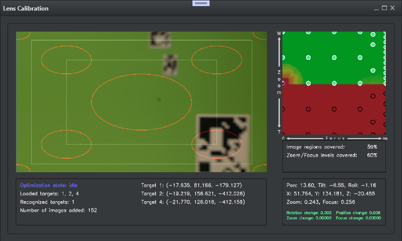

The video panel shows the camera frame, the detected targets rendered as white rectangles on top of the real targets, and nine elliptical shapes which represent the calibration hotzones for the targets to be detected. Once the camera is stable and a target is detected within a hotzone, the hotzone turns green, indicating that the process extracted a useful image covering this image area, with a target at the current zoom/focus level. The hotzones only become visible if the current camera zoom and focus are within one of several predefined areas as described below.

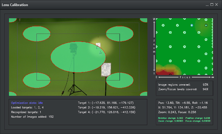

The graph on the right displays a heatmap of the calibrated lens related to zoom and focus. Red indicates an insufficient calibration, while green represents a fully calibrated area. The small circles are predefined zoom/focus areas, lens points, where the calibration can be done. While a rather dense distribution of zoom/focus points are defined by default, manual points can be added during the calibration if necessary (see Adding Points).
For each of the zoom/focus areas in the heatmap, the user should cover all of the hotzones displayed in the video panel.
The three other panels provide information about:
Covered calibration status in %.
Detected targets.
Incoming tracking data.

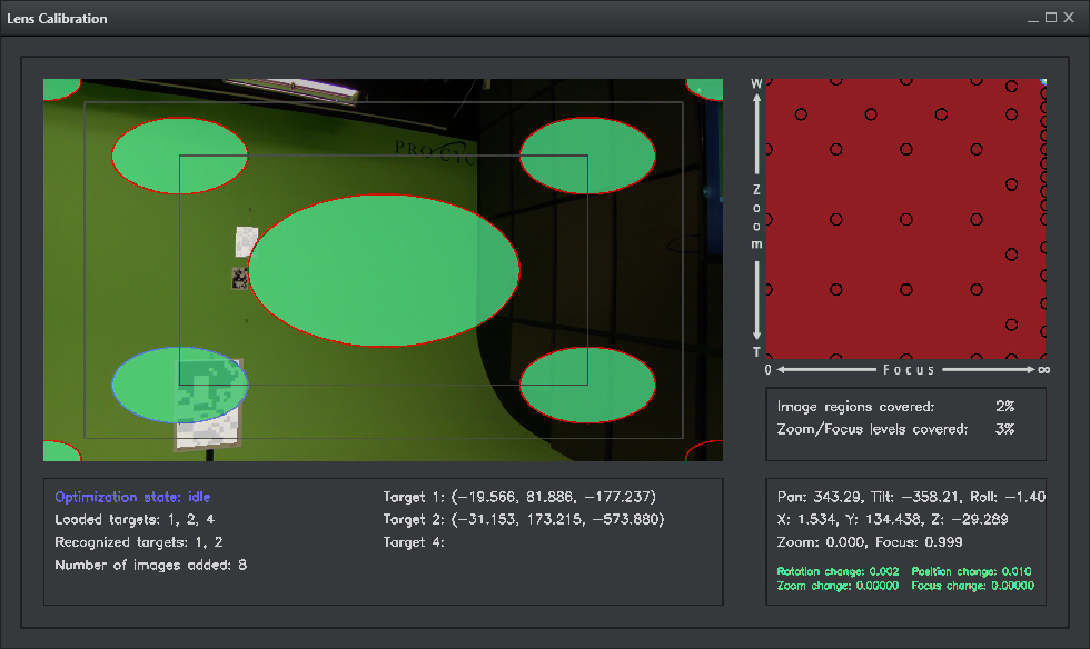

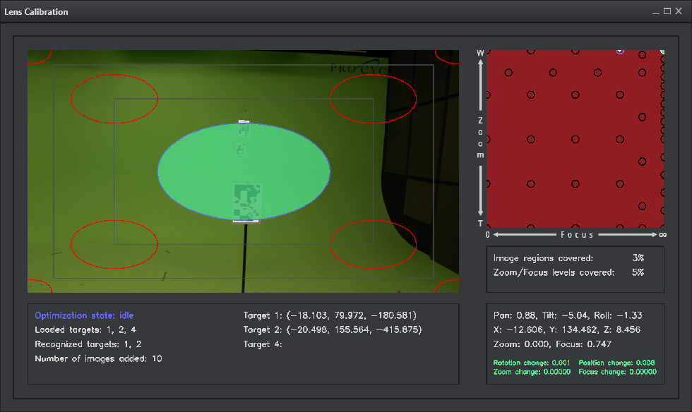

Start with the first point at zoom 0% and focus infinite (top right). If the white indicator for Focus is on the right side, flip the Focus direction (invert) in the Camera Rig in Studio Manager.

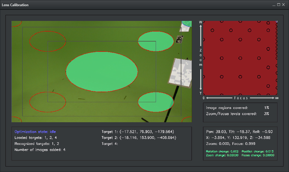

Start filling in circles/hotzones by panning/tilting the camera, so that the detected targets are within these areas. Try to vary the targets a bit between the different hotzones. As soon as a target is inside the hotzone, hold the camera still until the area is green.
Repeat these steps until all 9 hotzones are green, if possible. There might be unreachable areas, depending on Zoom and Focus level. In this case, leave the hotzone empty, a small amount of missing areas per lens should not affect the whole calibration result.
Once all of the hotzones are covered, the current zoom/focus area is covered. If for some reason it is not possible to cover some of the hotzones, the process still works. However, for optimal results, the process should cover all of the hotzones for as many zoom/focus areas as possible.

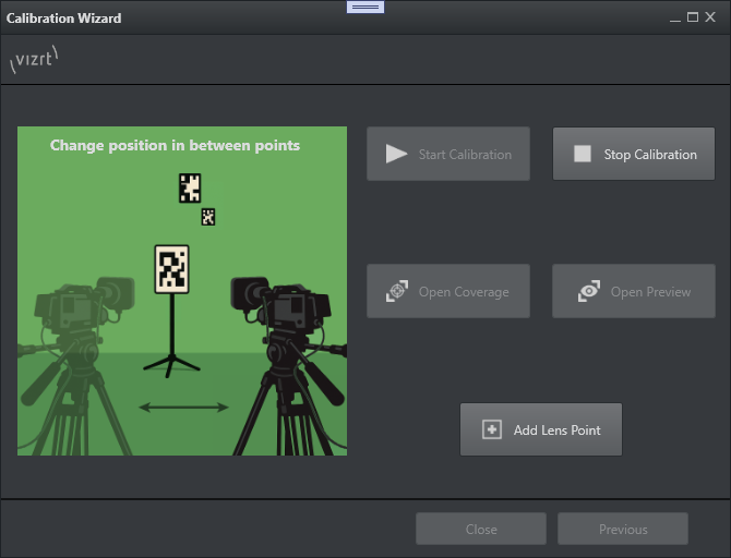

For optimal results, change the camera position at least when moving from one zoom/focus area to the next one.

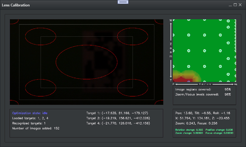

The UI starts drawing green areas indicating a good coverage of this lens area.
Note: This starts after a few points are made first.

Change the iris and try to use lights on the targets to deal with blurry out of focus images (target detection stops working once the images are very blurry).

When the camera is zoomed in and the focus is close to zero (the bottom left of the zoom/focus coverage), it may become impossible for the calibration process to still reliably detect targets. This is expected, but the user should try to cover as many of those zoom/focus areas as possible.
Adding Points
Once all of the zoom/focus areas are covered, the user may interact with the camera and check the quality of the lens parameters by moving the camera, changing the rotation, the zoom and the focus of the camera.
The quality of the lens can be verified in the lens preview window, and the test scene. If there are zoom/focus areas where the quality is not as desired, the user can add additional zoom/focus areas to the calibration process to improve the results. Ideally, the user should add a zoom/focus area where the quality of the current lens calibration is the worst.

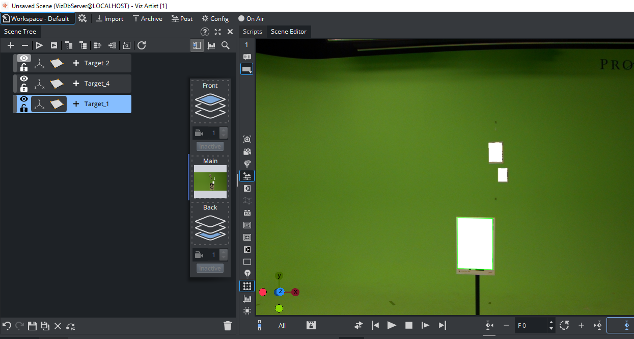

Test Scene
If the calibration was started through the wizard, a test scene is created automatically on start showing the rendered rectangles with the current calibration result.
The accuracy of the corners visualized in the lens preview window, should be the same as the accuracy of the rectangles rendered in the test scene. If the accuracy is not the same, it means there is an inconsistency between the results computed by the lens calibration process and the Viz Engine.

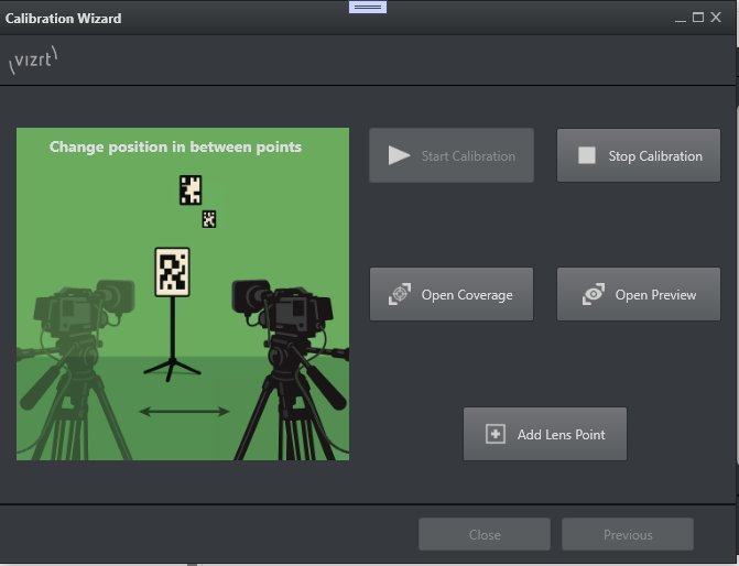

Stop Calibration

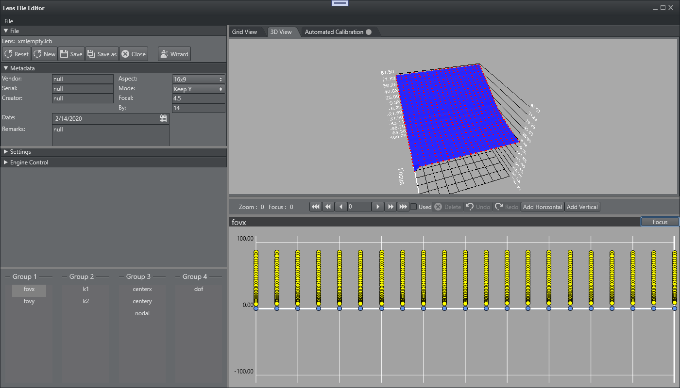

Once all possible points are recorded, finish the calibration by pressing Stop Calibration. The Wizard closes and the lens file is automatically loaded to the current lens rig.

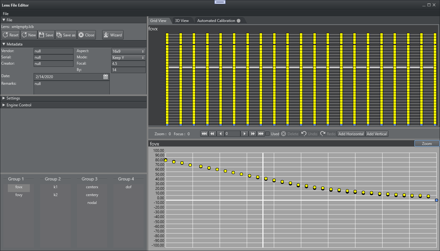

The file is displayed in the Lens File Editor. Please note that automated lens files cannot be modified in the lens file editor.

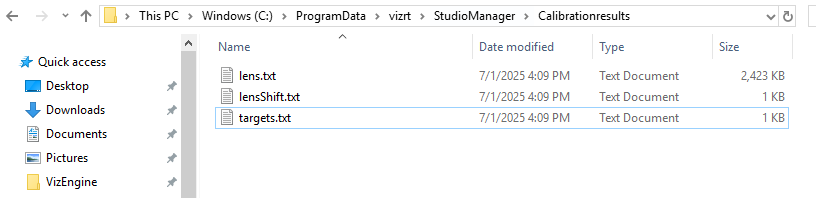

The raw lens files and other calibration results are temporarily stored in C:\ProgramData\vizrt\StudioManager\Calibrationresults.

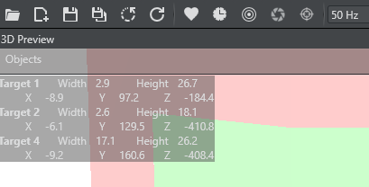

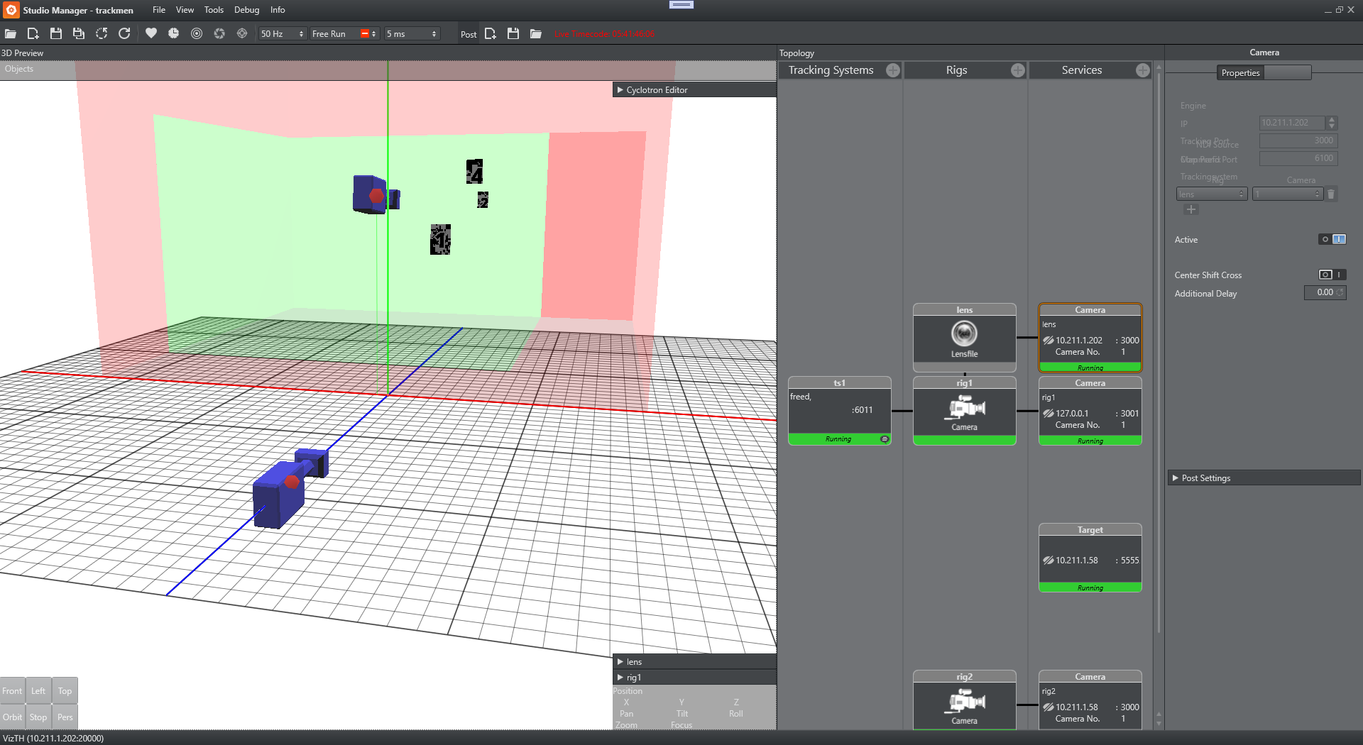

The Studio Manager displays the used targets in the 3D preview panel:
The HUD can be activated to show the detected Targets center coordinates.

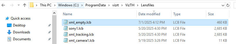

Lens files are automatically saved in the lens files folder (C:\ProgramData\vizrt\VizTH\Lensfiles\).

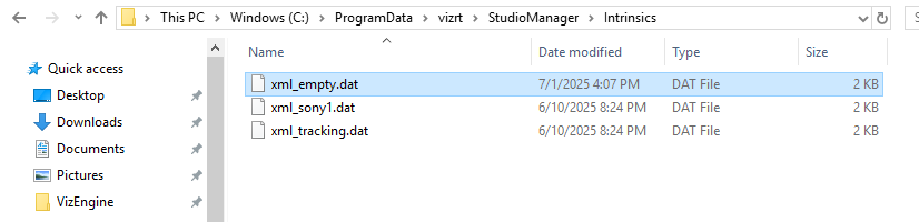

During the automated lens file calibration process, a intrinsics file for each lens is stored in C:\ProgramData\vizrt\StudioManager\Intrinsics.
This file is required if the lens is used for target detection later on. Please note that the intrinsics file requires the same file name as the lens file. This needs to be considered in case lens files get copied or altered manually.
