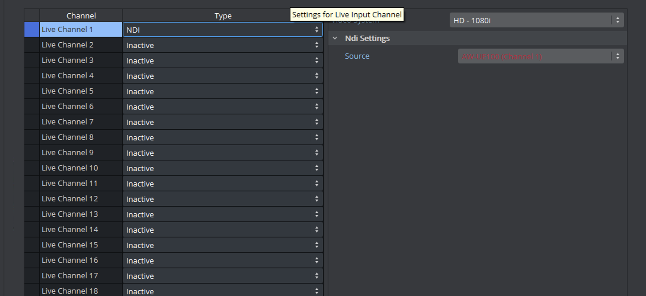

- Only one NDI input source is supported.
- The network bandwidth needs to fit your needs. It is highly recommended to use a dedicated network for the NDI transport.
- Only tested and certified PTZ cameras are supported. See Supported NDI Cameras.
- Make sure no other applications connect to your NDI source. This also includes NDI Studio Monitor, for example.

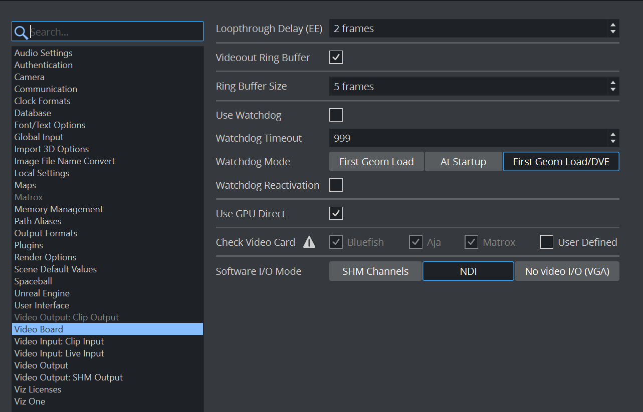

To use NDI in your Virtual Studio, make sure the following conditions are fulfilled:
- In the Viz Engine Settings, all video boards must be deactivated and NDI must be selected.
- As the Sync source settings are not available after switching to NDI. In the configuration file under the section Genlock, Genlock must be set to - 2.
