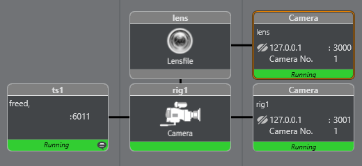

Starting with a default rig setup: a tracking system connected to a camera rig with a lens file node as a parent, containing the previously described needed offsets/adjustments to receive the cameras CCD position (see also Configure Topology).
Two services are added, one to Viz Engine, and a second one to send the tracking data to the calibration tool.
The port for the second service needs to be set to 3001. When using the Wizard, this service is created automatically.

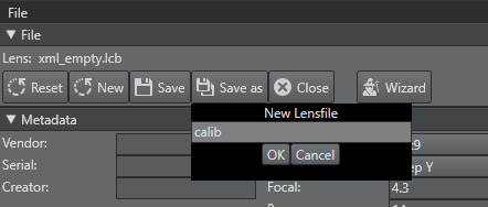

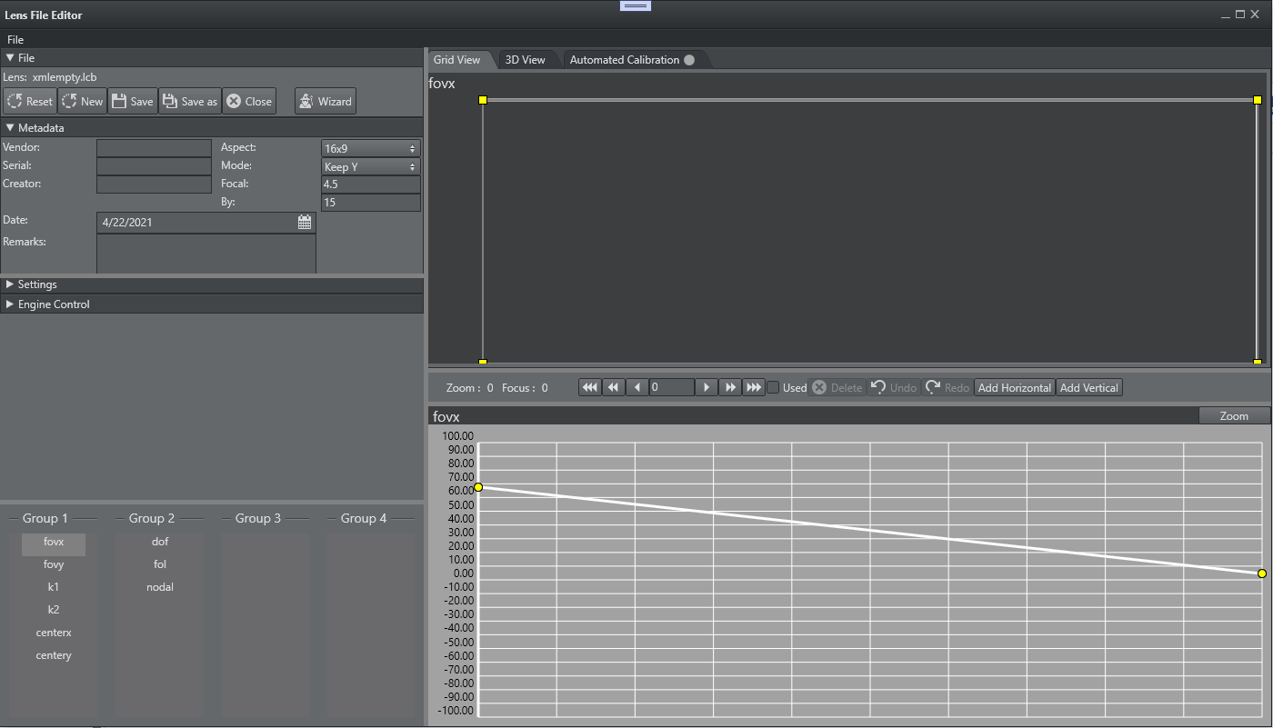

Open Lens File Editor

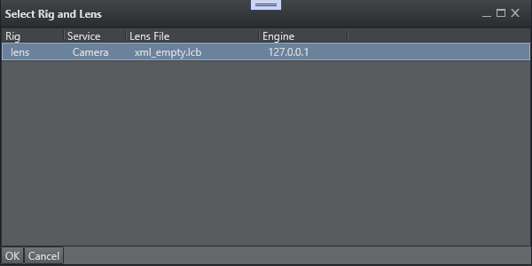

Choose the lens file assigned to the rig to be calibrated..
With the lens file editor you can reset the current lens, or create a new one to start from scratch. Please note that a reset, results in overwriting the currently loaded lens file, once saved.
Create a new file if necessary, and start the Wizard, or continue with the Automated Calibration Panel.

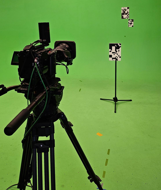

Prepare Targets
The hard plastic targets come in two fixed sizes (large and small), but any size can be used.

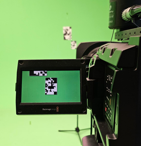

Targets should be placed in front of the camera, no exact positioning, or any measurement is needed. At least two targets should be visible when the camera is zoomed out.
A smaller third target should be added for zoom lenses, if the default A4 target does not match the cameras FOV, when fully zoomed in.
