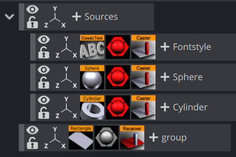

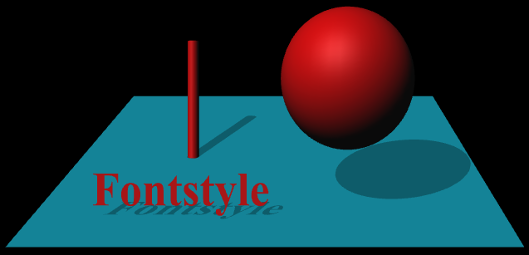

To Cast a Shadow
Add a group container to the Scene Tree.
Name it
Sources.Add a Fontstyle and the Sphere and Cylinder Geometries as Sub-Containers of Sources.
Add a Material and Shadow Caster to each Sub-Container.
Add a Group Container at the same level as the Sources Container
Add a Rectangle Geometry, a Material and Shadow Receiver to it.
Position the Rectangle and the other objects such that the Sphere, Cylinder, and Text casts a shadow on the rectangular surface.
