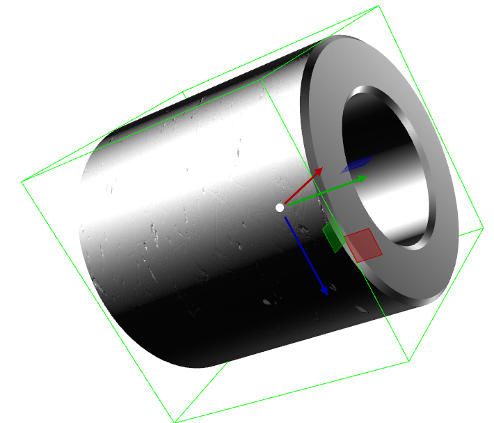

To Create a Cylinder
Create a new group container.
Add the Cylinder or Cylinder3 plug-in.
Open the Cylinder editor.
Set Hole to
50.0.Add a material and/or an image to the same Container.
Open the cylinder editor.
Set Rotation Y to
75.0and Z to90.0.
