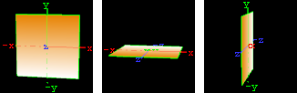

Mode: Sets the orientation of the plane to XY, XZ or YZ.
