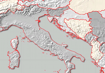

The 3D Border plug-in draws the borders with fixed/scaling width options.

Draw: Sets the border type drawn by the plug-in. Available options are Country, Region and All.
Country: Draws country borders only. When Country is selected, additional options are made available: Country, Coastline and Both (see Select).
Region: Draws region borders only. When Region is selected, additional options are made available: Region, Sub Region and Both (see Select).
All: Draws all available borders retrieved by 3D Map Setting.
Select: Displays the available Country or Region options when either of those two options is selected.
Country: Draws inland country borders only.
Coastline: Draws country coastline borders only.
Both (Country & Coastline): Draws both inland and country coastline borders.
Sub Region: Draws sub region borders only.
Both (Region & Sub Region): Draw both region and sub region borders.
