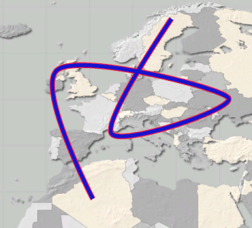

The 3D Line plug-in has several graphic uses for drawing lines:
Drawing shape lines created in the Map Editor (WME) when selecting a map. A line design is created in the hierarchy and defined in CWMClient (see 3D Objects and Shapes).
Drawing a line between label locations, defined in the WME, from the first label in the list to the last label in the list. Labels in CWMClient must be enabled when using this mode.
Drawing a line along hop points defined in a Navigator scene. The line follows the path of the Navigator animation between the hops.
Drawing a line using a Long/Lat coordinates list. The line is drawn from the first Long/Lat pair to the last.
