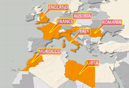

The 2D Label plug-in creates two dimensional labels on the map, based on labels received from the selected map or automatically generated labels generated by the Label Manager according to the map information received from Navigator. It must have a container with text content as a child to work properly.
Note: When adding 2D Label to a container, World Position and Alpha are added automatically to the same container. Label Manager has to be added manually to the scene when using 2D Label without Navigator.

Pivot: Defines the label’s object shape and location in relation to the label’s geographic location:
Pointer: Includes a pointer going out of the label background in the label object and points at the label’s geographical position. When selected, additional parameters are enabled: Width and Connection Bevel.

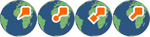

Shape: Defines the pointer shape:
None: Gives the pointer a sharp point shape.
Circle: Gives the pointer a circle at the tip of the pointer.
Square: Gives the pointer a circle at the tip of the pointer.
Straight: Gives the pointer straight lines at the tip of the pointer.
Size: Defines the size of the shape at the tip of the pointer. The parameter is only enabled if the pointer is selected and a tip shape is set.
