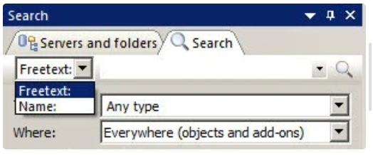

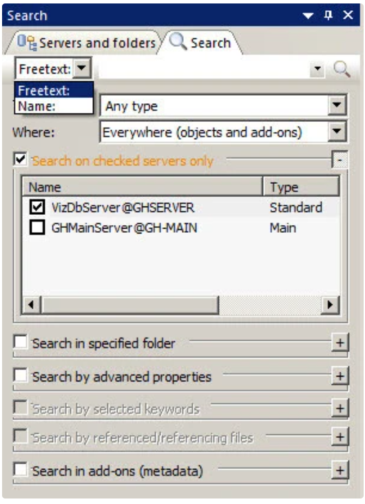

To Search Using Free Text Search
  1. In the Search panel, select Freetext in the Name / Freetext drop-down list:
  2. Enter the search parameters in the Freetext field. To achieve the best search results, refer to the Search string syntax.

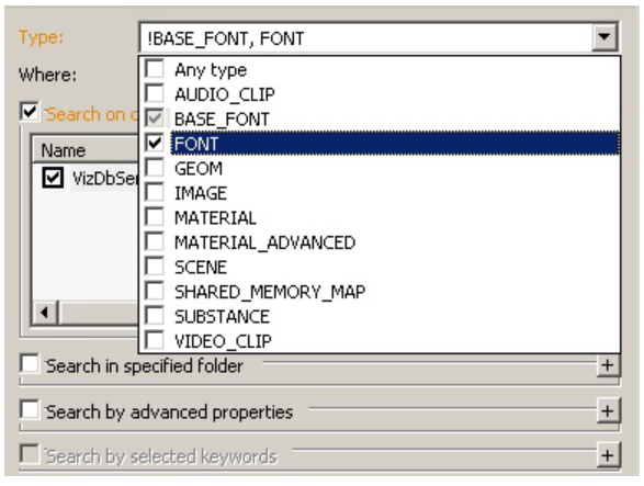

  3. The Type drop-down list is used to narrow the search to a specified set of file types only. The type field can be used to include or exclude one or more of the following types:
    • Any type- the default mode, all elements are included.
    • AUDIO_CLIP
    • BASE_FONT
    • FONT
    • FONT FACE and FONT Files (for Viz Engine 4.x and higher)
    • GEOM
    • IMAGE
    • MATERIAL
    • MATERIAL_ADVANCED
    • MATERIAL_DEFINITION (for Viz Engine 4.x and higher)
    • SCENE
    • SHARED_MEMORY_MAP
    • SUBSTANCE
    • VIDEO_CLIP
    Right clicking the type excludes it from the search, identified by a dimmed check mark. For example, here the BASE_FONT type is explicitly excluded, while the FONT type is included in the search:

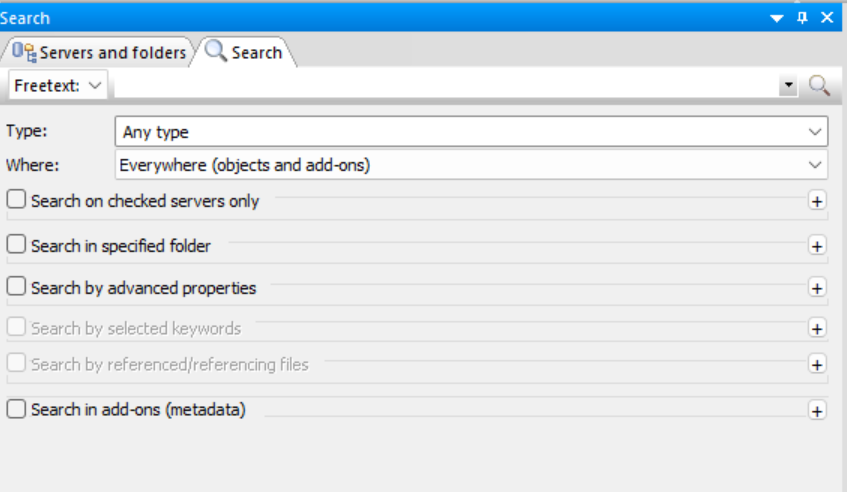

  4. Select where to search in the Where drop-down list:
    • Everywhere (objects and Add-ons)
    • In objects (files and folders only)
    • In add-ons (metadata only)
  5. If the GH Manager is logged on to more than one server, the Search on checked servers only box can be used to specify which server(s) the search is performed on. If checked, at least one server needs to be selected for the search to run.
  6. If the GH Manager is logged on to only one server, or if multiple servers are logged on to and only one is selected in Search on checked servers only, the folder which is to be searched can be specified as required:
    1. Check the Search in specified folder check box.
    2. Select the folder to be searched.
    3. Check the Search in Sub-folders check box to run a recursive search.
  7. To search by last modified date or date of creation, check the Search by advanced properties check box. The search by date approach can be narrowed further by specifying from date, until date, and between dates:
  8. Press ENTER or click on the search icon to run the search.
Note: Click on the image-20240912-132411.png icon to expand or collapse the search criteria selection for each category.
Search using all available search criteria can only be performed on one server at a time.

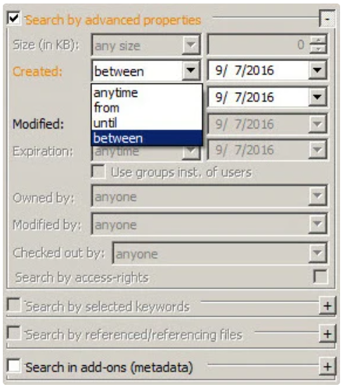

To Search by Advanced Properties
  1. Check the Search by Advanced Properties check box.
  2. Enter search parameters as required:
    • Size: Searches for files that are either at least, at most, or between the defined size(s) in KB.
    • Created: Searches for files created either after, before, or between the defined date(s).
    • Modified: Searches for files modified either after, before, or between the defined date(s).
    • Expiration: Search for files expired either after, before, or between the defined date(s).
    • Use group instead of users: If selected, the next four options apply to groups instead of users.
    • Owned by: Searches for files owned by user.
    • Modified by: Searches for files that was last modified by the defined user.
    • Checked out by: Searches for files checked out by the defined user.
    • Search by access rights: If selected, searches for files that have write permission either on user (UW), group (GW), or world (WW) level.
  3. If required, add more search criteria.
  4. Press ENTER or click on the search icon to search.
Note: Only registered users/groups are available from the lists.

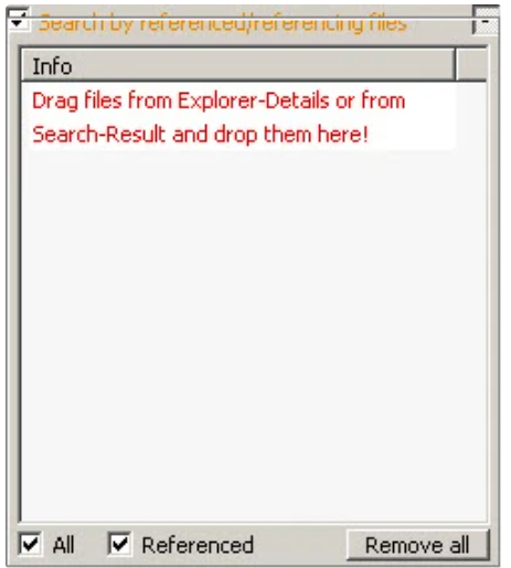

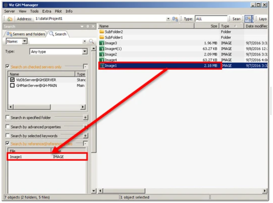

To Search by References
  1. Check the Search by Referenced/Referencing Files check box.
  2. Drag and drop a file or files into the drop area.
  3. Make sure that the Reference check box is checked.
  4. Check or uncheck the All check box:
    • Checked: Search for Scenes or Geometries which contain all search files.
    • Not checked: Search for Scenes and Geometries which contain at least one of the search files.
  5. If required, add more search criteria.
  6. Press ENTER or click on the search icon to search.
Tip: Use Search by References to search and replace Images or Fonts referenced by several Scenes or Geometries, with different Images or Fonts. For example, if a company logo changes, search for the image references, select each required Scene and replace the image (see Replace File References).

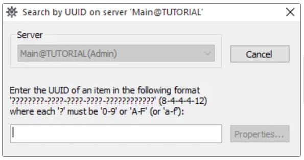

Search by UUID
The Graphic Hub keeps track of all items in the database by assigning Universally Unique Identifiers (UUIDs). This also applies to deployed items, which means that if an item is deployed from one server to another, it has the same UUID on both servers. When the UUID of an item is known, it can be looked up very quickly using the Search UUID on server.
To Search by UUID on Server
  1. Open Graphic Hub Manager, and log on to the server(s) that is to be searched.
  2. From the Tools menu, select Search by UUID.... This opens the Search by UUID on server window.
  3. If you have logged on to more than one server, select the server to perform the search on in the Server drop-down list.

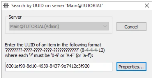

  4. Enter the UUID in the editable text field. This text field accepts valid alphanumeric characters only. Valid input are digits in the range 0-9, and letters in the range A-F. The search is not case sensitive, and dashes are added automatically:
  5. Click Properties... to perform the search.
    • If an item with the provided UUID is found, its Properties page opens.
    • If no item on the database matches the provided UUID, you are alerted by a popup window.

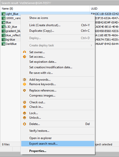

To Export Search Results
To export or copy search results for external use one can:
  • Copy (CTRL + C) from explorer view (files and folder/projects) and search results (explorer and archive search) to the clipboard to be able to paste it to external applications (for example, Excel).
Information: The Copy/Paste option is only available on a certain server, not not on the "All Servers Tab".
  • Export CSV search result (explorer and archive search) by right clicking into search result view and selecting Export search result... and selecting the location where the .csv file should be written to.
