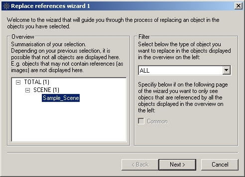

  1. In the Graphic Hub Manger, right-click the required file or files and select Replace References...
    The Replace References wizard opens.
  2. Optional: In the Filter panel select which type of object to replace from the drop down box. Options are:
    • All
    • Image
    • Font
    • Geometry
    • Audio
  3. Click Next.

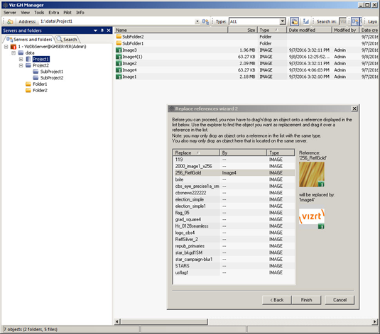

  4. Drag replacement files onto the listed files of the same type.
  5. Click Finish. The Action Log for replacing references is shown.
  6. Click Replace.
