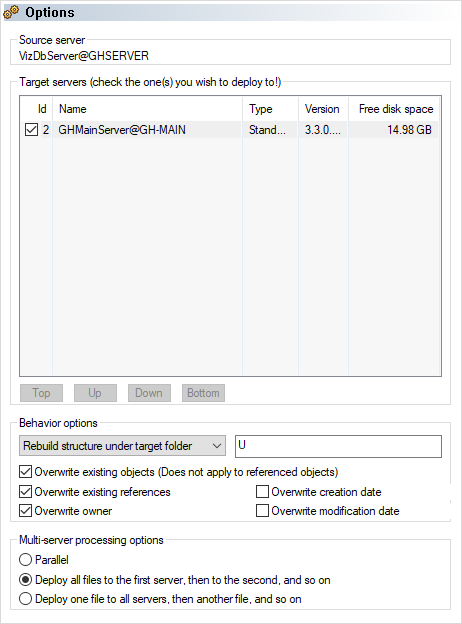

The Options panel shows a deploy task configuration where folder B of Server 1 is deployed to folder U of Server 2.
The Options panel offers various settings to configure the deploy task:
  • Behavior options
    • Rebuild original structure: The original folder structure and any folder links for the selected folder or project is recreated at the root level of the target server, including any parent folders. The selected folder or project is rebuilt including all sub-folders, sub-projects and objects contained therein.
    • Rebuild structure under target folder: The original folder structure is recreated using the target folder as root level.
    • Copy to target folder only: Recursively copies files only from the selected source folder to the selected target folder. See also Copy to Target Folder Only.
    • Overwrite existing objects: If there is a file in folder B or any of its sub-folders and the same file exists on the destination server (a file with the same UUID), then the file is overwritten on the destination if the content is different.
    • Overwrite existing references: If there is a file F in folder B or any of its sub-folders with a reference to file R and file R exists on the destination server (a file with the same UUID), then file R is overwritten on the destination if the content is different.
    • Overwrite owner: If there is a file in folder B or any of its sub-folders and the same file exists on the destination server (a file with the same UUID), then the owner of the destination file is changed if it differs from the source file.
    • Overwrite creation date: If not chosen, files and folders in the deployed structure have their creation dates set to the deployment time if they were not present. If chosen, they preserve the creation dates of their source objects.
    • Overwrite modification date: If not chosen, files in the deployed structure have their modification dates set to the deployment time if they were not present. If chosen, they preserve the modification dates of their source files.
  • Multi-server Processing options
    • Parallel: If multiple destinations are selected, the destinations are synchronized in parallel.
    • Deploy all files to first server, then to the second, and so on: If multiple destinations are selected, the destinations are fully synchronized one at a time.
    • Deploy one file to all servers, then another file, and so on: If multiple destinations are selected, missing files are copied to all destinations one at a time.

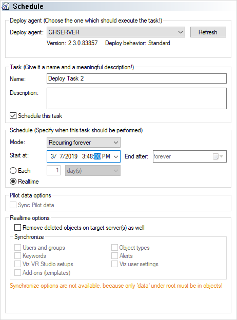

      The Schedule panel shows the settings that are available to schedule the new deploy task.
Apart from the general settings, Rebuild original structure/ Rebuild Structure Under Target Folder tasks also support the deletion of files on the target server. Files are only deleted if they are removed from the source folder B or any of its sub-folders and the file also exists on the destination server in folder U or any of its sub-folders. If the file on the destination also has folder links outside folder U, then only the folder links inside the target structure are removed.
  • Deploy agent: Select the Deploy Agent to be used. The version number and deploy mode of the selected Deploy Agent is shown below the drop down box.
  • Task: Enter a name and description for the new deploy task.
    • Schedule this task: Click to enable or disable the Schedule field.
  • Schedule: Create a schedule for the new deploy task:
    • Mode: Select either Once, Recurring or Recurring forever
    • Start at/End after: Options depend on the set Mode. Set the start and finish of a new deploy task
    • Each: Select how often the task should start from the drop down box.
    • Real-time: Click to enable or disable the Real-time options field.
  • Real-time options
    • Remove deleted objects on target server(s) as well: If ticked then not only newly created files or modified files are deployed to the target server (Graphic Hub), but also files that get deleted on the source server (Graphic hub) are also removed/deleted on the target server.
    • Synchronize: Synchronize options can be chosen separately. Check each box as required. The Data panel shows that folder B is used as source for the new deploy task.
