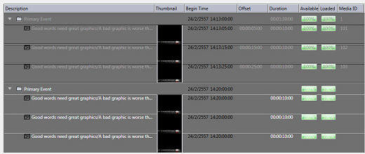

The playlist currently has six states for elements that reside inside the playlist. Each of these states uses a color on the playlist elements to provide a visual indication of their state:
Normal state: The state of an un-played element. Elements are shown in White text.
Played state: The state of an element that has been played out at least once. Elements in are shown in Gray text.
Cue state: The state of an element in a group has been called by MSE, to prepare for playing. These elements are shown in Yellow.
Pre-queue state: The state of a next element that will start playing within 5 seconds. Elements are shown in Orange.
Playing state: The state of an element that is currently playing. These elements are shown in Green. The cue state of a playlist that is activated by an external trigger has a yellow arrow in front of its element, otherwise the playing state has a green arrow in front. External triggering can be a VDCP-signal from the automation system, for example.

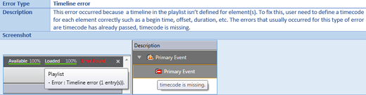

Timeline error:

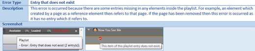

Entry does not exist:

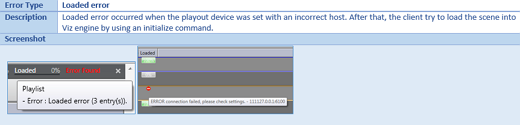

Loading error:

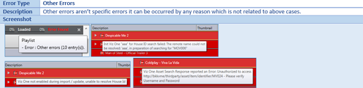

Other error types:

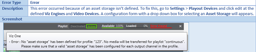

Viz One specific errors: A Viz One Error is an error related to an asset storage. There are specific details on the solution in the tooltip.
