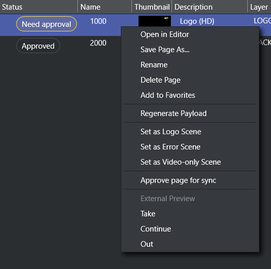

Pages Context Menu
  • Right-clicking a selected Page opens the following context menu:
  • Open in Editor: Opens the Template Editor for updating the page or saving it as a new page, based on the same template.
  • Save Page as: Creates a page based on an existing page. The page can be opened in the Template Editor for editing.
  • Rename: Changes the name of  the selected page. Duplicate page names are not allowed.
  • Delete Page: Deletes the selected page(s).
  • Add to/Remove from Favorites: Adds or removes the page from the pre-defined Favorites filter, see To add a template or page filter.
  • Regenerate Payload: Regenerate the internal payload as set via Page Editor or Page Content Filling
  • Set as Logo Scene: Sets a selected page as the default Logo Scene that can be controlled from the toolbar.
  • Set as Error Scene: Sets a selected page as the default Error Scene that can be controlled from the toolbar.
  • Set as Video-only Scene: Sets the selected video scene as the default video-only scene that can be controlled from the toolbar.
  • External Preview: Shows the scene on your defined preview Viz Engine.
  • Take: Immediately takes the page on-air on your program Viz Engine.
  • Continue: Continues the page on-air on your program Viz Engine.
  • Out: Immediately takes the page off-air (hard cut) on your program Viz Engine.

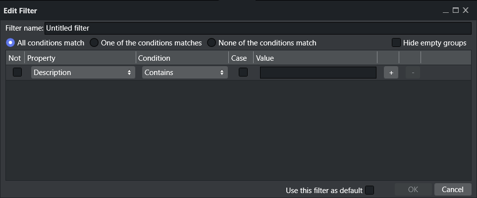

Template and Page Filters
The Templates and Pages panels allow you to add filters to quickly sort the list of templates or pages.
To add a Template or Page filter
  1. Click the funnel icon, and click New.
    This opens the Edit filter panel.
  2. Enter a Filter name.
  3. Select if the filter should apply when:
    • All conditions match.
    • One of the conditions matches.
    • None of the conditions match.
  4. Continue to define your filter by adding one or multiple conditions.
    • The list of templates or pages is filtered as you define your conditions, allowing you to verify that the filter is configured correctly.
Note: There is also a built-in Favorites filter.
To manage a Template or Page filter
  1. Select your filter.
  2. Click the funnel icon, and from the menu click Edit or Delete.
