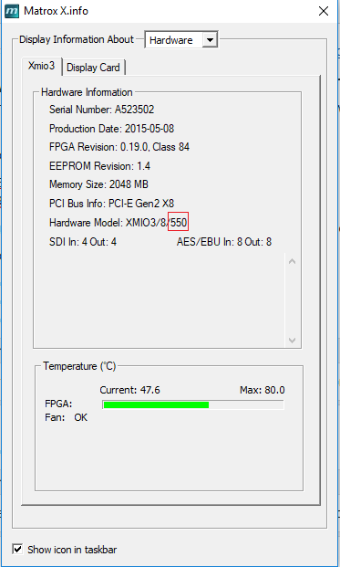

Note: All the above boards should be upgraded to enable recording with different codecs. To check which upgrades the board has available, use the Matrox Utils in the task bar and check if the board has 500 or 550 upgrade applied (for ProRes). If the board does not have this upgrade, this must be ordered. Additionally, to receive RTP/H.264 the Matrox M.264 must have the RTP upgrade. Refer to Recording RTP/H.264 Stream for more information.
