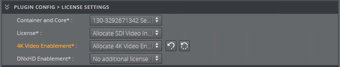

Basic Setup
These are the steps to set up Channel Recorder licensing:
  1. Install Channel Recorder with the bundle installer (CodeMeter Runtime is included in the bundle).
    1. Configure CodeMeter with the Vizrt Licensing Service or the CodeMeter WebAdmin (can be opened from the CodeMeter Control Center) or through http://localhost:22352/.
  2. Configure the license system for the corresponding plugin instance in the Service Host web interface (http://localhost:9000/)
Note: In the Container and Core selection compatible licenses are searched and shown. This depends on the CodeMeter configuration. If a license with share mode exclusive is already allocated on this host then it is listed, even if it is not compatible (for example, Viz Engine combination feature). The reason is that the license is locked for any other processes on this host and cannot be queried for license details, thus listed by default.
Please refer to the Viz Licensing Administrator Guide for detailed information regarding installation and operation of WIBU Licensing.
