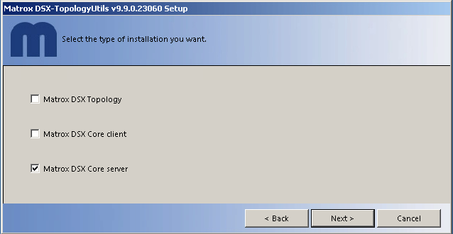

Steps for Installing the Server Machine
  1. Obtain the dongle and the licenses file from Matrox.
  2. Install DSX-TopologyUtils.exe application.
  3. Choose Matrox DSX Core server during installation.

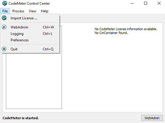

  4. After installation, the CodeMeter Control Center is installed and located in the taskbar.
  5. Import the licenses provided by Matrox using the application.

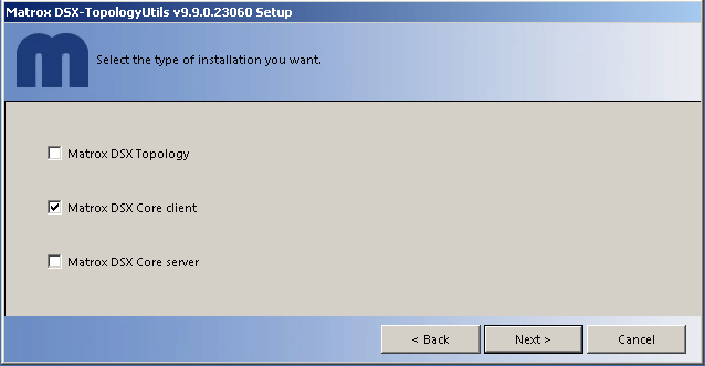

Steps for Installing the Client Machine
  1. Install DSX-TopologyUtils.exe application which usually ships with DSX.utils.exe.
Warning: DSX.utils.exe must be uninstalled first before installing DSX-TopologyUtils.exe!
  1. Choose Matrox DSX Core client during installation.

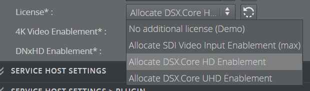

  2. The DSX core licenses need to be acquired by Channel Recorder. This can be either a HD or a UHD license.

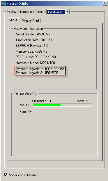

For recording, the board needs the upgrades UPG/100/U55 and UPG/RTP.

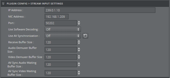

The most important parameters for receiving RTP/H264 streams are the IP Address, NIC Address and Port. The connector setting still needs to be specified. Any value without space will do.
Additionally the following needs to be taken into account:
  • Disable any firewall installed on the system or specifically allow each and every Channel Recorder service to be able to receive incoming RTP/H264 packets.
  • The multicast address and port must be already available before starting the service, otherwise Channel Recorder fails to start.
  • If no audio is present in the stream, the parameter Use AV Synchronization must be disabled.
  • The bitrate of the incoming stream must be below 20 Mbps.
  • The IP Encapsulation Mode of the incoming stream must be RTP. UDP is not supported.
  • Only AAC audio with two channels is supported.
  • Only H264 video is supported.
  • VBI is not supported.
  • Open GOP is not supported for M264 / HW decoding.
