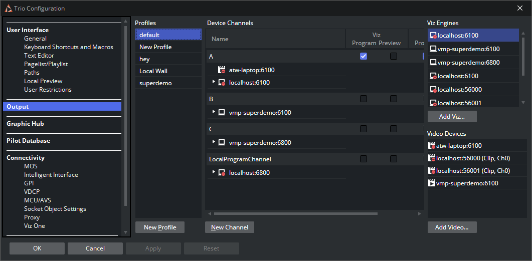

To view the Output configuration settings, click Output in the Viz Trio Configuration.
Output Configuration Settings
A key feature is the ability to create profiles for different purposes. For example, Profile Setups can be created where different channels have the program and preview function. This makes it fast and easy to switch between different output settings.
Profiles can be defined with different program and preview channels in the Output channels section. It is most common to define a studio with channels mapped to renderer machines (Viz Engine hosts).
Viz Trio supports four methods to resolve which channel is the local program channel. If an unsupported method is used, the Connection Status button does not appear in the Status Bar. Consequently, the operator isn't able to control the local program channel status.

Program and Preview Channels
Local preview is Viz Trio’s embedded render window in the lower right corner, which always shows the last page read. Local preview displays graphics as WYSIWYG (what you see is what you get) when editing a page. Text and images change immediately as text and images are added to the page. Select which elements to edit using point and click directly in the render window.
External preview (optional) is a separate Viz Engine renderer with its own reference monitor that displays a true preview. External preview shows how the program channel looks before a page is taken to air.
Program is a separate Viz Engine renderer that renders the content that is taken on-air.
Profile Setups
Profile
Program
Preview
Main
A (Viz 1)
B (Viz 2)
Backup
B (Viz 2)
Two-channel Setup
A typical profile setup is a two-channel setup, program and preview, with one render engine assigned to each channel. A more advanced setup is the use of forked execution. As the term suggests, forked execution is a way to configure a single output channel to contain multiple render engines.
Profiles are used to create different setups, for example in a backup configuration where a switch from a main renderer to a backup is needed. If two output renderers are named A and B, where A is program and B is preview, a profile named "Main" has channel A=program and channel B=preview.
If the renderer that is acting as program (A) in the "Main" profile fails, a profile named "Backup" could have channel B=Program.

Profile Configuration
To open Profile Configuration
  1. Click the Config button (upper left), and then select Output.
  2. Right-click the profile on the status bar (lower-left) and select Profile Configuration... from the menu.
To add a New Profile
  • In the Profile Configuration window, click New profile, enter a new unique profile name in the text field and press Enter.
To rename a Profile
  1. Right-click the profile and select Edit Profile Name or simply double-click the profile and enter a new name.
  2. When finished editing the name, press Enter or click outside the Profiles list.
To delete a Profile
  • Right-click the profile and select Delete Profile, or simply select it and press the Delete button.

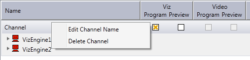

Channel Configuration
To add an output channel to the Channels List
  • Click New channel or drag and drop a Viz Engine or video device to the Channels list.
To rename an output channel in the Channels List
  • Right-click the channel and select Edit Channel Name from the menu or double-click the name.
To remove an output channel from the Channels List
  • Right-click the channel entry and select Delete channel from the menu or select the channel and press the Delete button.
To add an output device to the Channels List
  • Simply drag and drop a Viz Engine or video device onto the channel in the Channels list, or select it and select Add to profile (for creating a new channel) or Add to selected channel from the menu.
To remove an output device from the Channels List
  • Right-click the Viz Engine or video device and select Delete Output from the menu or simply select it and press Delete.

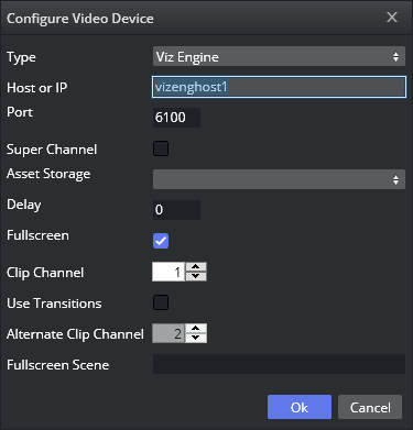

To add a video device
  1. Click the Add Video... button in the Profile Setups window to open the Configure Video Device dialog box.
  2. Select the video server Type.
  3. Type the Host or IP address.
  4. Enter the Port number (optional).
  5. Select whether the video device is a regular or controlled through a Viz Artist Super Channel plugin.
  6. Set a delay (optional).
  7. Select a publishing point from the Asset Storage list, so that stand-alone clips and clips used in pages or data elements are transferred to the right location (the specified Viz Engine) for playout.
  8. If the Fullscreen check box is selected, you can define additional values (Use Transitions and Fullscreen Scene) in order to provide transition effects from one video to another.
Info: The fullscreen values are only available for Viz Engines, not MVCP video devices.
Info: Viz Trio by default sets the Fullscreen Scene in Media Sequencer to Vizrt/System/transitions when you switch on Use Transitions. Using this default, clip channel must be 1 and the alternate clip channel must be 2. Only when using other transition scenes can these settings be changed.
  1. Select the Clip Channel to use.
Info: Viz Engine from 3.6 support up to 16 clip channels which can be used for playout. A clip channel might be unavailable for various reasons: for example, if it's configured to be inactive in Viz Config or if the license only covers a limited number of clip channels.
  1. Alternate Clip Channel: When using videoclip transitions the clip from Clip Channel transitions to the clip from Alternate Clip Channel and the next clip transitions from Alternate Clip Channel back to the Clip Channel. The transition clip channel is only enabled in the configuration window if Use Transitions is enabled.
  2. Click OK. A status indicator shows if the video device is online.
Info: Media Sequencer (MSE) up to and including version 2.0.0 imposes the following limitations: Clip channels 3-16 are not supported when using fullscreen clips. Clip channels 2-16 are not supported when using transitions. Using the alternate clip channel setting is not supported. These restrictions are lifted starting with Media Sequencer version 2.0.1 and higher.
Tip: You can use the default profile to transfer video from Vizrt’s MAM systems (unless you have manually configured a profile in both systems).
