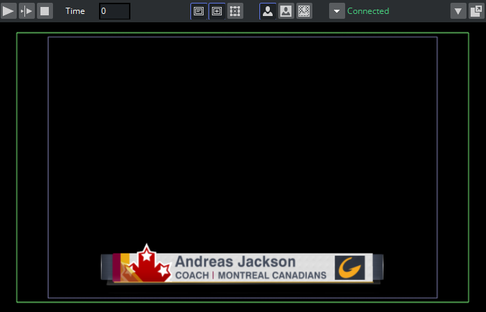

Real-time Rendering of Graphics and Video
The local Preview window displays a representation of the graphics and video.
  • The defined title and safe area and bounding boxes are displayed. Bounding boxes are related to the graphics scene’s editable elements (see Tab Fields Window).
  • Timeline for scrubbing full screen video preview.
  • Control interactive scenes by clicking the scene inside the local preview window. You can then adjust an offside line in Viz Trio’s local preview by reading a template referencing an interactive scene, for example.

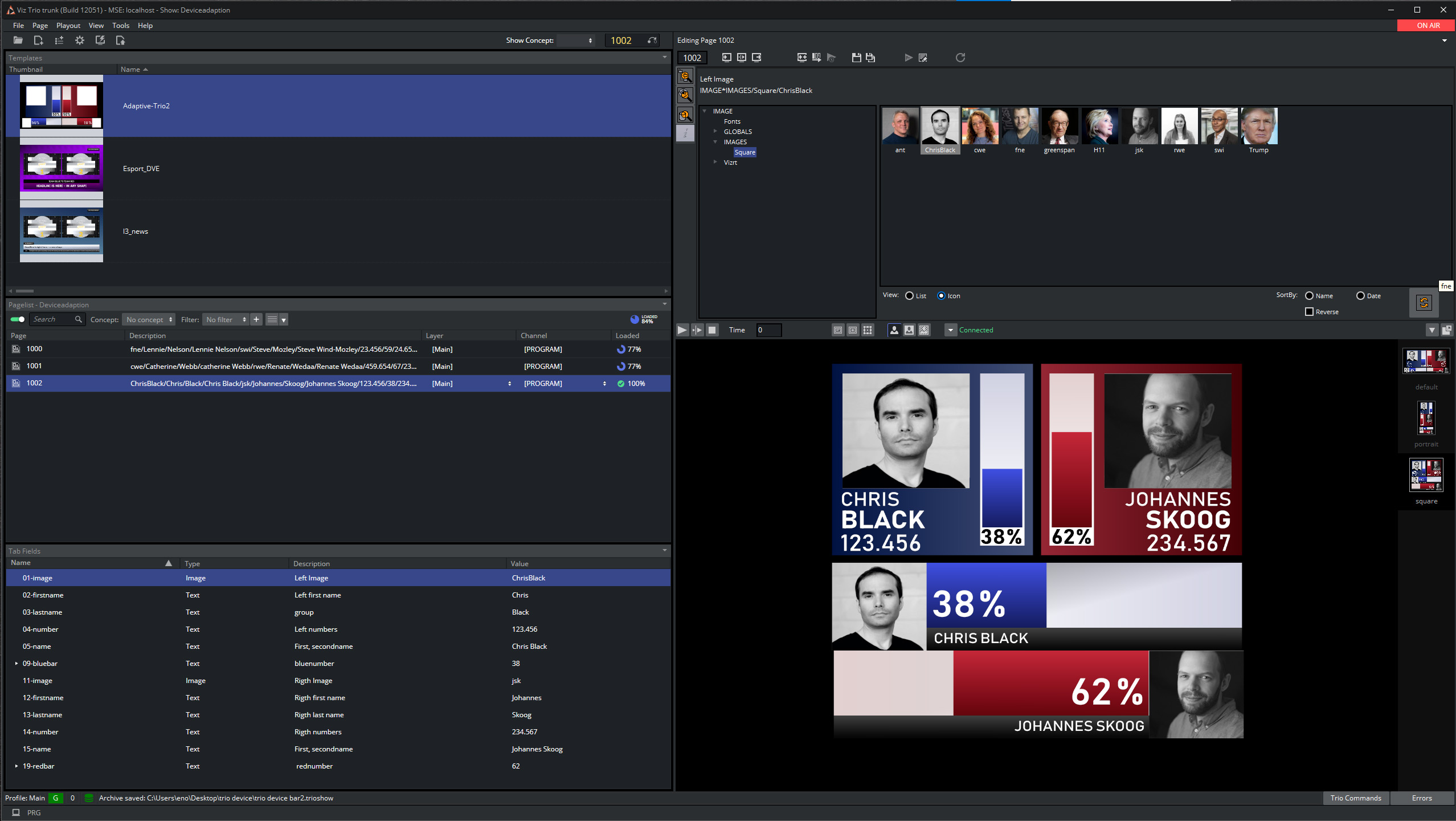

Adaptive Storytelling
The adaptive storytelling allows you to preview scenes with different formats that were previously set in Viz Artist when designing the scene.
Info: Adaptive Storytelling can only be used with scenes based on the Viz Engine renderer, and not the Classic renderer.
When working with adaptive formats, it is recommended that the naming convention used across all Viz products and scenes is consistent, for instance portrait and square.

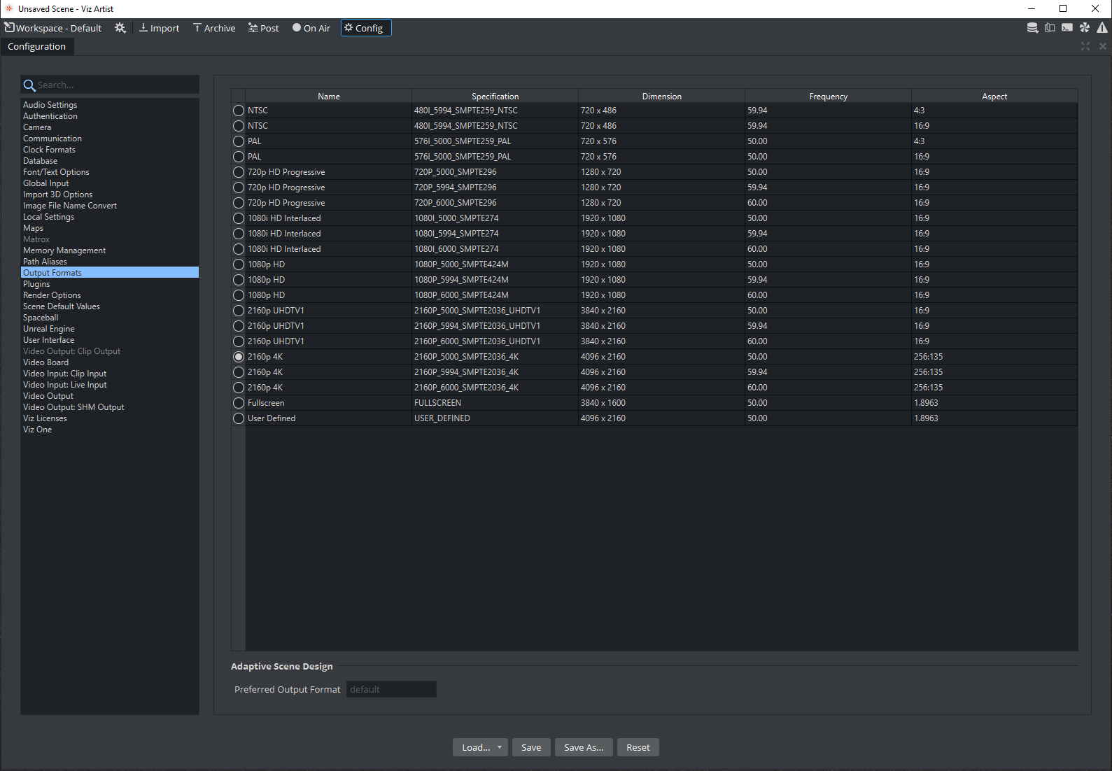

Before importing a scene in Viz Trio, setting the adaptive format for the output engines can be done directly in the user interface of Viz Artist or in Viz Engine.
To set it in Viz Artist, open Configuration and select the Output Formats to set the Preferred Output Format:
To set the adaptive format in Viz Engine, please see the Output Format in the Viz Engine Administration Guide.
Warning: All engines used for preview and playout must have a Flexbox license.

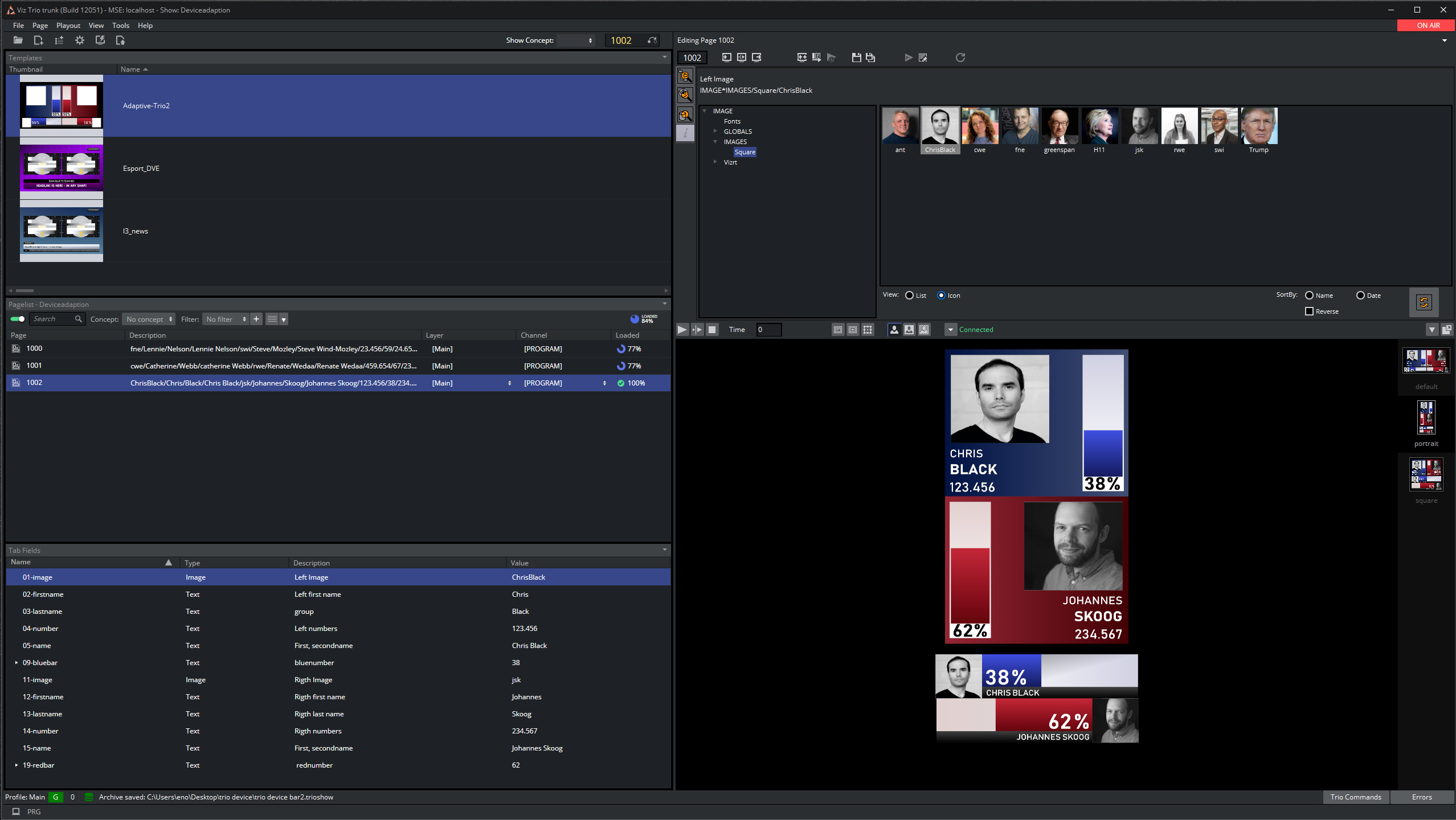

After setting the config file, open Viz Trio and import a scene. The watermark for the preview versions is shown, and the different formats for this scene are listed as thumbnails to the right of the preview.
In the examples above, you can see the preview of the default, portrait and square formats.
To switch between previews of the different formats, either click the thumbnails to the right of the preview, or use the Viz Trio macros.

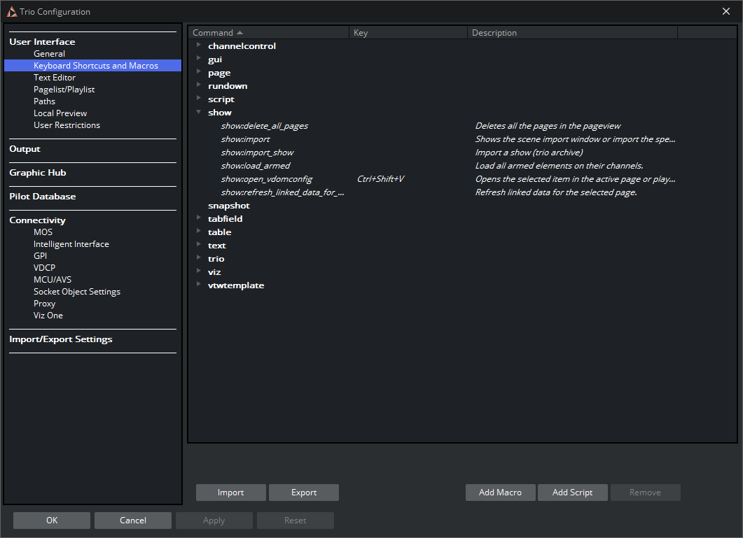

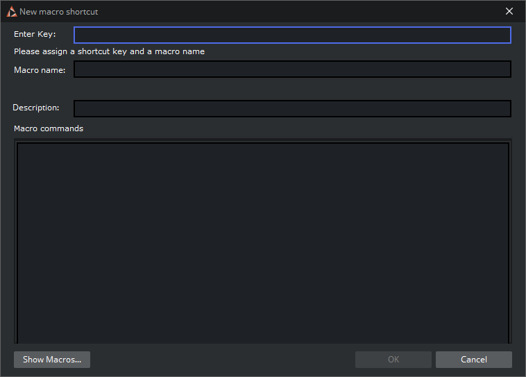

For each adaptive format, you can set different macros. Open the Viz Trio configuration, select Keyboard Shortcuts and Macros and click Add Macro:
  • Enter Key: Combination of keys for the macro, for example SHIFT+5.
  • Macro name: Name of the macro.
  • Description: Small description of the macro.
  • Macro commands: Set of commands to be executed.
Note: The macros available are set_format, set_next_format and set_previous_format.
For more information, please check the Macro Commands section.

Floating or Moving the Preview Window
Use the Floating preview button at the upper right corner of the preview window pane to un-dock the preview window.
  • If the preview window is docked (attached) to the Viz Trio main window, clicking the pin-button detaches the Preview window.
  • If the preview-window is un-docked from the main Viz Trio window, clicking the pin-button docks the preview window to the main Viz Trio window.
Graphics Control Buttons
At the top of the preview window:
  • Play: Starts the scene animation currently loaded in the local preview.
  • Continue: Continues the scene animation currently loaded if it contains stop points.
  • Stop: Stops the scene animation.
  • Time Slider: Lets you scrub the timeline by holding in and moving your cursor in the value field. The cursor changes to an arrow to indicate that the time value can be changed.
The middle section of the toolbar:
  • Show or hide the Title Area in the Preview window.
  • Show or hide the Safe Area in the Preview window.
  • Show or hide the Bounding Box for the tab field currently selected in the Preview window.

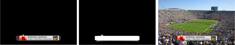

Preview Modes RGB, Key and RGB with Background Image
The three buttons can be used to see the previewed graphics in three different modes.
  • The left button displays the graphics in an RGB mode with a default background color (black).
  • The middle button displays the graphics in Key mode, showing how the key signal looks like.
  • The right button displays an RGB preview with a background image, illustrating how the graphics appear on top of a video.
The respective preview modes are shown below:
