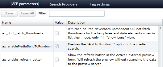

Database Parameters
In the VCP Parameters tab the user can configure settings for the Viz Pilot system’s applications. A description of useful database parameters is listed here.
To give applications access to the Pilot Data Server
To give applications access to the Preview Server
To give applications access to the Update Service
To set the Database Parameters for the Crop Service
To enable the built-in Object Store search
To configure Order Management
Click the Settings link
Select the app_server setting, and add the parameter for the machine you installed the Pilot Data Server on (i.e. <DataServer>:8177)
Click Save
This will give all applications with a connection to the database access to the Pilot Data Server.

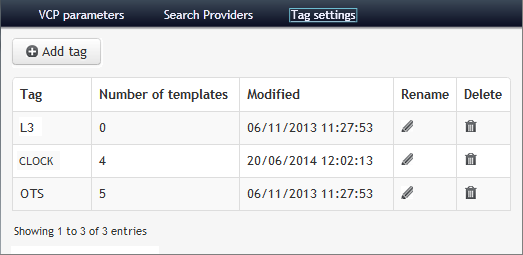

Tag Settings
The Tag Settings page is used for administering tags. The tags are assigned to templates in Template Wizard, and then used in Viz Pilot News to organize templates.
To access the Tag settings
See how To access the Pilot Data Server Web Interface
Click the Tag settings link
Tag Settings functions
Function |
Description |
Add tag |
Click the Add Tag button and enter a name for the new tag. |
Click the Rename icon to rename the selected tag |
Click the Delete icon to delete the selected tag. Note: Deleting a tag will not delete the templates that refer to that tag. |
