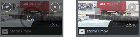

  • Turn Looping ON or OFF .
Note: You cannot change the looping setting once the clip is playing. Take out the clip to stop looping.

A thumbnail indicates that the element is still loading:

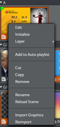

Shortcut Menu in the Media Column
Right-click elements (videos, images and graphics) in channels in the Media Column to open the menu:
  • Initialize: Loads the resources of this element into the memory of the renderer. Initialize is available for images and graphics and ensures instant Take playout.
Important: Initialize may disrupt animations or clips playing on the renderer. It is recommended to initialize before the broadcast starts, or when there is low activity on the renderer.
The colored triangle in the top left corner of the element shows whether the resources are loaded on the renderer. Green is loaded, yellow is loading, and gray is unloaded.
Note: If the element is not loaded, there may be a delay before the renderer plays the graphics when a Take is executed.
  • Layer (non-GFX channels only): Set the Viz layer (FRONT, MAIN or BACK).
  • Add to Auto-playlist: Only media elements from the same group can be included on an Auto-playlist.
  • Reload Scene: From Graphic Hub.
Note: Reload Scene is only visible when right-clicking graphics in the media, armed and program columns. See Reload Scene.
  • Import Graphics: Import graphics directly from Graphic Hub into the channel.
  • Reimport (only for graphics): Reimport the graphics from Graphic Hub. Does not affect the renderer. Useful if the scene designer has added or removed control fields.

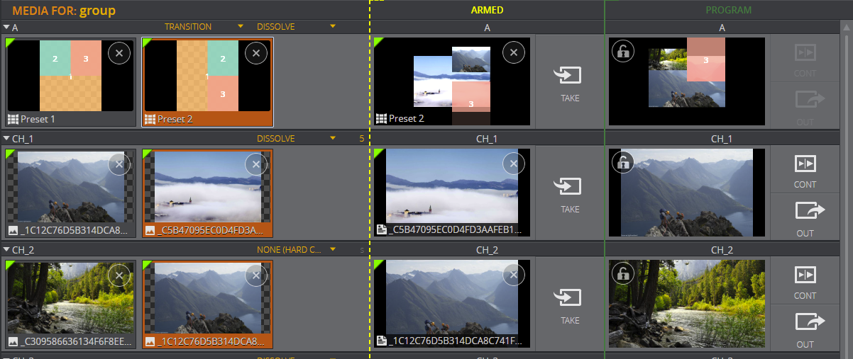

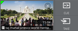

Armed
When armed in Arm and Fire video wall configuration, elements get prepared on Viz Engine for playout. The green triangle shows that the renderer is ready and the element can be played out instantly.
In legacy video wall configurations only clips are prepared on Viz Engine.
The following actions are available in the Armed column:
  • Click an element to take it to Program.
  • Click the TAKE button to take the element to Program.
  • Click the CUE button (enable this in Settings) to send the element to Program in the first frame in the renderer ready to be played out.
  • Click the CONTINUE button (enable this in Settings) to continue the graphics or video on the external preview engine. Only available if external preview is used.
  • Click the SWAP button (enable this in Settings) to swap the content in the Armed column and the Program column.
  • Drag an element to Armed or Program in another channel to make a copy there (this does not affect or take the original armed element).
  • Take All: Send all armed elements, for all channels, to Program.
  • Cue All: Send all armed elements, for all channels, to Program in the first frame in the renderer ready to be played out.
  • Swap All: Swap all elements in the armed column with the elements in the Program column.
  • See the Looping status of the video.
Note: The looping setting cannot be changed in the Armed column. Use the looping button in the Media column.
  • Remove an element from the Armed column by clicking X.
Video wall main channel:
In Arm and Fire configuration, if a preset is armed on the main channel ("A") the preset thumbnail will show every armed element on that video wall. Clicking TAKE on the main channel in this case will play out all armed element on this video wall.

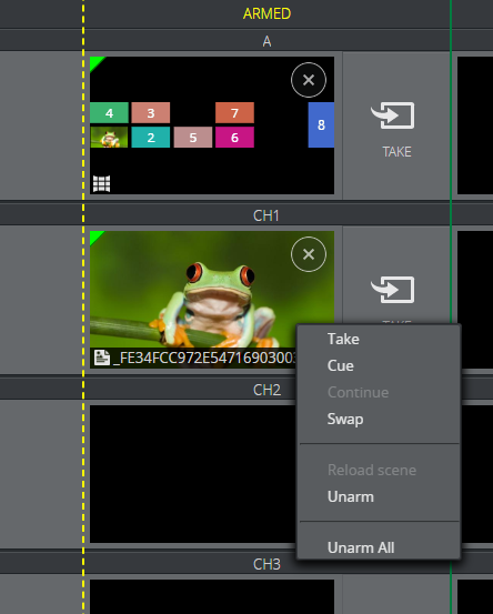

Armed Shortcut Menu
  • Take: Takes the Armed element to Program.
  • Cue: Sends the element to Program in the first frame.
  • Continue: Continues on the external Preview renderer. Only enabled if an external preview is configured for a video wall.
  • Swap: Swaps the content in the Armed column and the Program column.
  • Reload scene: Shows the new updated scene.
  • Unarm: Removes element from Armed.
  • Unarm All: Removes all elements from Armed.

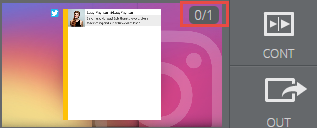

Visualizing Stop Points
If a graphics imported with Viz Multiplay in the GFX playlist has stop points, this is visualized in the Program column on the thumbnail:
The number indicates the current stop points and how many stop points the graphics has.

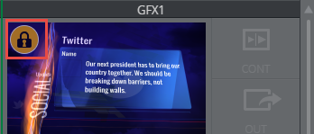

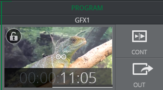

Locking a Channel
Each Program channel has a lock symbol (enabled in settings) to hinder any changes being made to it.
You can lock a channel if its content is to stay on air, Viz Multiplay blocks most operations that would change the output on Program. An example use case can be to lock some channels, and click Continue All, only the unlocked channels receive the Continue command.
Note: Commands executed on the Shortcut row, ignore Channel locks.
Note: Locking Channels is a Viz Multiplay concept. No other playout client adheres the setting.

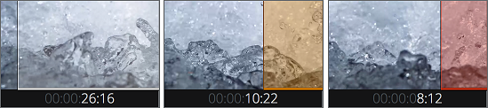

Time Remaining
The time remaining for a clip is indicated with a gray progress bar. Orange shading indicates <20 seconds remaining, and red indicates <10 seconds remaining. Only the gray progress bar is shown on looping clips.

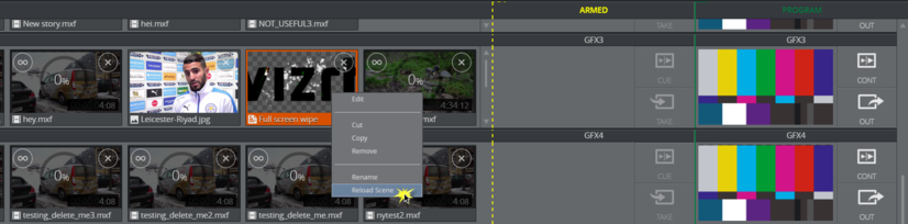

Reload Scene
Update On Air graphics with the reload scene option. This feature is useful when changing scenes on the fly in Viz Artist and quickly taking them to air.
Activating Reload Scene

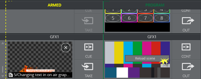

Right-click a graphic in the media pane (shown below) or in the armed or program columns.
Using Reload Scene
A graphic is showing live on a video wall. As the graphic is in use, a scene designer changes it in Viz Artist.
Bring the changes to air:
  1. Send a graphic to air in the program column.
  2. The scene, which is now in use on a video wall, is opened in Viz Artist and changed by a scene designer. The new scene is saved in Graphic Hub.
  3. Right-click the graphic in the program column of the channel where the graphic is playing out and click Reload Scene to show the new, updated scene.
