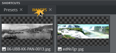

You can have multiple tabs of shortcuts to make it easy to access items that are used frequently, independent of which story you are working on. Each group in the Shortcuts bar playlist appears as a tab in the Shortcuts bar. The shortcuts are specific to a show so that when you change your show you can have different shortcuts for different productions.

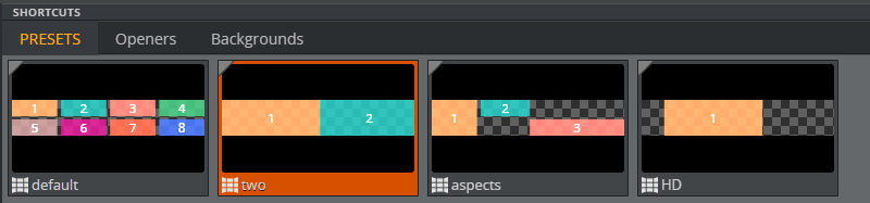

  • Presets: Presets define the layout of the channels on a video wall. When a new preset is taken to air, it triggers a transition from the current layout to the new layout. New presets are created using the Designing Video Walls.
  • Filled Presets: A Filled Preset is a preset which also includes content. When a filled preset is taken to air, it populates the preset with content and plays out everything at once. Presets are filled with content using the preset content editor.

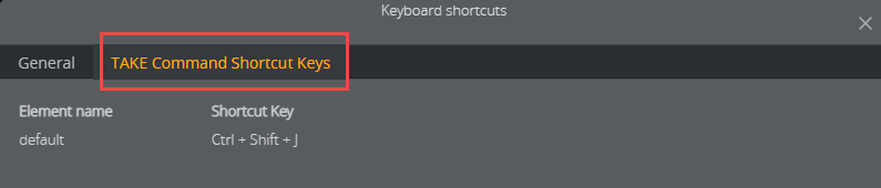

Click the Shortcuts button on the toolbar to see an overview of keyboard shortcuts in this show.
The TAKE Command Shortcut Keys tab displays a list of assigned keyboard shortcuts in this show:

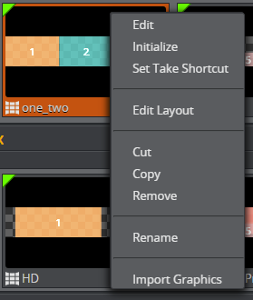

Shortcut Menu for Presets
Right-click a preset in the Shortcuts Bar to expose the following context menu:
  • Edit: Open the Preset Content Editor.
  • Initialize: Load the preset scene on the renderer.
  • Set Take Shortcut: Set a keyboard shortcut for taking this preset.
  • Edit Layout: Opens the Preset Layout Editor.
  • Cut: Cut a preset and paste it in another tab/column.
  • Copy: Copy a preset and paste it in another tab/column.
  • Paste: Paste an element previously copied or cut.
  • Remove: Remove the preset from the Shortcuts Bar.
  • Rename: Rename the preset.
  • Import graphics: Import graphics from the Graphic Hub directly into this group.

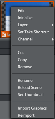

Shortcut Menu for Elements
Right-click an element (graphics, images or clips) in the Shortcuts bar to expose the following context menu:
  • Edit: Open the corresponding element editor.
  • Initialize: Load the resources for this element into the renderer. Should be used with care. It may affect renderer performance.
  • Layer: Change the Viz Engine layer (BACK, MAIN, FRONT). See Layers.
  • Set Take Shortcut: Set a keyboard shortcut for taking this element.
  • Channel: Change the playout channel of the element
  • Cut: Cut a shortcut element.
  • Copy: Copy a shortcut element.
  • Paste: Paste a playlist element.
  • Remove: Remove the element from the Shortcuts bar and delete it.
  • Rename: Rename the element.
  • Reload Scene (only for graphics): Makes the renderer reload the scene from the Graphic Hub.
  • Set Thumbnail: Set a custom thumbnail for the element.
  • Reimport (only for graphics): Re-import the graphics from the Graphic Hub. Does not affect the renderer. Useful if the scene designer has added or removed control fields.

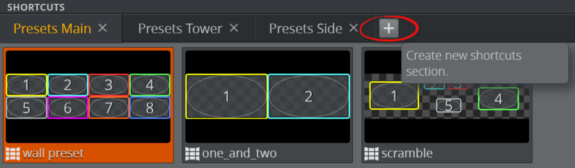

Adding a Shortcuts Group
Add a group to the playlist you have chosen to appear in the shortcuts bar. Groups created via the shortcuts bar appear in the show pane when no shortcut playlist is set.
  1. Click the Add (+) button in the Shortcuts Bar.
  2. Give the new group a title.
  3. Click OK.

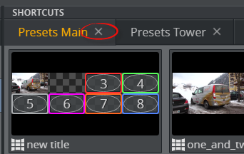

Deleting a Group from the Shortcuts Bar
Delete playlist groups from the shortcuts bar.
  1. Click the close button in the top right corner of the shortcut group tab.
  2. Click Yes.
