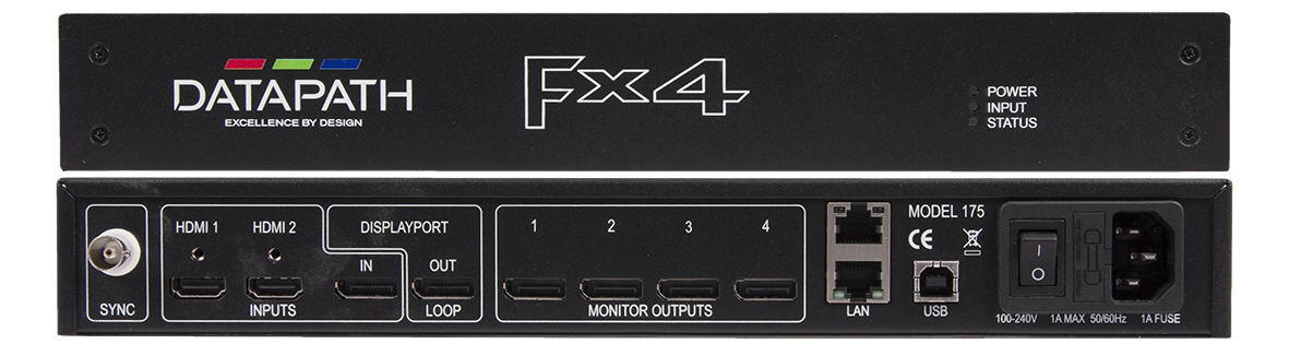

Viz Multiplay integrates with the Datapath Fx4 MultiDisplay Controller:
Image is not available
