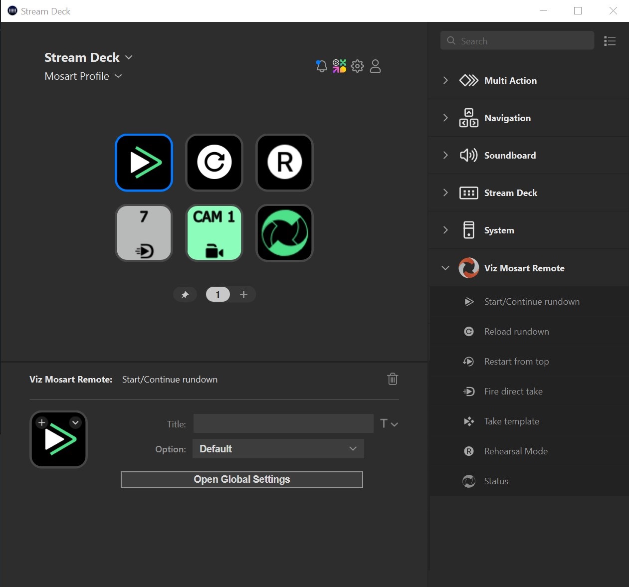

  1. Drag the Start/Continue rundown to any free Stream Deck key.
  2. Click Open Global Settings to configure the plugin.
  3. In field Mosart Url, enter the URL of the hostname of where your Mosart Web Applications are installed (failover is supported).
    This Mosart Web applications proxy web server must be prefixed with http:// and suffixed with port number :55142, or prefixed with https:// and suffixed with port number :55143. See the screenshot for an example.
