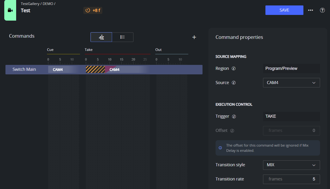

Switch Main
The Switch Main command sets the source on the main output (Program/Preview) of the switcher. This can be a direct source like a camera, graphic, or video feed (for example, CAM1), or a secondary region (for example, ME1) that is being composed elsewhere.
Properties
  • Region: Program/Preview (the main output). This can not be changed.
  • Source: The desired source (e.g., CAM1). Default: the first command in the list.
  • Trigger: Specifies where the command is executed. This can not be changed. The command transitions the selected source on the main output from Preview (B) to Program (A) when the template is taken on air. In the Properties on the command on TAKE is visualized, but in the Timeline view, both the commands on CUE and on TAKE are visualized.
  • Offset: Optional delay in frames. Ignored when Mix Delay is enabled; instead, the Mix Delay applies a unified offset to this and other commands. Default: 0 frames.
  • Transition: CUT, MIX WIPE or EFFECT. CUT is in fact a MIX with transition rate 0 frames. Default: CUT
  • Transition rate: MIX and WIPE support optional transition rate (in frames). Default: 0 frames.

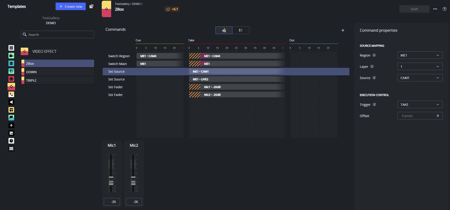

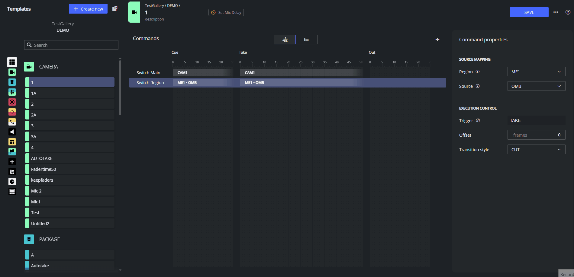

Switch Region
Switches a source to the background of another mixer region (for example, ME1, ME2) different from the main output (PP). This allows for switching sources in parallel with the main output - typically used in compositions, picture-in-picture, or secondary outputs.
Command properties
  • Region: ME1, ME2, etc.
  • Layer: 1, 2, 3 etc.
  • Source: The desired source (for example, CAM1). Default: The first command in the list.
  • Trigger: Specifies where the command is executed. This cannot be changed. The command transitions the selected source on the mixer region from Preview (B) to Program (A) when the template is taken on air.
    In the command Properties view only the TAKE command is shown, but in the Timeline view, both the commands on CUE and on TAKE are visualized.
  • Transition: CUT, MIX WIPE or EFFECT. CUT is in fact a MIX with transition rate 0 frames. Default: CUT.
Info: Limitations with current version
  • A maximum of two switch commands are supported in a single template execution
    • one for PP (main) and
    • one for a secondary region (for example, ME1).
  • Only one non-main region (ME1, ME2, etc.) can be used for Switch Region.
  • Shared transition and offset: Both Switch Main and Switch Region commands in a template will use the same transition type and same offset.

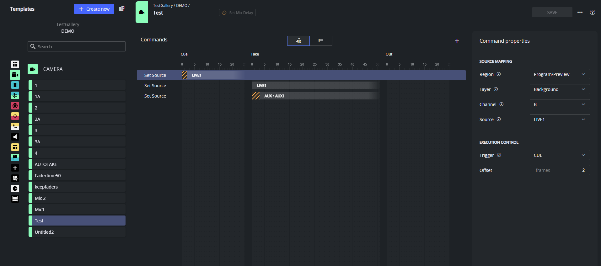

Set Source
The Set Source command is used to assign a specific source to a single-bus layer, typically used for keyers, picture-in-picture, video walls, auxiliaries or other compositional elements within a production scene.
Unlike Switch Main or Switch Region, which operate on background layers and typically trigger a transition (for example, Mix, Cut), Set Source is used for direct source assignments that do not involve transitions.
Command properties
  • Region: Specifies the mixer region where the source should be applied. For example, Program/Preview (PP), ME1, ME2, Auxiliary, etc.
  • Layer: Indicates the layer within the selected region. Can be Background (except when Region is set to Auxiliary) or a numbered layer (for example, Layer 1, Layer 2, etc.).
  • Channel: Defines the channel to assign the source to, A or B. This is only applicable when the Layer is set to Background.
  • Source: The source to be assigned (for example, CAM1, LIVE1). If left empty, the first available source in the drop-down list is used by default.
  • Trigger: Specifies when the command should be executed, on CUE, TAKE, or OUT.
  • Offset: An optional delay (in frames) before the command is executed. In this version, the Offset property can only be applied if the Trigger is set to CUE.
Info: The Mix Delay setting (defined at the template level) applies to the Set Source command only if:
  • the Layer is set to Background, and
  • the Trigger is set to TAKE.

  • Assigning keyers for a 2Box composition.
    This template uses two Set Source commands to assign video sources to different keyer layers on the ME1 region.
    • The first command maps CAM1 to Layer 1, used as the left video box.
    • The second command maps LIVE2 to Layer 2, used as the right video box.
      This setup is commonly used in 2Box or split screen layouts, where two speakers or feeds need to be shown side by side, with the ME handling the composition.
  • Taking multiple sources simultaneously
    This template prepares and takes multiple sources simultaneously: It sets LIVE1 to preview (channel B) of ME2 on cue, then switches LIVE1 to program (channel A) of ME2 and routes Aux1 to an auxiliary layer when the template is taken.

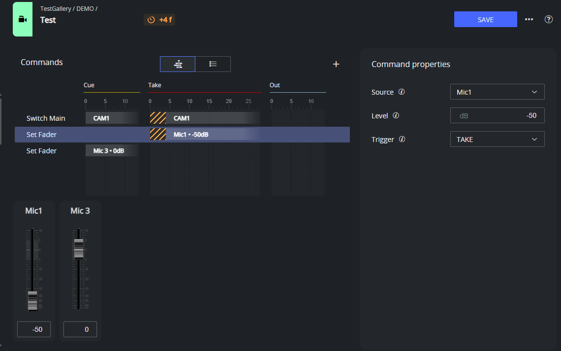

Set Fader
The Set Fader command is used to adjust the audio level of a specific source at a defined point in the template timeline.
Command properties
  • Source: The audio input to be controlled (e.g., Mic1, Mic2, etc.) as configured on the Viz Mosart server in AV Automation in the menu
    Devices > A/V Setup > Audio Config.
  • Level: The target audio level in decibels (dB). Typical range is from 0 dB (max) down to -90 dB (silent).
  • Trigger: Defines when the fader level should be applied: on CUE or TAKE.
Info: The Mix Delay setting (defined at the template level) applies to the Set Fader command only if the command is executed on TAKE.

Mix Delay introduces a shared delay (in frames) applied to eligible commands when the template is taken on-air. It's useful when you want multiple commands delayed together, in a coordinated way.
In addition to a template’s Mix Delay, some commands also support their own Offset property, an individual delay in frames.
