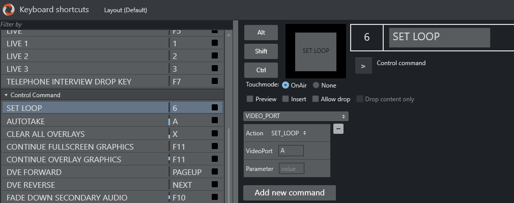

To be able to use the video port control commands, you need to add a set of shortcuts for each video port. You have to create a new set for each video port A, B, C etc. Here port A is used as an example.

  • PLAY_PAUSE: Viz Mosart begins to play the cued content. If the content is already playing, it pauses the content.
    • Empty Parameter: Toggle - PAUSE if playing and PLAY if paused.
    • Parameter: PLAY. Always tries to PLAY channel.
    • Parameter: PAUSE. Always tries to PAUSE channel.
  • STOP: Viz Mosart stops the cued content.
    • Parameter: CUE. Cues the channel after the stop.
  • CUE: Viz Mosart will CUE a clip on the port
    • Parameter: Clip name.
  • RECUE: Viz Mosart recues the port.
    • Parameter: PLAY. Viz Mosart plays the clip after the recue.
  • SET_LOOP: Viz Mosart sets the already cued clip to looping.
    • Parameter: OFF, RESET. Viz Mosart turns off looping.
    • Parameter: 12-444 (configurable). Viz Mosart sets looping from frame 12 to frame 444.
  • CUE_TAIL: Viz Mosart recues the cued clip at a specific time (in seconds).
    • Parameter: -15 (negative value) - configurable. Viz Mosart cues at the start of the last 15 seconds of the clip (the clip will have 15 seconds left to play plus Post roll).
    • Parameter: 15 (positive value) - configurable. Viz Mosart cues 15 seconds into the clip.
  • PLAY_TAIL: Viz Mosart recues and plays the cued clip at a specific time (in seconds).
    • Parameter: -15 (negative value) - configurable. Viz Mosart will cue at the start of the last 15 seconds of the clip.
    • Parameter: 15 (positive value) - configurable. Viz Mosart will cue 15 seconds into the clip.
