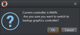

Graphics Controller
For graphics systems supporting graphics control switching, the graphics controller can be switched by clicking the Graphics Controller area.
