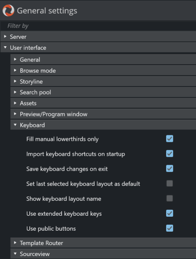

Each operational panel (for example Rundown, Shortcut keys, Story Script) can be displayed, resized or hidden, to suit your tasks and workflow. The behavior of Mosart and availability of production-critical UI features is customizable to a granular level.
These options are accessed from the GUI toolbar under Tools > General settings.
You can save your individual UI setup for later recall.

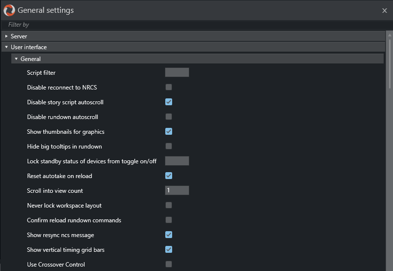

The following configuration options are presented:
General
  • Script filter: Filters script text. The format is 100,50 where the first number is the maximum length at the start, and the second number the maximum length at the end.
    Used to limit the size of the script text from the NRCS story in the UI.
  • Disable reconnect to NRCS: Disables the reconnecting functionality when clicking on NRCS status. When selected, the NRCS status stays as read-only.
  • Disable story script autoscroll: Disables the auto-scroll functionality in the story script. This functionality keeps the current item at the top of the Script window.
  • Disable rundown autoscroll: Disables the auto-scroll functionality in the rundown. This functionality keeps the view of the rundown in sync with the on-air story, and displays the current story line according to the value set in Scroll into view count
  • Show thumbnails for graphics: When selected, thumbnails are displayed for items in the Story Script, Rundown, and Asset tab.
    Thumbnails are also available for video clips from Viz One or Media Service, and for Vizrt graphics, when Viz Pilot Edge is configured with a Preview Server.
  • Hide big tooltips in rundown: When selected, there no big tooltip appears when you hover over an item in the rundown.
  • Lock standby status of devices from toggle on/off: A list of which devices should be locked from being manually toggled to standby status. Comma separated list (for example, Video server, audiomixer).
  • Reset autotake on reload: Defines the behavior of the autotake mode on Reload (Default SHIFT+F12). When selected, Viz Mosart reverts to normal mode on reload.
  • Scroll into view count: Defines how many storylines are auto scrolled into the UI rundown window when running a show.
    • will continuously keep one story above the current on-air story, visible (the previous story to the current).
    • will keep two story lines visible, above the current one.
  • Never lock workspace layout: When selected, it will always be possible to change the size of the panels in the UI workspace. If unselected, the workspace layout is locked while on-air.
  • Confirm reload rundown commands: When selected, a confirmation dialog menu is displayed whenever the operator issues a Reload Rundown command.
  • Show resync ncs message: When selected, a popup window asks for confirmation whenever a rundown is locked and then unlocked.
  • Show vertical timing grid bars: When selected, horizontal lines display to indicate time.
  • Use Crossover Control: When selected, the UI displays the status of the Viz Mosart crossover server.

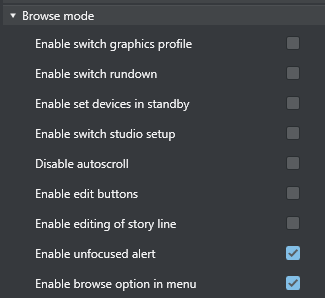

Browse Mode
The check boxes under Browse mode control various actions when a Viz Mosart UI is set in Browse mode. By default, most are unchecked, rendering the Browse mode UI safe for live situations.
  • Enable switch graphic profile: When enabled, it will be possible to change graphics profile while in Browse mode.
  • Enable switch rundown: Change rundown in Browse mode.
  • Enable set devices in standby: Change standby devices in Browse mode.
  • Enable switch studio setup: Change studio setup in Browse mode.
  • Disable autoscroll: Disables the autoscroll functionality in the rundown and in the script view in Browse mode.
  • Enable edit buttons: Use the edit buttons in Browse mode.
  • Enable editing of story line Edit story line in Browse mode.
  • Enable unfocused alert: When not enabled, the unfocused alert is not shown in browse mode when the application does not have focus.
  • Enable browse option in menu: Enables the appearance of the View > Browse mode menu item, and makes it possible to turn Browse mode off.

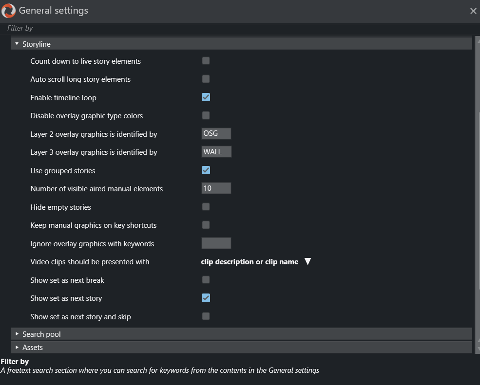

Story Line
Story line options control behavior and display characteristics of each story in the rundown.
  • Count down to live story elements: Enables countdown to stories containing either a LIVE, DVE or TELEPHONE template.
    See the topic Countdown to a Selected Story.
  • Auto scroll long story elements: When selected, long story items (with scrollbars) are automatically scrolled horizontally while the story item is played. Makes it easier to see when lower thirds appear.
  • Enable timeline loop: Enables the loop timeline context menu.
  • Disable overlay graphic type colors: Disables the use of Layer 2 and Layer 3 identification (otherwise, user sees “Layer 2 overlay graphics is identified by” and “Layer 3 overlay graphics is identified by).
  • Layer 2 overlay graphics is identified by: Overlay graphics connected with any Handler name input here is displayed in the secondary overlay graphics layer.
    For example, OSG
  • Layer 3 overlay graphics is identified by: Overlay graphics connected with any Handler name input here is displayed in the tertiary overlay graphics layer. For example, WALL
  • Use grouped stories: When selected, stories with the same prefix are displayed in story groups in the UI. All items within each story group are also displayed in the Asset window. Can also be used with Quick Access filters.
  • Number of visible aired manual elements: Number of manual elements already aired that should be visible in a story. Use -1 to show all. Default value is 10.
Note: Showing more than 10 elements in each story may cause performance issues.
  • Hide empty stories: When selected, stories without items are not shown in the rundown. They are reduced to one straight line.

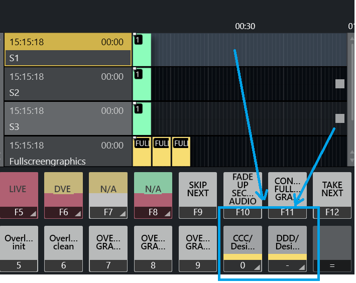

  • Keep manual graphics on key shortcuts: When checked, manual lowerthirds assigned to keyboard shortcuts will remain active until a new story with manual graphics is taken or selected.
    When unchecked, the graphics will be cleared immediately upon taking or selecting a different story with no manual lowerthirds.
    In the example below, two keyboard shortcuts were populated with the manual overlay graphics found in story S3. Then, story S1 was selected. Story S1 has no manual graphics, but the keyboard shortcuts retained the manual graphics from the previous story because Keep manual graphics on key shortcuts is enabled.
  • Ignore overlay graphics with keywords: Overlay graphics connected with any of the specified handler names are hidden in the UI. Can be used to remove fixed overlay graphics.
  • Video clips should be presented with: Select how you want video clips to be displayed to the user in the user interface, selecting from the drop-down list.
  • Show set as next break: When selected, Set As Next Break is available as an option in the rundown context menu. Selecting this option causes Viz Mosart to regard the selected storyline as a Break line for countdown and timing purposes.
  • Show set as next story: When selected, Set As Next Story is available as an option in the rundown context menu (using right-click). The user can jump to stories further up or further down in the rundown, independently of the NRCS running order.
    Default: On
  • Show set as next story and skip: When selected, the story line context menu option Set as next story (skip) is available.
    For example: The story on-air consists of three items, and the current item on air is number one of these three. Choosing Set as next story (skip) for another story in the rundown will then skip item 2 and 3 of the current on air story and set the first item of the chosen story in Preview. (Whereas selecting Set as next story keeps the remaining items in the on-air story as the following items to be played out, before the chosen story is set as next story). Default: Off

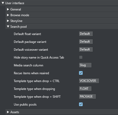

Search pool options affect the Search tab and Quick access tab in the Media Pool, usually displayed in the lower right corner.
  • Default float variant: The float variant that Viz Mosart adds to any video file found in the Search or Quick Access tab when dragged to the rundown, a shortcut key or the Favorites tab. See below for information on the drag and drop feature.
  • Default package variant: The package variant that Viz Mosart adds to any video file found in the Search or Quick Access tab when dragged to the rundown, a shortcut key or the Favorites tab. See below for information on the drag and drop feature.
  • Default voiceover variant: The voiceover variant that Viz Mosart adds to any video file found in the Search or Quick Access tab when dragged to the rundown, a shortcut key or the Favorites tab. See below for information on the drag and drop feature.
  • Hide story name in Quick Access Tab: When checked, The Quick Access tab shows the filtered items as a list without any story headers.

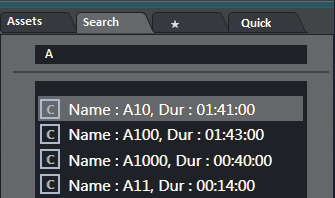

  • Media search column: Values entered here define the format of search results displayed when searching the video servers. Values can either be entered without name tags, in the format: slug, durationc or with name tags, in the format: "Name=slug, Dur=durationtc"
    This tells Viz Mosart to display results with Name:xxx (found in the slug column on the server database) and Dur:xxx (found in the Durationtc column on the server database).
    The resulting search window could look like this:
    Valid property fields: SLUG, DESCRIPTION, STATUSDESCRIPTION, RIGHTS, DURATION, STATUS, OBJID
  • Recue items when reaired: When checked, previously played video items dragged from the Assets and Favorites tabs into the rundown are recued.
  • Template type when drop + CTRL: Typing FLOAT, PACKAGE or VOICEOVER here defines which of the three types is connected to material dragged from the Search window when holding down the CTRL key.
  • Template type when dropping: Typing FLOAT, PACKAGE or VOICEOVER defines which of the three types is connected to material dragged from the Search window without holding down a key.
  • Template type when drop + SHIFT: Typing FLOAT, PACKAGE or VOICEOVER defines which of the three types is connected to material dragged from the Search window when holding down the SHIFT key.
  • Use public pools: When checked, manually updated Favorites Pool tabs are shared between GUIs connected to the same server. A shared Favorites tab is indicated by a small symbol in the top right hand corner of the tab.

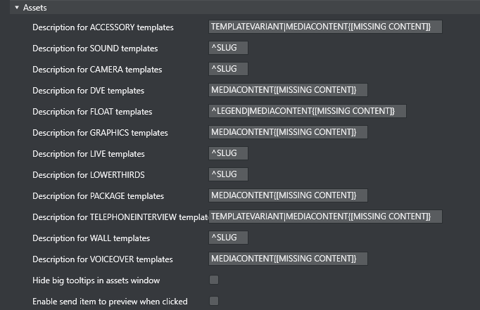

Asset options are options regarding the asset tab in the Media pool usually located in the lower right corner.
  • Description for ____ templates: Entering a legend syntax description in this field defines the format displayed for assets in the Assets Tab, in the same way as with the Media search column. The syntax for defining the legend is shown in the Asset Legend Syntax section below.
    Valid parameters are listed in the Assets Properties list further down. The legends used in Asset window are customizable for all Viz Mosart template types shown in the table above.
    Legends for other template types are shown using the corresponding slug.
  • Hide big tooltips in assets window: Normally when you hover over an item in the Asset window, a big tooltip appears with the full details of the item. If this is not wanted, the tooltip can be disabled by checking this box.
  • Enable send item to preview when clicked: If selected, clicking on a primary item in the Asset window immediately sends it to preview (it is inserted as the next item in the story currently on-air).
Info: If an item was unintentionally sent to preview in this way, this can be undone with Skip Next (default F9)

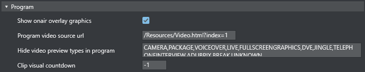

Preview/Program Window
Program
  • Show onair overlay graphics: When selected, overlay graphics are displayed in the Program window when they go on air.
  • Program video source url: Specifies which source to use for the Program video feed. Can be an HTML page or NDI source URL. Keep empty if not to be used.
  • Hide video preview types in program: List of template types that should not display the preview video. Only applicable when producing with NDI video streams. Default: All available types.
  • Clip visual countdown: If this has a value above 0, the countdown of PACKAGE and VOICEOVER change color to alert the user if the countdown reaches this value.
    See also: Timing Information and Countdown of Video Wall Elements.

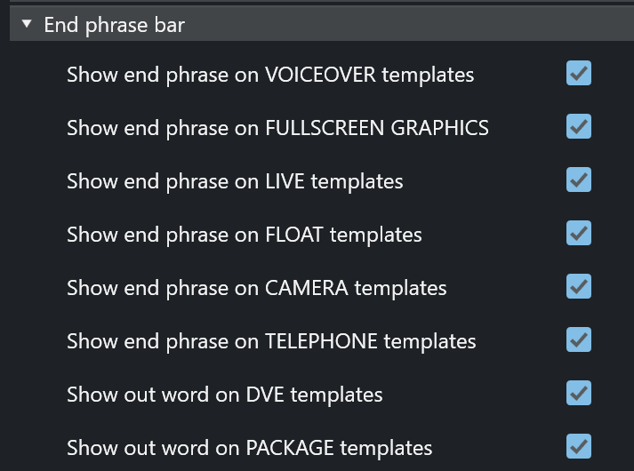

End Phrase Bar
Also called out words, these configurations enable the user to define which Viz Mosart types should have Last Words functionality.
When selected, the last words in the NRCS script (or the last words defined through a command in the script, depending on NRCS and Viz Mosart type) are displayed in a black box in the UI Program window.
  • Show end phrase on VOICEOVER templates: When selected, the last words in the script of VOICEOVER templates are displayed in a black box in the UI Program window.
  • Show end phrase on FULLSCREEN GRAPHICS: When selected, the last words in the script of full-screen graphics templates are displayed in a black box in the UI Program window.
  • Show end phrase on LIVE templates: When selected, the last words in the script of LIVE templates are displayed in a black box in the UI Program window.
  • Show end phrase on FLOAT templates: When selected, the last words in the script of FLOAT templates are displayed in a black box in the UI Program window.
  • Show end phrase on CAMERA templates: When selected, the last words in the script of CAMERA templates are displayed in a black box in the UI Program window.
  • Show end phrase on TELEPHONE templates: When selected, the last words in the script of TELEPHONE templates are displayed in a black box in the UI Program window.
  • Show out word on DVE templates: When selected, the last words in the script of DVE templates are displayed in a black box in the UI Program window.
  • Show out word on PACKAGE templates: When selected, the last words in the script of PACKAGE templates are displayed in a black box in the UI Program window.

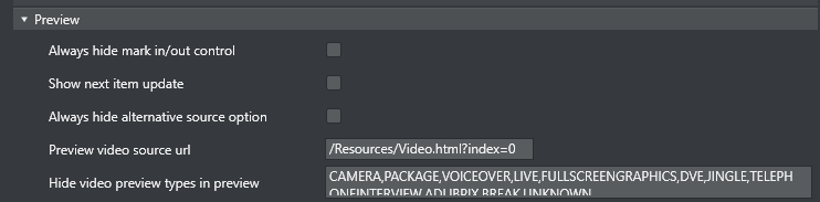

Preview
  • Always hide mark in/out control: Hides the mark in/mark out selector that is displayed when a clip is in Preview (If unchecked, these selectors will be shown when a clip is in Preview, otherwise not).
  • Show next item update: When selected, a warning is displayed in the Preview window if the story in preview is updated from the NRCS.
  • Always hide alternative source option: Hides the drop-down menu at the top of template previews in Preview (and Program). Selecting this option only displays the source.
    This menu is only visible with a DVE template that contains newsroom tags for keyers or similar. Unselected, this option offers for example, changing the content of the boxes of a 2-Box.
  • Preview video source url: Specifies which source to use for the Preview video feed. Can be an HTML page or NDI source URL. Keep unselected if not to be used.
  • Hide video preview types in preview: List of template types that should not display the Preview video. Only applicable when producing with NDI video streams. Default: All available types.
Keyboard
  • Fill manual lowerthirds only: When selected, only NRCS-bound lower thirds fill keyboard shortcuts with manual lower third. When unchecked, all lower thirds fill any keyboard lower third.
  • Import keyboard shortcuts on startup: When selected, the UI attempts import of keyboard settings from the server every time the UI restarts.
    • To export a keyboard settings file to the server, select LAYOUT - EXPORT in the keyboard shortcuts window.
  • Save keyboard changes on exit: When selected, all changes to the keyboard layout (for example, unassigned keys) are saved on exit.
  • Set last selected keyboard layout as default: When selected, the last used keyboard layout opens the next time the UI is started.
  • Show keyboard layout name: When selected, the currently selected keyboard layout name is displayed in the menu bar at the top of the Keyboard shortcuts window of the UI.
  • Use extended keyboard keys: When selected, some special keys like Enter/Return are treated differently. The extended variant is shown with an asterisk (*) in the keyboard editor.
  • Use public buttons: When selected, manually updated shortcut buttons are shared between all UIs connected to the same server. A shared button is indicated by a small symbol
    in the top right-hand corner of the button (see Button Details in the section Keyboard Shortcuts).

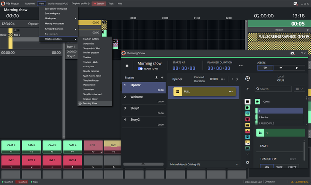

HTML Windows
This section enables you to configure any number of webpages to be used as controls/monitor in the main window,
or as a Floating window:
  • Window name: Arbitrary name to identify the view.
  • URL: Address to target view.
